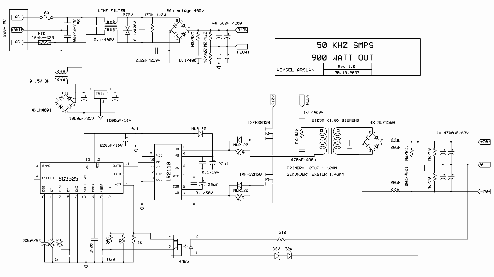

Hi everyone
I´m new in the world of smps and i wanted to make one for my new irs-d900 project from ratmayor but as i don´t know much about smps, i wanted to know if this schematic was good, or if not, i would like other schematic because i see a lot of them but i´m afraid of make one wich is bad.
How much capacitance will be after it?
You may want PFC ahead of the primary rectification?
Also I would be tempted to iec filter and mov the 15v supply gives the ic will put gate switching noise on the lines.
Typically after 500-kW you’re looking at full bridge. Active rectification may help reduce power losses too.
