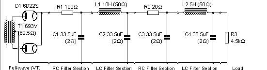

Okay here is a good design:
Sowter M057, 780vCT 400mA (These are DC values)
6CJ3 Full-wave CT Rectification.
C1 16uF, Parallel 8uF Motorstart 933vDC simple capacitor filter.
Now, C2 comes off this choke:
Hammond 193Q at 10H, 1000v DC Max, 500mA DC Max to filter to ground.
C2 33.5uF combination of 8uF caps and 17.5uF caps in ser/par for a min voltage of 933vDC.
C3 is a simple Resistor filter with the shown combination up-to 33.5uF so I can nudge the voltage in the right direction with nothing but a resistor change.
Inbetween here a
The load is represented as 900v 200mA, so 1.8k ohm.
Now, Sowter say that they have provided the full-load voltage rating of the transformer, this means that the voltage will increase as current is pulled back.
If I am going to get a 400mA transformer and only draw 200mA from it, surely the voltage will increase.
I will simply decrease the voltage as necessary via the decoupling resistor and a bleeder resistor.
decoupling resistor = 50 ohm for starters.
bleeder = 50k ohm, 25 watt

Er, 660VCT with a FWCT rectifier will do about 900V. Think peak voltage (cap only charges on peaks). Average is about 0.9 times so choke input (chokes average voltage and try to average current) is a bit lower, should you be so inclined.

Layberinthius said:So a 660-0-660 at 400mA would be after full wave = 660vDC ?????
Confusing!![]()

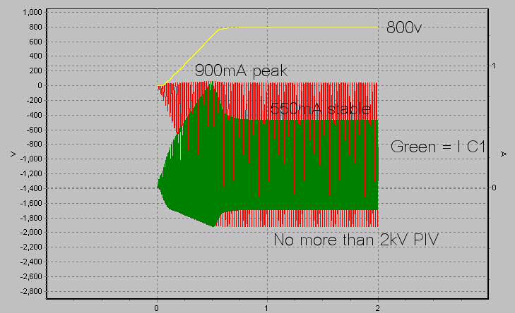

From what PSUD can tell me a 660-0-660 trafo isn't enough to push it up to /around/ 900vDC, it falls short of 200v, so I re-calculated for 750vAC RMS and hit the spot...

Labyrinth and your 900V supply
Heya. I'd be concerned about the 900 mA ripple current pulses.
Although the tranny might be able to source 500mA or so, there might
not be sufficient magnetic flux remaining. If that is the case, the transformer will saturate every 2*Power Line Frequency periods and
the transformer will buzz, heat up and lots of leakage flux will circulate.
Only the tranny mfg can tell you if it can take the 900mA pulses.
If you look at the specs for the Hammond 700 series, you see that
the CCS (continuous current service) versus ICAS (intemittent current)
differs only by 30%. In your model, you are counting on a 100%
spread between CCS and ICAS numbers, this might be overly optimistic.

Ok, would you be able to suggest a more accurate course of action?
I'm assuming up the CCS rating of the first choke, therefore increasing the ceiling for ICAS at startup.
jrdmedford said:Heya. I'd be concerned about the 900 mA ripple current pulses.
A further study of the Hammond 700 series specs reveals something
more interesting... Every transformer that can provide 300mA or
more, regardless of voltages, weighs a minimum of 12 lbs. Further
400 and 500mA transformers, regardless of voltage, seem to weigh
in between 17-25 lbs.
The transformer that you are looking at ought to weight at least this...
If it doesnt, you might not have the right transformer.
-- Jim
I should think that if I was going to do something like this, I'd have to go with electrolytics, designs with low farad Paper oil capacitors is a fruitless attempt...at such high voltages, essentially requiring even more..
Voltage doublers are /very/ tempting...
Well, it might be easier if you could relax the requirement of 550mA CCS.
At that power level, you honestly should be talking to someone with
RF Linear Amplifier design experience and you should be planning for
the size and expense associated with the parts needed to get the
job done. Peter W. Dahl & CO (www.pwdahl.com) has transformers for
sale for this purpose. It is going to be big (150 lbs or more), heavy and
the shipping costs for the parts might cost as much as a NOS tubes.
I'd not use Electrolytics caps for high voltage, particularly as an input
capacitor. The high ripple pulse currents cause them to heat up. The
failure modes of Electrolytics are unreasonable at 1000V. Paper in oil
caps have softer failure modes. They are self-healing for modest internal faults. I would say that a paper (MP) or film (MKP) is a must for an
input capacitor!
As a reference case, Morgan Jones talkes about a HV PP amp in his
book Valve Amplifiers 2nd Edn. Its called the "Beast". Its a PP 845 rig
that uses 900V at 200mA per channel. In the case study, you will
also see that he needs to use a 350mA rated choke even though he is
drawing 200mA CCS (if you read the article and follow the analysis, you
will see why this overrated choke is utterly necessary). A 10H 350mA
rated choke is going to weigh in around 10 lbs. A choke rated at 1000mA
to account for 500mA CCS might be a 40-50 lb device and chances are
it was designed for 5000V service for a transmitter somewhere which means its going to be big and very ugly to look at.... Your listening
room might look more like a substation yard than a living space.
Reclosers and OCBs might be needed for your mute/operate switch
and you might want to invest in a fiberglass pole and rubber gloves
for operating the switches...
I think a 900V 200mA supply might be reasonable to talk about...
-- Jim

Alright I'm apparently two pages behind so I'm just going to reply to what I see...
1. You DO NOT ever need two chokes. 10H as-is is too much in my book... I'd use 470uF after mind you. (Note I wind my own chokes, if I were buying, I'd go with whatever I can get... and it just so happens 10H is an extremely common value. Or if it's what you have on hand, all the more filtering, eh.) At 800V this isn't as easy but that's why God allowed electrolytics to be connected in series, with the added advantage of bleeder resistors to boot. If you have oil caps on hand and just want to use them, whatever. But you don't get as much stiffness... your LF response funeral...
2. MOT's aren't evil, but as-is they are very close to saturation and have low inductance (read: high idle current). Remember, reading a current monitoring resistor doesn't tell you anything, you have to scope it. If it is indeed drawing large currents at the peaks, then it is saturating. If sinusoidal, it isn't saturating, no way no how. Mmmmm'k?
3. Erm.....primaries in series? 😱 😕 😱 That puts 60V per primary and lets you ground the cores for a CT without rewiring them, which is dubious at best as the secondaries aren't designed to handle voltages between the core and the beginning of the secondary winding.
4. 1N4007 x 12 😀
Tim
4. 1N4007 x 12 😀
Tim
