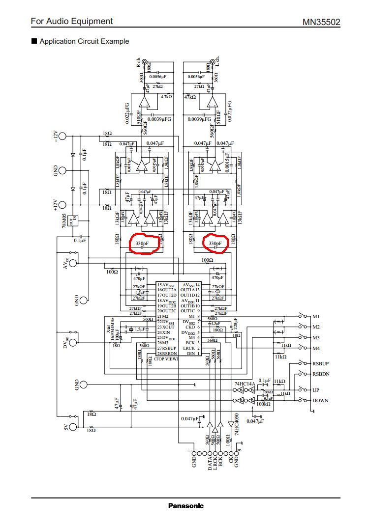

Are the caps directly across the DAC output, or are the DAC outputs first resistively coupled to the caps ?
They will be there for a reason 🙂
Agreed 🙂, but I wanted to try since the following 8(sic!) op-amps fed by the dac out should already limit the band and residual upsampling artifacts.
BTW while the application example suggests a 330pF, the board sports 470pF.
I'll test and report, but first I'm also going to change the 1.5uF ceramic (go figure, on the schematics they were referred as 1.5MF) caps between the 4 analog/digital supply rails to the DAC, with film caps.

Looking at that and I would definitely leave those in place.

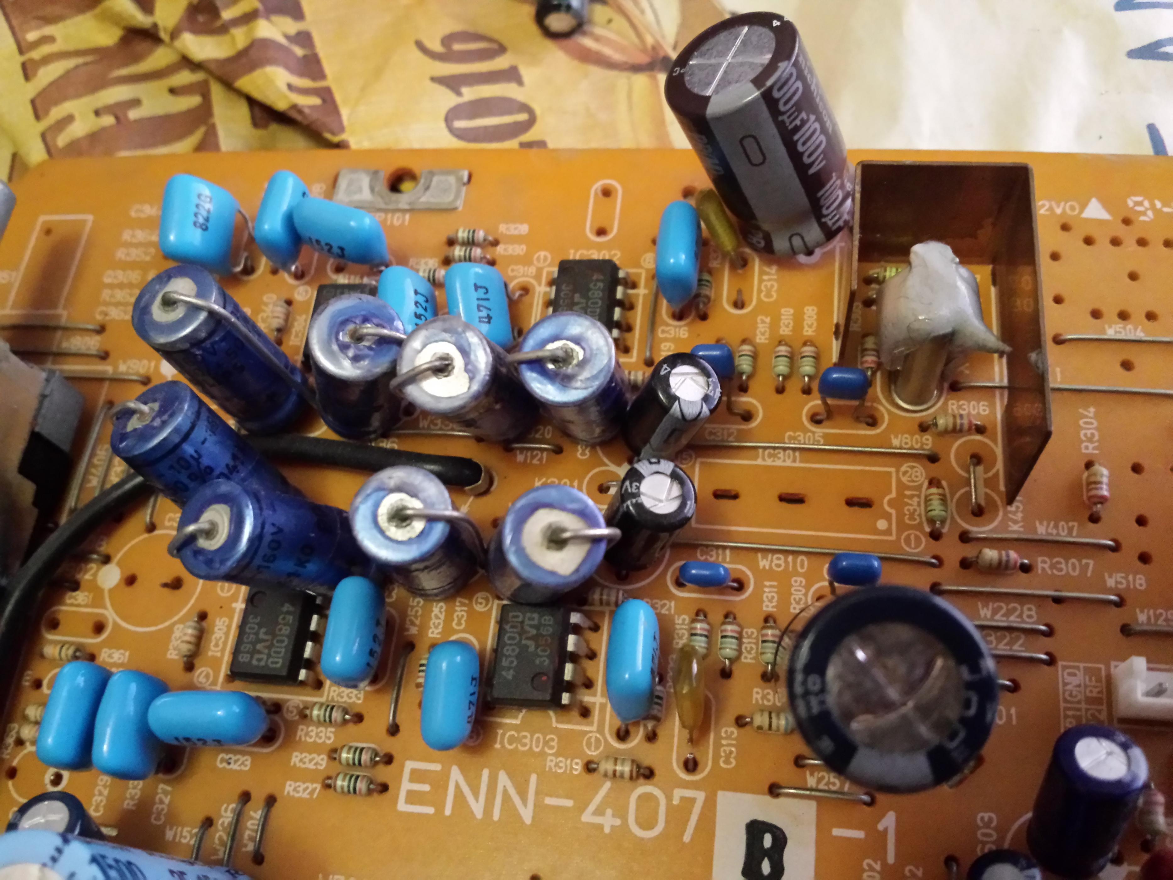

It might be worth looking at using JFET opamps for that first group because they are less likely to have non linearity issues than bjt types should any HF noise and hash be present. Your player may already use them of course.

I doubt it already uses them: on the op amps I read 4580DD JVC 30568.
On NJM-4580DD NJR Audio Amplifiers | Mouser Europe, I read bipolar technology.
The 4580 is a common bipolar device. Those could definitely be worth experimenting with... fit sockets and try some alternatives.
LM4562, about as good as it gets but still bjt.
TL072, FET input don't believe all you read... listen yourself.
TLE2072, FET input. The 'upmarket' TL072 with better drive ability.
OPA2134 or OPA2132, FET input. I don't like this these but they are well regarded by many.

Great, thanks a lot for suggestions!
I imagine that another option might be a valve output stage... time to search in the forum...!

... or a JFET (single transistor) used in common source mode to add a bit of 'niceness'.
I would just look at trying some TL072's and see if you like what you hear. Quick easy and cost effective.

...waiting for some fresh elco and tomorrow I'm going to buy the TLE2072 replacement for the 5 4580 around. Should start practising with desoldering op-amps.
Being on Mouser, I'm looking for best Q/P ratio for substitutes of the tiny 1.5uF ceramic supplying the DAC... Wondering if any MKP safety film cap might be fine...

I find solder braid the best for removing parts. They should come out in seconds with zero damage to both print and the old parts.
The four 1.5uF caps in your diagram above all seem to be extra decoupling across larger electrolytics. If those are the ones you mean then ceramics are a good choice.
So it's time to buy some solder braid, I must say I never loved much the (de)soldering pump. Yes. the 1.5uF caps are extra decoupling near the DAC, in parallel to (moderately) larger electrolytics. I already beefed the elco up, with higher voltage ratings but was wondering if it might be the case to improve them: on the 1541 I seem I recall the general consensus was to exchange the ceramics with MKP or CDE polymeric.

Cheap ceramic caps really can be the best option for adding across larger electrolytics. Their low self inductance means they keep working well at the higher frequencies (filtering all the noise and hash generated by the DAC). I would leave the originals alone.
