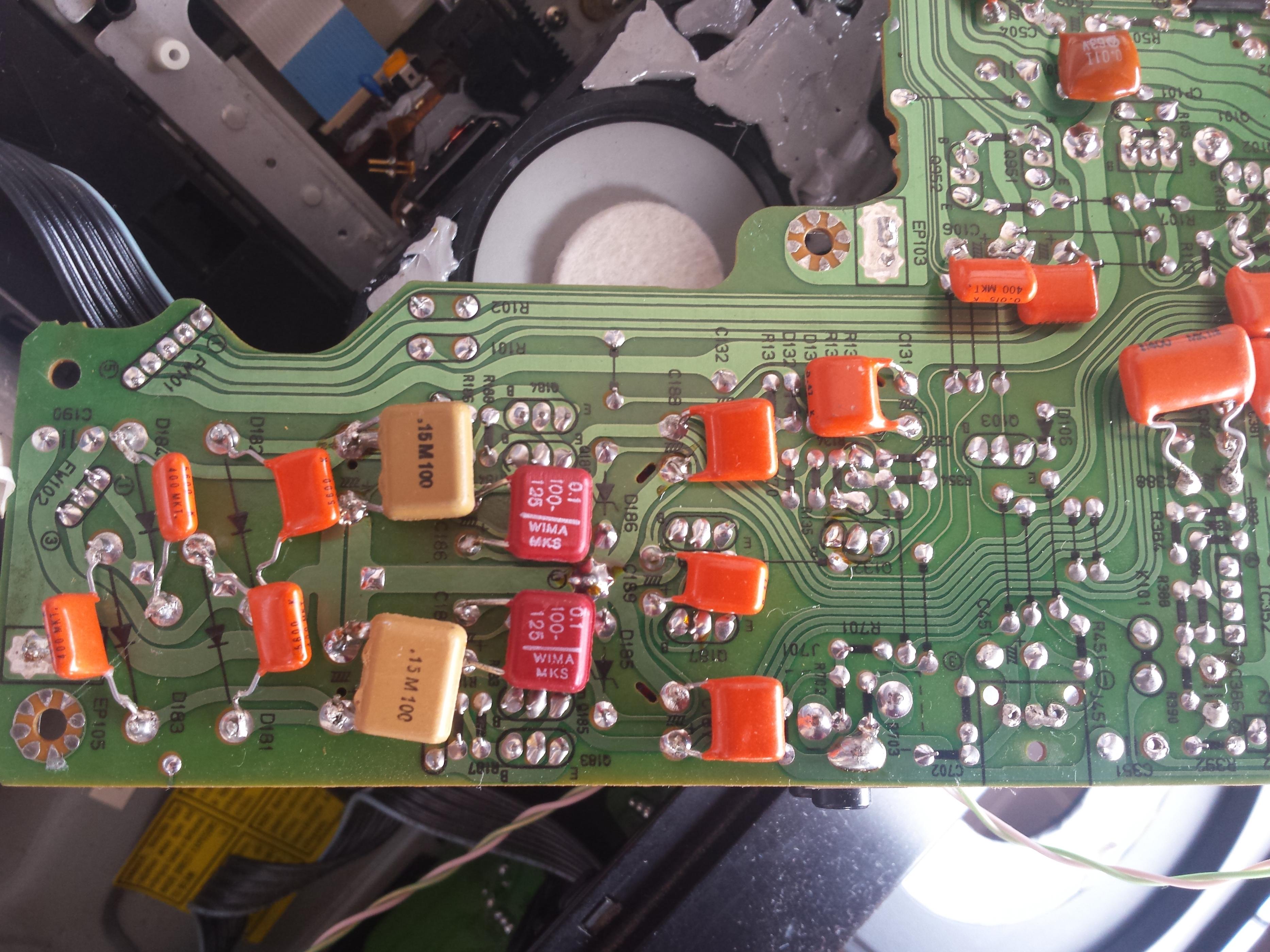

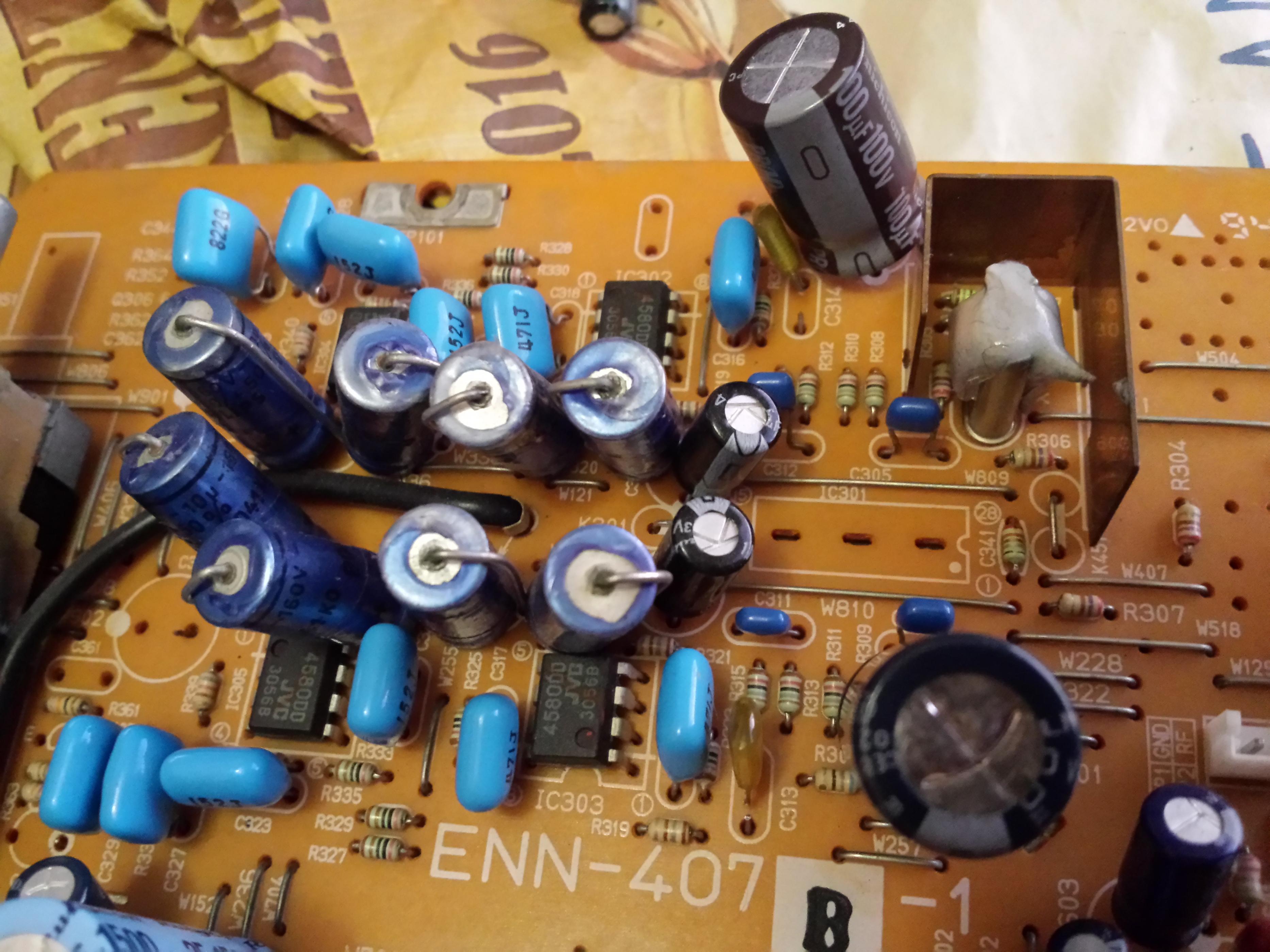

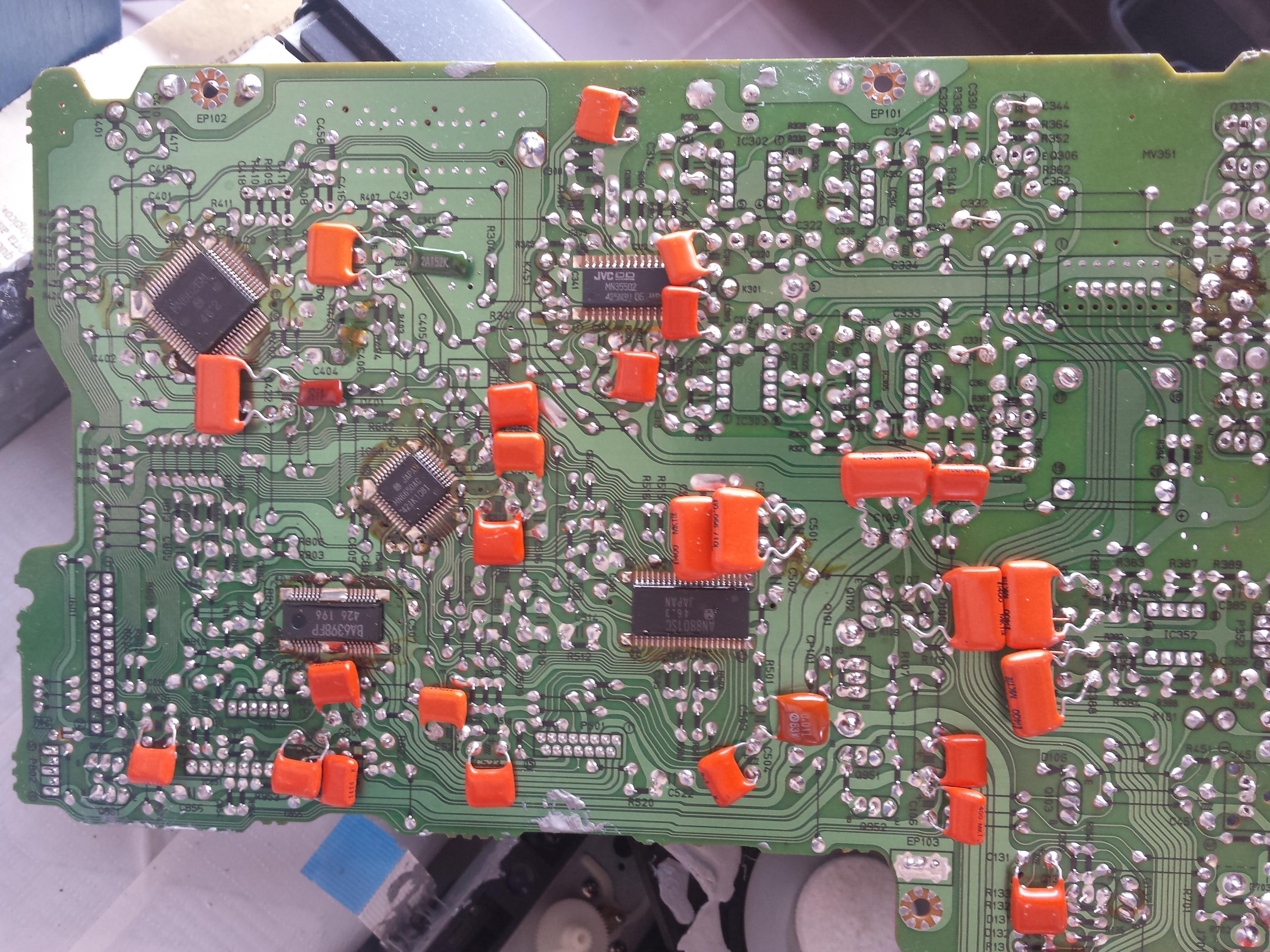

A little update.
Today I removed the PCB and started swapping the electrolytics (in a previous tweaking step I had already bypassed all of them with orange drops) with what I had available, looking for higher Voltage, Temp and Capacitance.
I still have to remove 5 of them (and bypass), but while working I stared at 4 small blue caps caring for "buffering" power supply to the dac. They are marked on the BOM as "C Capacitor 1.5MF 25V. Now, at 49, I still have to understand the logic behind printed units of measure. In engineering and physics we're taught prefix with M are 10 power 6 and not 10 power -6: 1MF would be a cap as large as a Truck!!! But assuming it is a damned ceramic 1.5mF and after reading Jung&Marsh papers on caps, they must go! Now, would you suggest me to swap for some film cap (a tight fit, I believe) or what about some Panasonic OS-CON??
I'm really curious to listen to the DAC with better caps, since I already was very satisfied by the previuos iteration: let's hope I can re-assemble it again 🙂
Stefano
