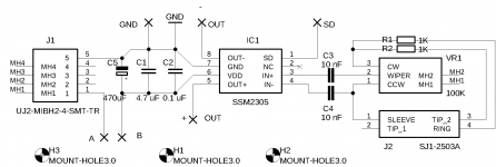

I have been working on designing a small active speaker. It's intended for a 3 hour workshop where the participants (mostly kids from 13 and up) can build it themself and bring it home. I'm aiming for a budget of 9$ pr. unit.
The main parts are the Analog Devices SSM2305 class D chip and a Visaton FR7 4 ohm speaker. The circuit includes stereo summing and a volume control.
The PCB has a 2.5 mm jack and a Micro USB connector for power input. I will add a on/off toogle switch but have not decided if is going to disconnect the 5v supply or set the shutdown pin on the chip low.
The cabinet will be a 4 liter box made from MDF or plywood. A small metal box with the amplifier made from 2 pieces of aluminum sheet will be attached on top of the box. Here's the raw cabinet.
The plan so far is to have all wood cut out and drilled, aluminum sheets bent and the two SMD components mounted beforehand. The workshop participants then have to build the box, solder the 9 THT components and put it all together.
It seems like I can keep the price at 9$ pr. unit ( 100 units in total ).
Do you have any comments to the circuit, ideas to cut price or comments in general I would like to hear them.

I am very happy to see that such is still being done. I started with electronics at the age of 11 because some engineering students took time to show us kids how to make a 15W (probably best case) mono amplifier with 4 or 5 transistors. Today it would be nothing but for us it was magic. We put it together our self, took it home and it played!!!
I do not know the SSM2305. I have tried the PAM8403 and it is amazingly good and damn cheap (I paid something like 1.30Kr per board). If you like, I can send you a couple of small PAM8403 boards for test. I will happily donate those to such a good purpose.

I hate to be the one amping up the cost, but with the expected musical content of 13yr old+ they would likely benefit from something with a little more extension below 200Hz.
It would probably double (gulp) the $9, but an amp with a 12v rail (boost circuit, with small bulk cap) would give +6dB. which could importantly go into a less sensitive / larger driver with more <200Hz extension, maybe with a reflex port to give additional efficiency down below (or a driver with a tighter Q to allow porting). Could still easily run from a 5V/2A input.
That could outperform many cheap bluetooth speakers that they are typically exposed to 😛! It would be a shame for the units to end up gathering dust?

Even if I dislike Visaton because they overprice most stuff, the FR7 is a very good speaker. It misses the ugly sound of usual small drivers. I used one as a center speaker and it did surprisingly well. If you limit the extend of bass energy (sub 120Hz) it can not use, it play´s surprisingly loud.

@FauxFrench I have looked at the PAMXXXX chips and they seem to require at least 5 additional supporting components as they emit more EMI that the SSM2305. I have seen some cheap boards without EMI filters, but they are more concerned about cost that meeting regulations. I might take you up on the offer at some point just to compare the two chips.

Larger driver = better efficiency = more loud with same amp.

My idea was to actually use the complete PAM8403 board with all the components you need mounted to make a functional amplifier, except for the 470uF or 1000uF power rail decoupling capacitor. The small PAM8403 board you mount directly on a piece of Vero-board (don't use brown Pertinax!) using small pieces of solid wire. For the two power wires you can eventually use the leads of the power decoupling capacitor. This way it is mounted in an efficient place.
On the Vero-board, you mount all the connectors you need and enlarge some mounting holes. If you like a particular output filter, you mount some small filter cokes ( 10 pieces Inducteur de Puissance DIP 6*8mm 6X8mm 2.2UH 4.7UH 10uH 22uH 100uH 330uH 470uH 1MH 2.2MH 4.7MH 10MH D'inductance 2 Broches on AliExpress ) and small 470nF-1uF ceramic capacitors on the Vero-board as well. The PAM8403 board you connect to the other components using solid wire on the rear side of the Vero-board, as it has been done for decades.
Doing it this way, you avoid having to pay for PCB's and mounting of SMD components. Bought out where “fakes” are born, you can do this for around 10DKR.

NB: The PAM8403 boards are pretty small but complete, please see below. No shaky hands.
Out of curiosity, I bought such PAM8403 boards and ended up testing them with my Jamo 707 speakers. At a good sound level but not loud evidently, they just sounded amazing for what it was.

At 100pc, you should be able to buy them wholesale or from a distributor (especially if you mention the final goal, sometimes a little promise of mentioning their name as a 'supporter' goes a little way too!)
This should hopefully be able to get you a 'model up' for the same price. Higher Sd, lower FS or lower Qts will all be highly beneficial! 😀
