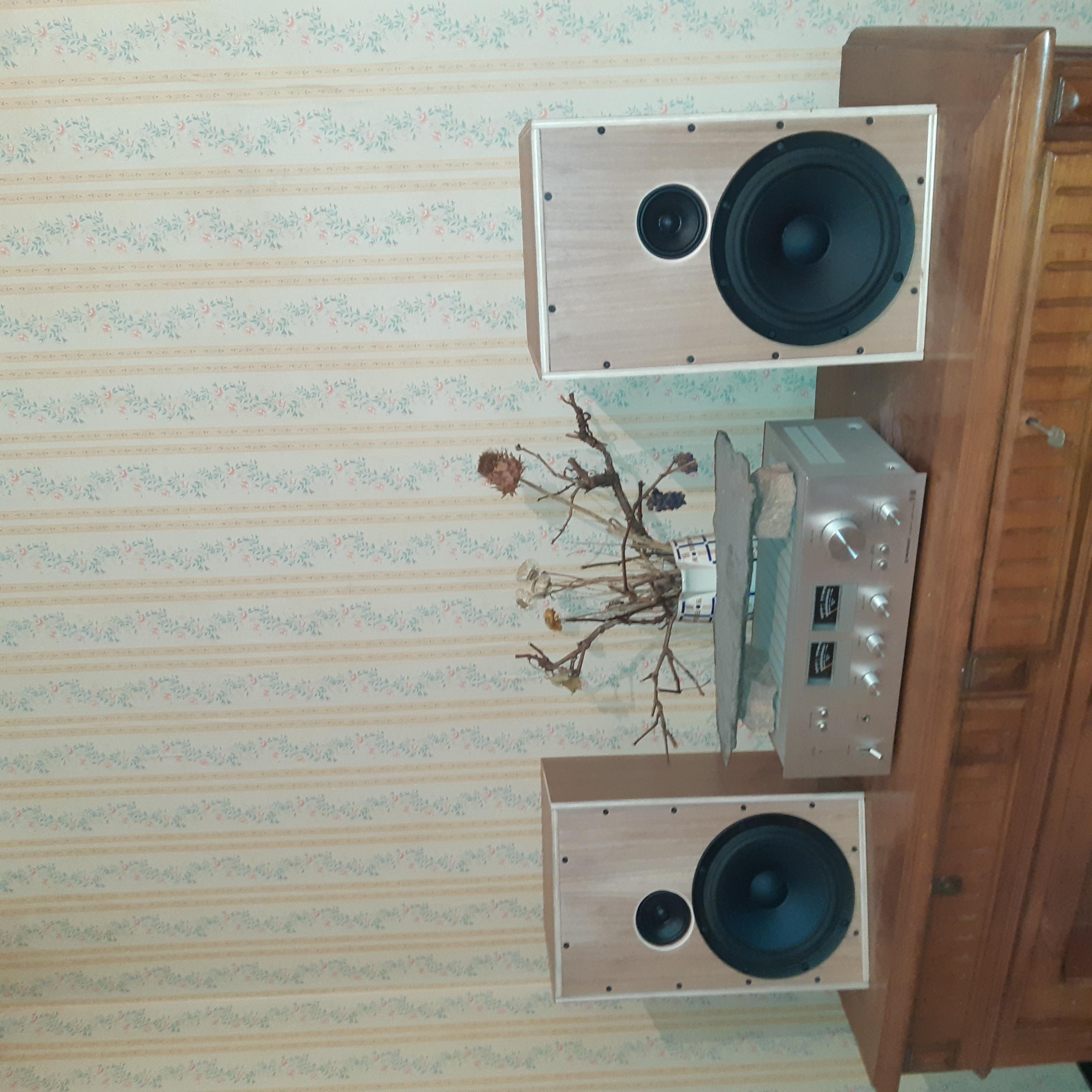

wood-skills... I know... I just finished my Harbeth like just because I can not do better 😉
