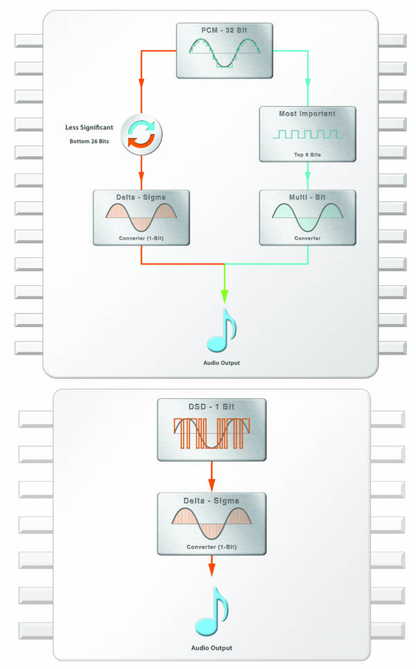

Hi all,
As you know, there is a lot of 24bit DACS today. But my thinking is along these lines,
Only with 24bit source material are these of any use (and even then bits nearer the tops aren't real electrical bits, which I believe why multi-bit is more popular).
I think up conversion from 16bit to 24bit modulators can hurt the sound and that it's better to play 16bit material via a 16bit or less device (14bit 1540 anyone?)
So what of the 8bit multibit section of the all-so-common delta-sigma dac of today? can this be exploited?

OK, since you called out to have your post dissected, here goes.
Quotation, explanation, proof??? Just a lot of 'thinking' and 'opinion' based on very little actual data and knowledge.
All PCM samples are normalized to +-1.0, which means they contain the N MOST SIGNIFICANT bits of an 'infinite' resolution binary number, N being the number of bits in a sample minus 1 (the most significant bit is used as a sign). In other words, extending a 16 bit sample to 24 bits involves all of adding 8 zeros at the end, producing the exact same binary number. How did that hurt resolution? This is basic binary math.
However, to be a 16 bit converter, the bits have to be accurate to at least one more bit past the 16th bit, i.e. to at least half of the 16th bit or better. A 24 bit converter, theoretically, has to be accurate to half of the 24th bit, 256 times more accurate than a 16 bit converter when reproducing 16 bit samples. Again, how does this hurt things???
In the real world, actual 24 bit accuracy while maintaining the standard 2V RMS output is a near physical impossibility, so the BOTTOM and NOT the top bits (so you are dead wrong here and would know it if you had any notion of the most basic binary math, as in which bit carries which weight) in a 24 bit converter are not real because the actual resolution is more like 20-21 bits. That being said, that kind of converter is still 16-32 times more accurate in reproducing 16 bit samples than a 16 bit one, so again, how does this hurt 16 bit reproduction???
There is no such thing as a 16 to 24 bit 'modulator'. There is a 16 to 24 bit FILTER, for example an oversampling filter, which is not used if you only want to extend the bit depth at the same sample rate.
The reason for this is that filter coefficients are fractional numbers which, even for a filter operating on 16-bit input data, may not be accurately represented in 16, or for that matter 24, or for that matter infinite number of bits (like 1/3 cannot be represented in a finite number of decimal places). Digital filtering is a series of multiply-add operation on a first-in first-out buffer, and if one wants to keep thing accurate, it has to work with a lot more precision than the input data, in fact just reducing the coefficients to 16 bits may produce a worse filter and loss of precision on the output, so 40 or more bits was not uncommon even 25 years ago, while now 56 or 64 is the standard. Because 16 bit precise data multiplied by eg. 24 bit precise coefficients can generate results with more precision than 16 bits, the first filters had to reduce bit depth back to 16 bits at the output and of course apply proper dithering while doing it, in order to convert this data into analog using a 16 bit converter. As a result, a 16 bit DAC driven by a digital filter, driven by 16 bit samples, will lose about half a bit of precision. Soon after this first generation two methods were applied to counter this, which are using a more than 16 bit (18, 20 bit) ADC, and noise shaped dither, which pushed the loss of resolution into an ultrasonic region that the output filter after the DAC would almost completely remove, therefore preserving the maximum of the 16 bits of the data.
And while you are mentioning the venerable 1540, it was driven at a 4x rate with a noise shaped digital filter (one of the very first ones!) to actually attain virtually 16 bit resolution – because that's what proper noise shaped dithering can do, as long as there is extra bandwidth to push the noise into.
The current SD modulator based DACs do exactly the same thing, the difference is in the way the DAC attains high bit resolution, and in some cases this can open up more space for better dithering and noise shaping.
What about it? It is not a 8 bit PCM DAC nor is it accessible in any way except perhaps in DSD mode if the chip actually supports DSD data bypass, but then it only uses one bit input. It is usually a potentiometric DAC, which for N bits has N+1 states. Typically it's 6 to 8 bits and therefore has 7 to 9 states, around 3 bit resolution. It always has N=A bits 1 + B bits 0. The trick is that, for instance if 3 bits are on and 5 off, it randomly choses a different set of 3 bits out of the 8 available to be 1, for every sample where 3 bits are on and 5 off. What this does is statistically averages out the tolerances in the actual 8 bits – which should all be exactly equal, but since this is the real world, they are subject to tolerances.
More advanced chips actually use real 6 bit encoding and drive a 63-bit potentiometric DAC, to have even more bit elements to average out the imprecisions. This method of operation is commonly known as dynamic element matching. Why this high precision in a low bit DAC? This is because SD DACs trade amplitude precision for time precision by reducing the number of bits and driving them very fast with a bunch of noise shaping, BUT the actual bits still need to be very precise. This is because in theory to get each extra bit of resolution you need to increase the speed by a factor of two, without noise shaping. With noise shaping the factor drops down but faster than the requirement for precision for the actual real bits without noise shaping. Still, it is obviously much easier to get say 20 bit precision in 6 bits than in 20 bits! For instance using a 63 element potentiometric DAC to get 6 real bits of resolution will reduce the tolerance of a single element by a factor of around 5.6 (this is equal to about 2.5 bits more precision than a regular say R2R 6-bit DAC using the same elements).
If you had access to this DAC you would have to use it exactly as it is already been used to get the same result, everything else will be WORSE not better.
Completely wrong. Oversampling is done FIRST in order to get to a sample frequency which gives you enough space above the audio band to push enough of the quantization noise into the unused part by noise shaping as you next do bit depth reduction. Doig otherwise would result in loss of resolution right from the start and would be clearly audible and visible in measurements.
Some additional oversampling may occur without noise shaping and dithering at the highest sampling rate stages to implement more advanced dynamic element matching.

See this info-graphic in the marketing material for the iFi nano.
It's also re-assuring to see a real product which allows control of the phase behavior of the interpolation filter, as a toggle on the device itself.
