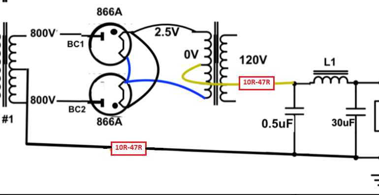

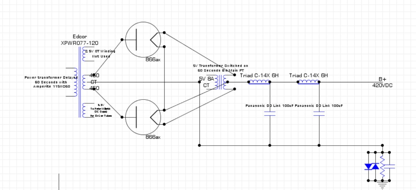

Check the connections. If the glow with the meter but not without, it tells me there's a break somewhere.
Try 82k 25..50W resistor (maybe on heatshink) as 10mA dummy load.How do I get bias on the power supply?
BTW why do you use series connected -rectifier- filaments. Paralleling its very common, 2.5V 10A filament transformer need.

Could the act of connecting the meter cause the tubes to emit hash and glow as a result? The datasheets do say to include RF chokes.
PRR - that is a drawing mishap. that is connect. The PT CT is connected to Ground. Also, I have inserted 2 resistors to measure voltage across the 2 resistors (see attached diagram). Both resistors measure 0V across them which implies no current as well. Still can't get any voltage from the filament transformer CT unless the DMM probe is used to touch the bayonet cap and ground, then 800 voltage is present.

Is the filament transformer 5V-0-5V (minimum 5A) or 2.5V-0-2.5V (minimum 10A) type?
Is it has 3 wire or 4 wire on secondary?

Here is how I did mine. It has been glowing for 11 months without problems. I use an Amperite 60 second NO tube relay to switch on the main power transformer. A 5V 8A filament transformer is used with the 866As in series. There is a balancing wire that evened out the filament voltage as they were off by a few 0.1V.

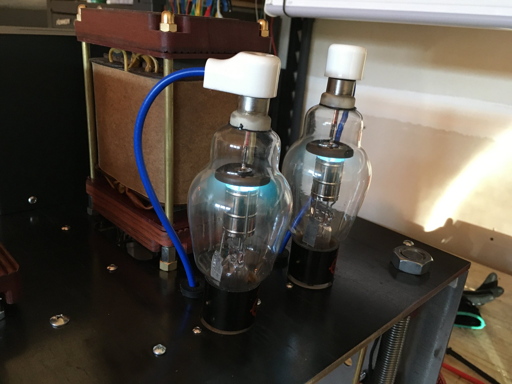

OK fellow DIYers. We have solved the issue. On my transformer, there are 2 secondary CTs (1 for HV and 1 for bias supply). I was connecting incorrectly to the bias secondary CT instead of the HV secondary CT.
I corrected the issue and now we get 831Vdc measured from Filament CT to Ground. Nice blue glow on the 866A.

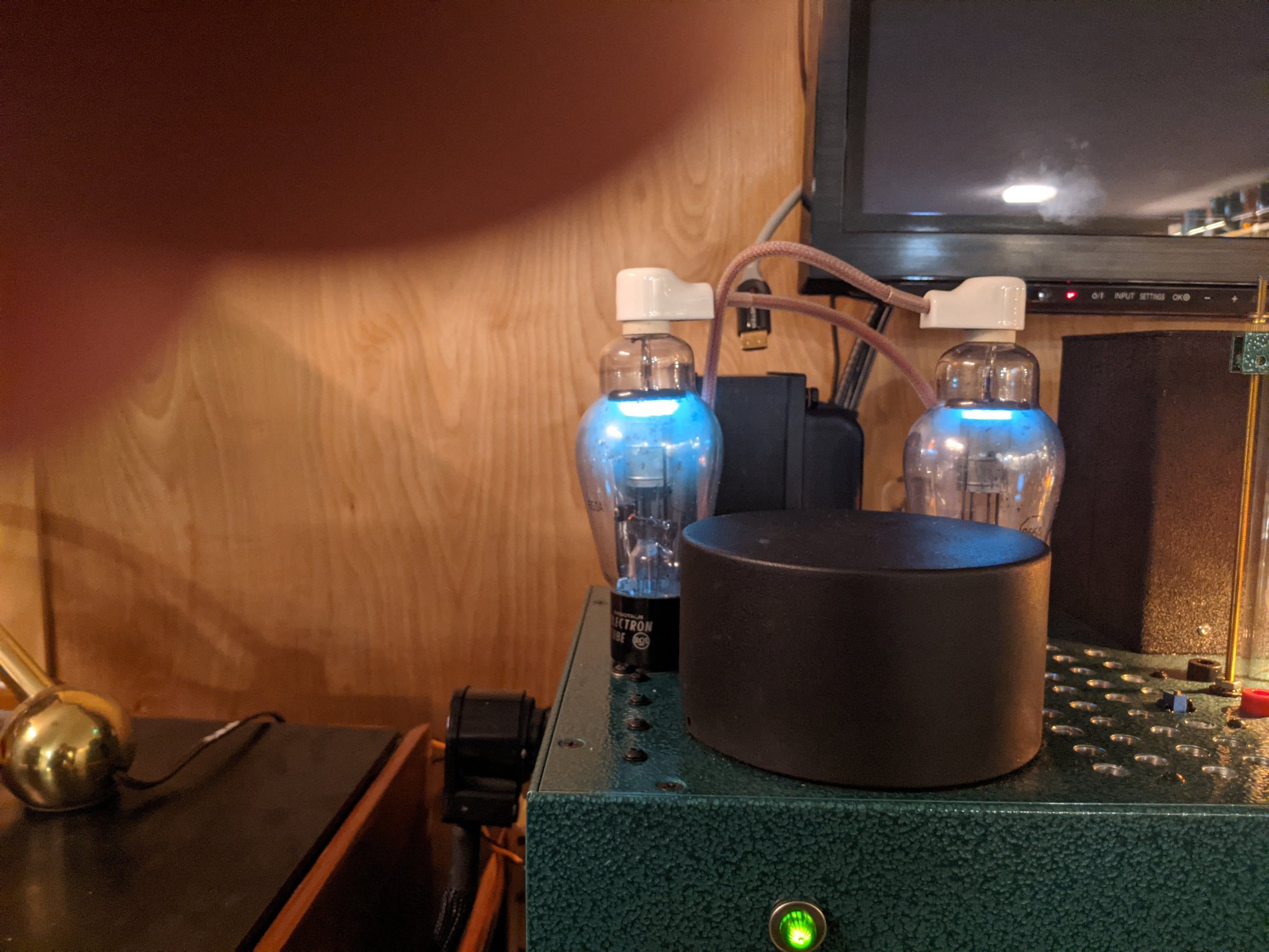

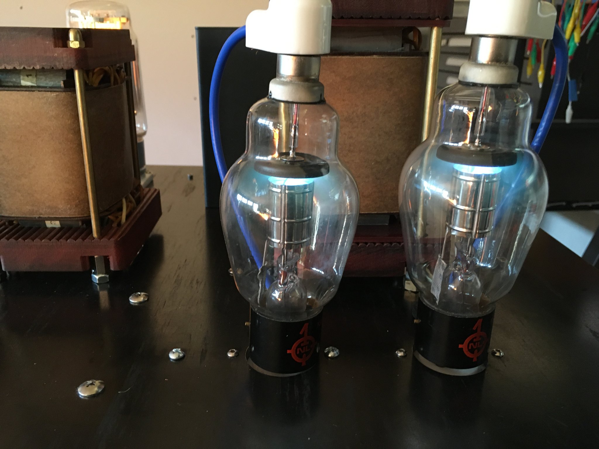

Those are some pristine 866A. All of mine look like the dog ate breakfast inside. Mercury streaks and the like
