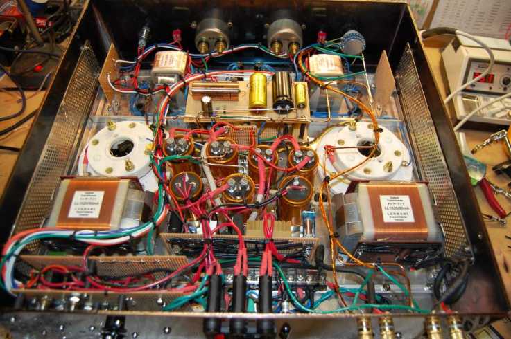

Rick, heat was part of the issue. The problem that I faced was that the 845 ceramic sockets are designed to mount on top of a panel. I wanted to mount it underneath. The HV connections are at the top of the socket and mounting it under the panel would have left only about 5mm between the HV connection and the metal of the chassis. Perhaps this would have been OK but I thought that this was probably too close considering I am approaching 1KV. The ceramic spacer/insulator sets the HV connection 11mm from the chassis (5mm air/6mm ceramic) - probably way over the top, but better safe than sorry. It also helps to remind me that I am dealing with HV here!
When considering the issue, I felt that ceramic was the best option. Good electrical insulating properties, heat resistant and relatively easy to work with. I cut it up with an angle grinder and drilled the screw holes with a ceramic drill and cut out the centre hole with a Dremel ceramic cutting tool. I only broke a couple of tiles!

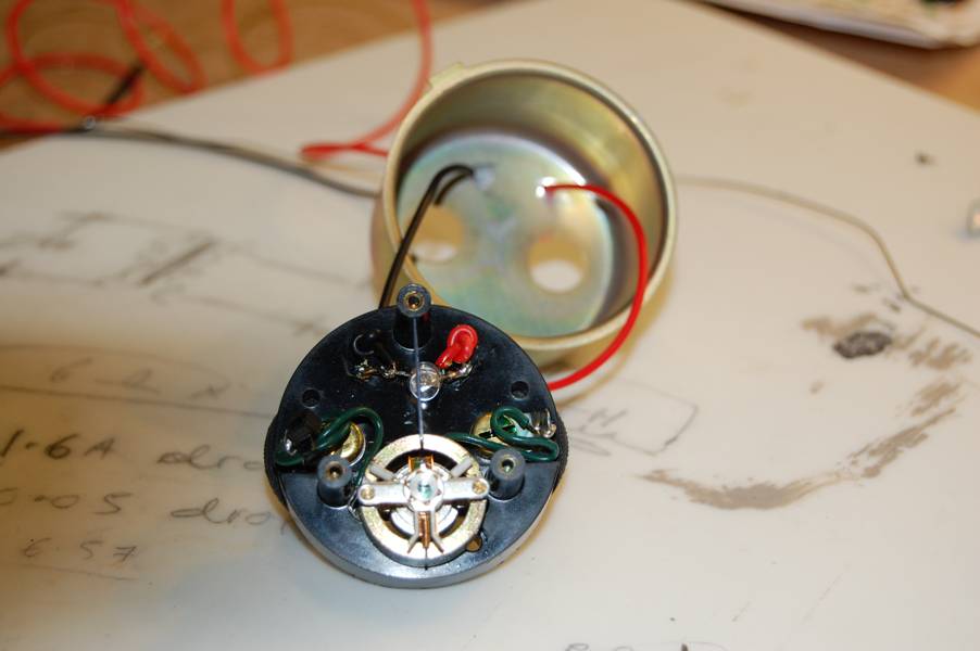

Those meters are very pretty with the blue LED backlight. How many LED's in each meter case? This amp is gonna look really nice.
rcavictim said:A 12AUY7 should work very well in this application!![]()
Thanks for the vote re the 12AU7. I am obviously a little apprehensive about the final result, this being an essentially untried design in it's present form.
With regards to the LED, just one 5mm, 6500 MCD blue lens.
I have included a photo of the dissembled meter with the LED in place.

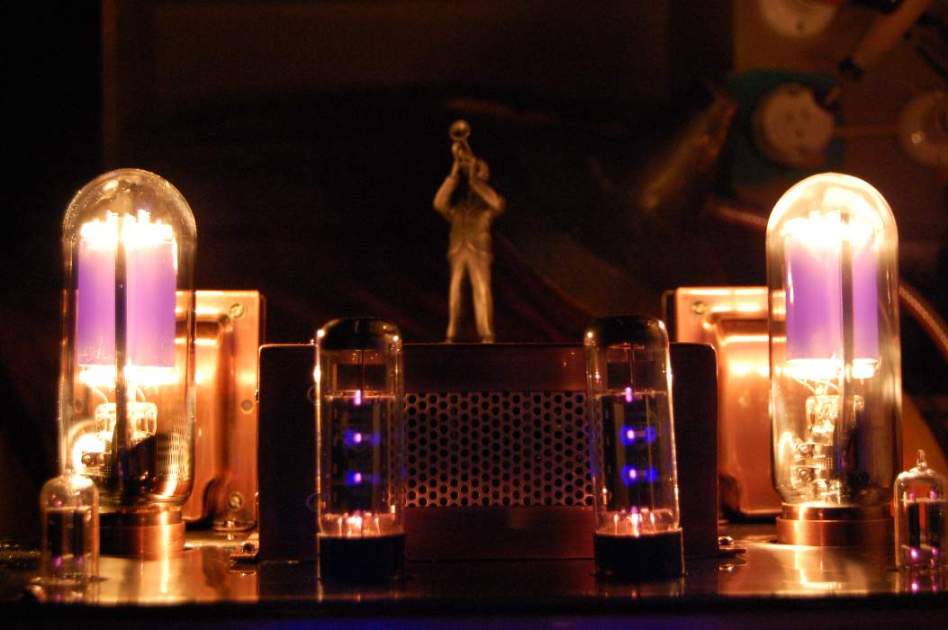

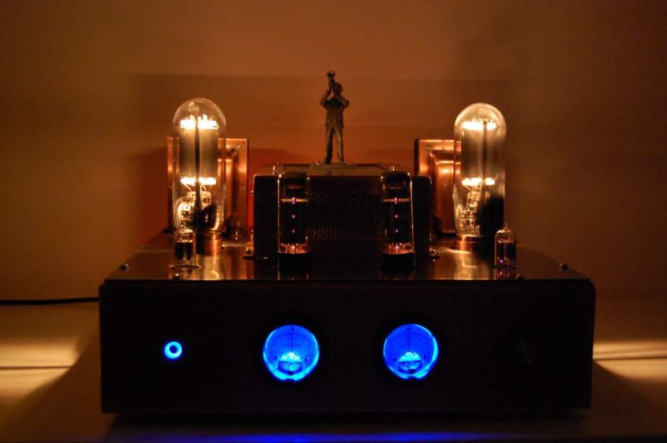

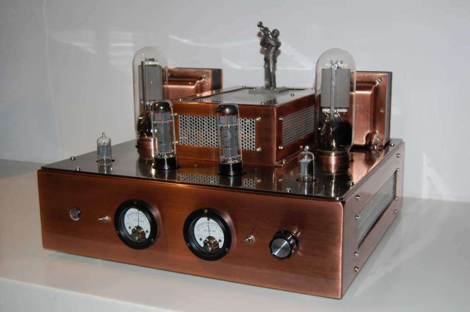

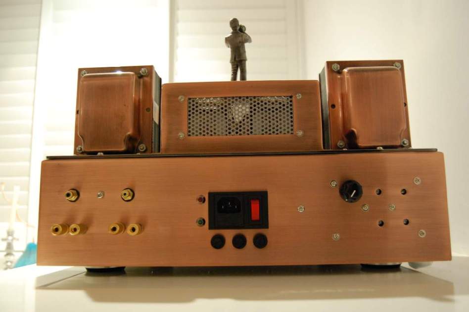

Finished !!
Hi Folks,
I have finally finished my 845!!
Thanks to Andrea Ciuffoli for sharing his design through the forum here.
Thanks also to all of you guys for helping out over the last 6 months. I would not Have been able to do this without all of your help. Thanks especially to Sy, Rick, Chris (and for the Bus wire), Boywonder, Ty, Geek, Ray_moth, Nick, Gingertube, Rcavictim, Robert, Poindexter, Richy, Hollowstate and Sheldon. Apologies to anyone I have inadvertently missed. This project would not have been possible without you guys😎
Some brief technical notes (in no particular order)
1. The heater supplies are DC and the heater wires are twisted post rectification out of convention only.
2. The power transformers are custom made Edcors.
3. The bias meters are switchable between the EL34's and the 845's and the bias can be adjusted through small holes on the back without opening the chassis.

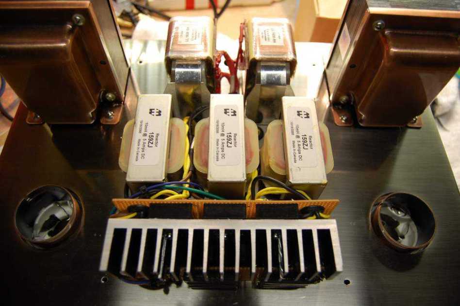

4. For anyone contemplating the build, this thing makes lots of heat!! Think barbecue or small steelworks smelter!
I over rated all of the power resistors by a factor of 3 - 4 x and I am glad that I did. Big heatsinks, especially for the heater rectifiers are a must.
Finally, how did it work out? I am really pleased with the final result. It is very quiet at rest and has a clear crisp sound with strong bass. i can't fault it and would highly recommend the design to anyone interested in an 845 SE design. Furthermore it was a real learning exercise for me and I have learned a hell of a lot.
Once again, thanks folks.
Rob

oh boy ...... fugly!
but - blue leds in vu meters are as poke in the eye ........ comparing it to 845 firework ........
Rob, I think you did a superb job with the layout, finish and wiring. That's real nice eye candy! You should be proud of yourself.
Victor
Victor
That came out truly wonderfully Rob! Looks like a seasoned artisan made it, not a relative newb. I think your copper work is beautiful. I'd be very proud of that if it had been my own work and that is high praise.
