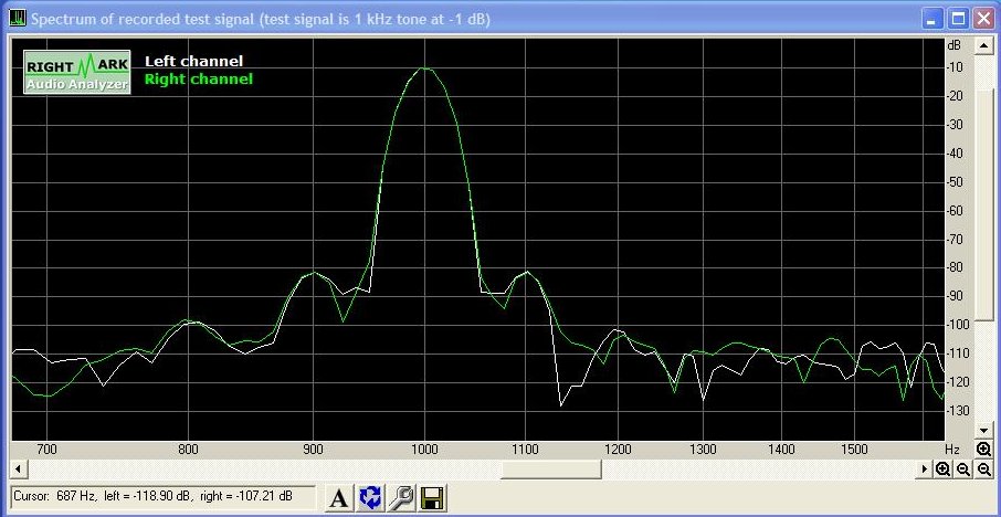

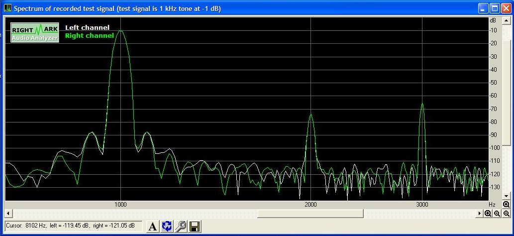

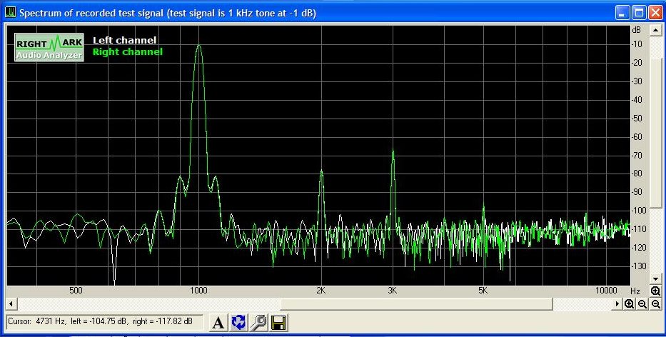

This won't change the results already obtained. RMAA has sufficient (frequency) resolution for these measurements.
Or what is your idea about better resolution ?

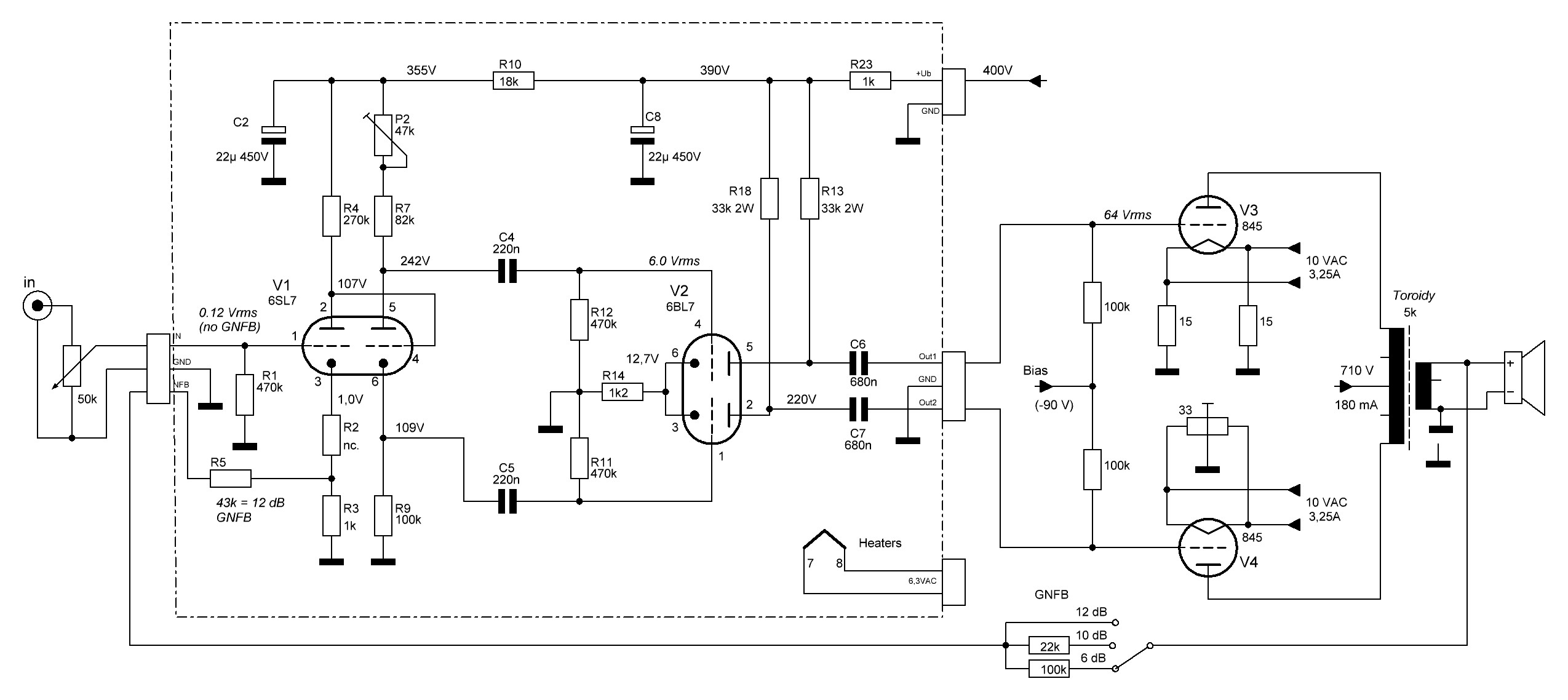

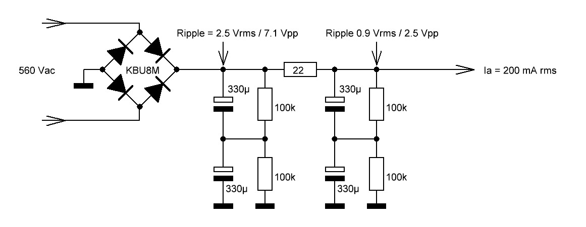

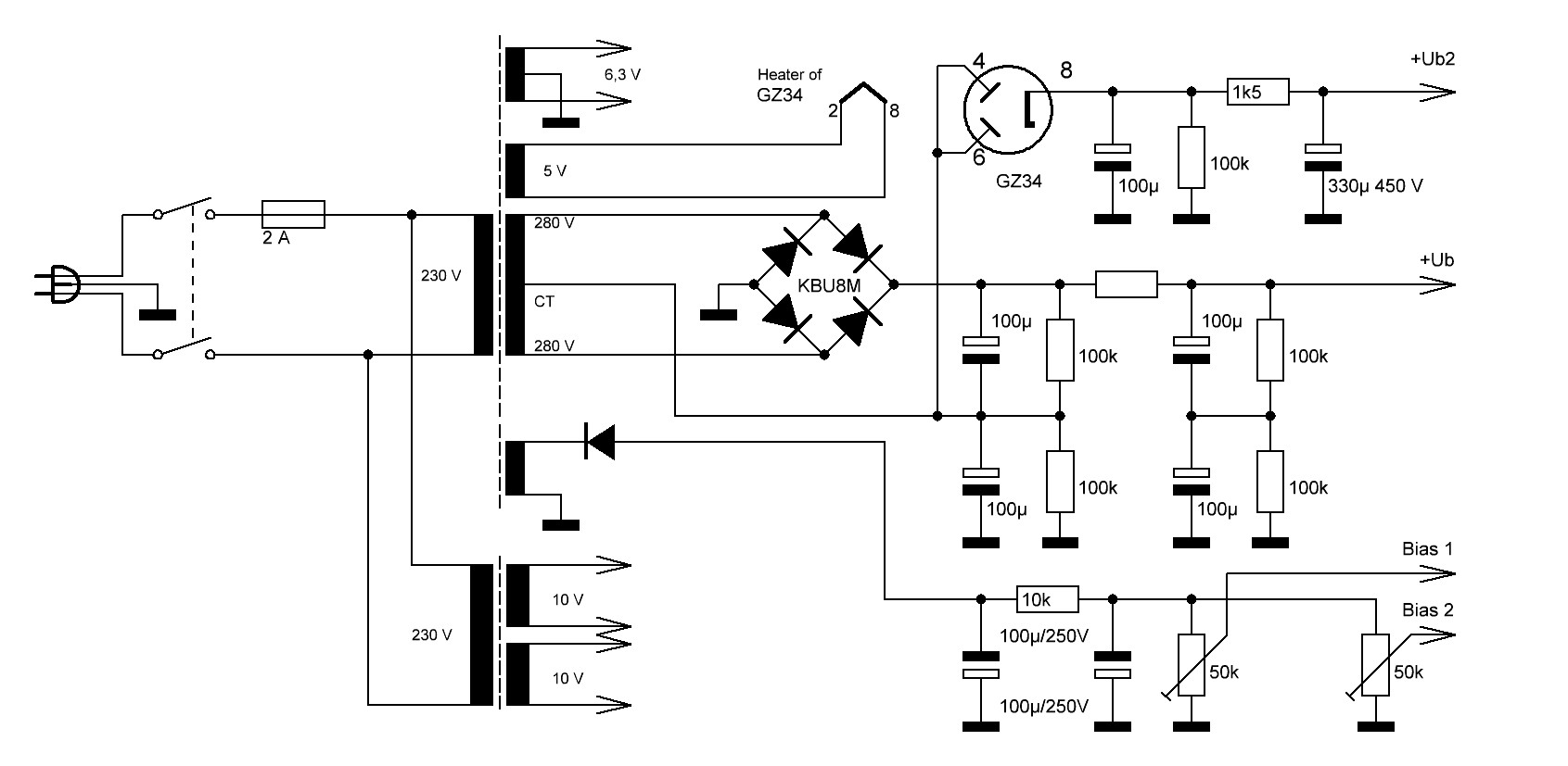

2.5Vpp ripple is a lot for a single ended voltage stage with 6db PSRR like a common cathode amp
Yes it is. For the entire front end stages of a tube amplifier some 1...10 mV should be the target.
In earlier discussions (2.5 Vpp) I have meant push-pull output stages only.
