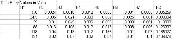

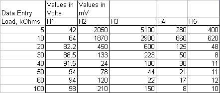

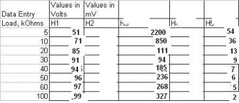

Hi Federico,
Thanks for the answer on input admittance. This is kind of good news/bad news.
The data from the load impedance test. Feel free to comment. The circuit was as you have drawn above except 110 uF capacitance rather than 100 uF, the 80k resistor on the primary is 100k and the voltages I am using on the 12B4 are a little lower than in the past. 214V plate and 27.3V bias. Data collected with signal on grid of 12B4 at 20V by multimeter, maybe the edge of grid current for it too?
Michael

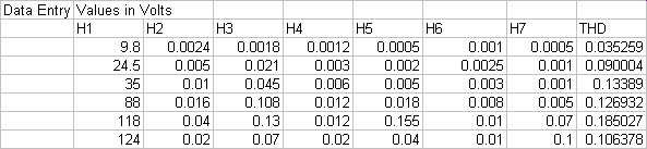

Hi Federico,
Michael
definitely my model is different.
At first I have to give 240V to b+ in order to have
27.3V bias. (yes, 20Vrms as input is sligth grid positive)
Then put the cap from CT to ground to have results more
similar ( at least qualitatively, wiht a minimum) to
yours.
you see less voltage loss that is my model
has smaller internal res.
I write only odd harm since even are obviously very small
because balance is perfect.
here is my table
Federico
However maybe you need a better driver.

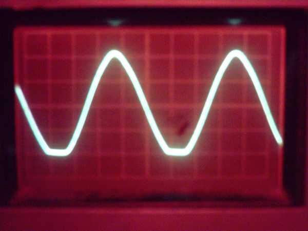

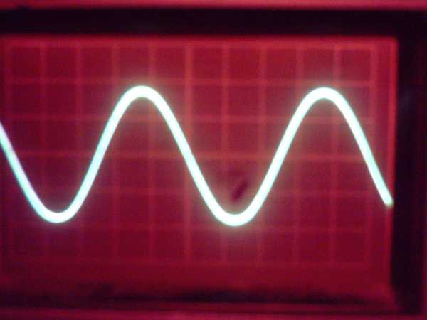

What I am confused about - when using a 10k output transformer I seem to remember being able to swing around 300V peak to peak on the primary. Why would performance be drastically worse with the 18k load reflected back as something over 20k with the 1660? Something doesn't seem right.
Now I am confused too. With similar load I expect similar
results on the primary. If not I see only two possible causes
a) different working point of 12b4a
b) saturation of 1660
What do you think?
Nic

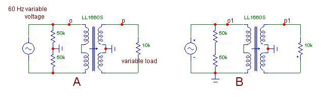

michael
I read the .pdf, but I think that such data is quite meaningless since rms voltage has little to do with core saturation (if load is not specified) which depends on current.
However, as for me, you are able to verify the saturation performance of the 1660 by means of your variable 60 Hz supply.
If you can have it balanced (floating) you can use configuration (A) , otherwise follow config. (B). By varying the load and looking at the wave in (p) [or (p1)] you would be able to verify the quality of the trafo.
Reading at (o) has to be 20 Vrms while, naturally in (o1) (B config.) you will read 40 Vrms.
Federico
According to the Lundahl datasheet, the 1660 should be good for 2x230Vrms at 30Hz.
Federico

Hi Federico,
I can try the test you showed. I have a floating variable supply that I am using for the filaments. It can be varied from 0-25V. How did you pick the 20Vrms, or was that just used to indicate the double voltage necessary for a single ended supply?
I thought that for AC current/voltage in the transformer it was the voltage that determined saturation and current that determined the power level. I must be confused.
Michael
Hi Federico,
Michael

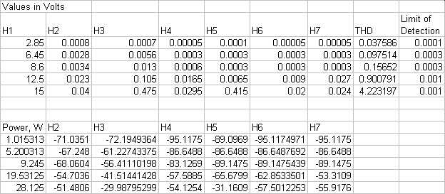

Hi Chuck, all,
Chuck, do you think the bass boominess with the 11k setting could be because you were approaching or reaching saturation of the 1620? It's only rated at 63W in that configuration. I thought the higher impedance ratio would offer better speaker control? I know from the simple models I have run it models with greatly reduced 3rd harmonic distortion, ie an order of magnitude. Just had another look at your schematic and I must say I like it.
Federico,
Much as I like the idea of A2 and the lower B+ that goes with it, I must say I like this driver setup too. I know my gain margin is not great and there are probably other things that could be improved, but I just did a measurement that makes me remember how good I think it sounded and measured on it's own.
With no load on the primary of the 1660 and a 50k load on the secondary I got these numbers.
output from 1676 input (grid of 6SN7)- 1.55Vrms
on grid on 12B4- 21.3Vrms
12B4 cathode at 30.7VDC without signal and 31.2VDC with signal
~295V pk to pk on plate of 12B4 by scope
100Vrms on secondary 1/2 of 1660
H2=320 mV
H3=70mV
H4=15mV
H5=44mV
H6=<1mV
H7=10mV
H>7=<1mV=below limit of detection
Do you think I can come close to those numbers, and given that I know that on it's own this circuit sounds very, very good, with a setup that can deliver the necessaries for A2 function? I'm torn.
Michael
H2=320 mV
H3=70mV
H4=15mV
H5=44mV
H6=<1mV
H7=10mV
Michael
sinewave before
Hi All,
I decided to run a complete distortion vs volts output on the 12B4 with a 50k load on the secondary of the LL1660S. When I got to 125Vrms, the highest I tried and almost certainly overdriving the grid of the poor 12B4, I got this picture on the scope from the primary of the 1660
M.
Hi All,
M.
sinewave after
This is the picture, all conditions unchanged except the location of the 10x scope probe, on the secondary 1/2 to CT. Class AB or just a general cleaning up? I guess I've not looked often at the primary side of a transformer before.
M.
M.
