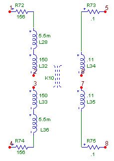

The LL1620 has been implemented as follows
bye
Federico

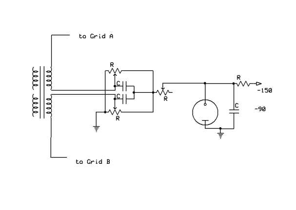

Hi Federico,
Did you have the dynamic feedback pots set symmetrically when you modeled them? It seems a single resistance should be capable of balancing. I don't know if that changes the behavior or not. Something like this?
Michael

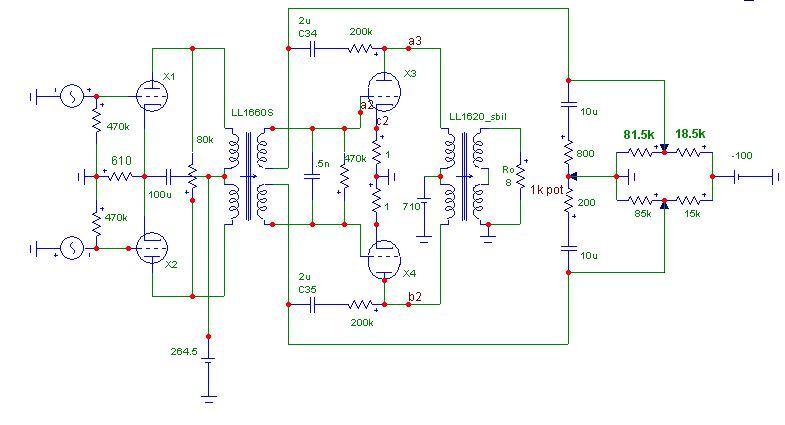

Hi Michael
with your schematic static and dynamic
balancing are interconnected.
But I want separated adjust pot
since the cause of unbalancing may be different
Tube differences affect mainly static balance,
while trafo asymmetries directly influence
dynamic balance.
I have used that layout to minimize NF use.
Only one ( of the two) pots ( dyn. bal) have to be adj.
only the right one. the other is left ot zero res
thus no NF in that part. NF only where it is
needed. May be this can be changed , I have not
think on , to utilize only one dyn balance pot.
Federico
dynamic unbalance
Hi Federico,
I got the files OK and have played a little bit already. Very nice.
For the dynamic unbalance, my thinking was that the AC current through the shared R (closest to VR tube) would be zero in the case of a dynamically balanced circuit, but a feedback voltage would develop in the unbalanced case which would work in opposite on the tubes to acheive balance. No? The static balance resistance is bypassed so that it does not effect dynamic balance.
Michael
Think about a statically unbalanced but dyn balanced case.
I adjust one pot to restore correct current values.
But making so I will change the load of one tube in
respect to the other and it will dynamically unbalance the circuit.
In your cir, for AC current, one tube see a part of one static pot res in parallel to part of the dyn pot res.
My static pot do not change the load of the tubes
because of the capacitors to ground. The AC current
does not see those pots.
Federico

Hi Federico,
I know the circuit had some problems with the back end of the voltage divider, I just posted it as an example for discussion. What would happen if the 470k resistor between grids of the 845 was replaced by two separate resistors to ground, so there would be some small static current through the bias setting resistor. Then the voltage divider could be removed and replaced by a bypassed variable resistance to set the static without effecting the dynamic balance?
What is the purpose of the 0.5 nF capacitor between the grids of the 845s?
Michael
To avoid a resonance, apeak in the frq. responce probably
due to the interaction of the grid capacity with
the 1660 trafo. I do not know if it is a real thing.
Note also that parassitic capacitances are not modelled
in tha trafos.
Something like this can be done . I will try.
In the meanwhile here is a version of the adj cir that avoid
one pot but introduce some NF also when things are perfectly
simmetric since we have 500 Ohm in series.
Bye

hi
Other considerations
If one of the dynamic bal pot of post #58 has a bad
conctact the amp stop working.
It this happens to the dyn bal pot of the last post
only an increase of dist. is noticed.
One may prefer the first situation,
one the second.
federico
balancing pot
Yes, I thought about this case, too. Also, I have not had a chance yet to figure out how the feedback affects the output impedance to the load. Does it have any beneficial effect? Now a practical question, how would one monitor the dynamic balance, so that the user could adjust it without sophisticated equipment? I guess this also applies to the 6SN7 balance pot.
Still many problems to solve with my plan, not involving the signal path, but the things like turn on delays and safety, etc. Lots of work.
Michael
Hi Michael
the simplest way to dynamically balance the cir
is to use a sound car like soundblaster
and to minimize even order harmonics.
It is not a sophisticated equipment.
An alternative method is to minimize
rms current trough B+ supply.
It is not the same thing, but it is
a good approximation.
Bye
Federico

If you are referring to the LL1620.mac and LL1660S.mac
file, yes, they can be read with the notepad but it is difficult to understand something in this way. It is by far better to read them with Mcap: File/Open/filetype =Macro.

A question: You say me to assume DC secondary resistance of
the 1620 as 0.2 ohm and, if you see the LL1620.mac, I have
done so ( 0.1+0.1). But I saw the pdf Lundhall file reports
an "average resistance" of 0.4 Ohm. I am confused.
Does it depends on the kind of connections ( A,B, etc.)?
