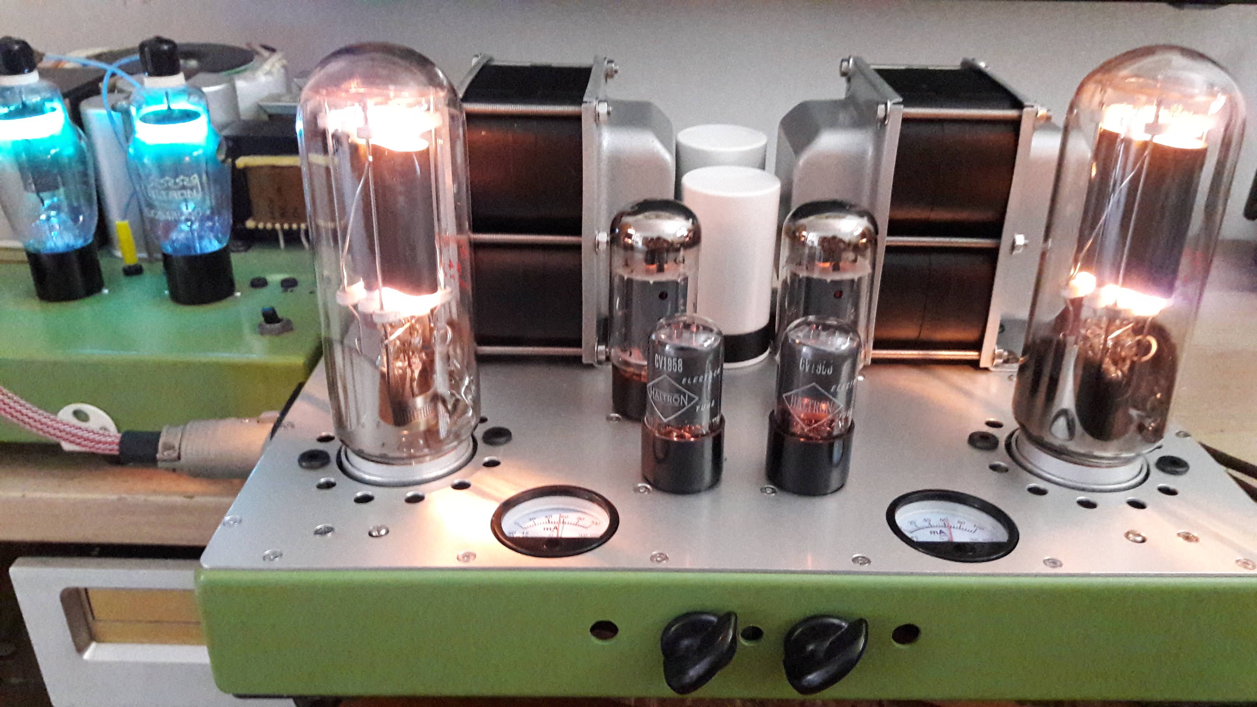

My humble low watter 845 SET, operates at 530v and bias 55mA. Power supply is by a pair of mercury rectifiers DCG4/1000 together with a total 80uf capacitance using only oil caps throughout. Componants line-up are 6N7G>EL34>845>4K7 Double-C>Altec 604-E all for a soothing and delightful listening pleasure.

I don't see a choke or other limiting device on those DCG4/1000 Hg rectifiers. Are they running straight into all those oil caps?😱
That is a great looking amplifier!
And I like the tube line up too, except for the mercury vapor rectifiers.
Please post a schematic.
I have always wanted an SE 845 amplifier, but only with relatively low B+ voltage.
If you are using the EL34 in pentode mode, consider using an OD3 for color, and for powering the screen.
But of course the amp is working well, so do not change a thing.
Enjoy listening.

The fat-boy EL34, is triode wire, separately fix bias at 18mA. 6N7G is replaced with 6J5G or L63. Directly plug-in without re-wiring,and bias with 3x LED.
Do you think I'm really that dumb!?
I drew inspiration from PHILIPS's EL6400 Series of high power amplifiers.
Choke is wired on the negative rail, center tap>choke>grnd.
I believe the amplifier is working, and has been working for a long time.
Right?
Never argue with success.

Zekk,
6J5G and EL34 triode wired seems like a good way to go.
I recently built a push pull amp with KT77 outputs in Ultra Linear.
The Beam Power KT77 is the direct Cousin of the EL34 Pentode.
The EL34 has the Suppressor on Pin1.
The KT77 Beam Formers are internally connected to the Cathode, and Pin 1 is not connected to the tube base.
You already have the Pin 1 to Pin 8 connection on your EL34 socket, so tube rolling is easy from EL34 to KT77. Plug and Play.
The specifications are so similar, I would not expect much change in the performance or in the sound.

I don't get it, what's the big fuss over a choke wired on the negative rail? It's operating perfectly stable and idly silent. But on the other hand, nothing is perfect in this world.
I copy from Philips Holland's design for their EL6400 Series of high power amplifier. I do not follow blindly what those guy's judgement based on man-made equipment, calibrated to suit one's hearing. I trust nature's creation of my ears, giving me the power of listening.
Better read this, you may still have created a problem in your amplifier system.🙂
What's there to read? If the prevailing situation have no problem, don't look for problem.

You're absolutely right, 6AsUMMER!
My contribution here is partly to share and rejoice that this cheapie Shuguang 845 costing merely $130 a pair can be that good. Previously, I was scare-off by that 1kv B+, until I read about low power 845 SET in MJ Magazine. My Tele EL156 costing $450 a pair cannot even comes close. It's all about what separates the boys from the men.
