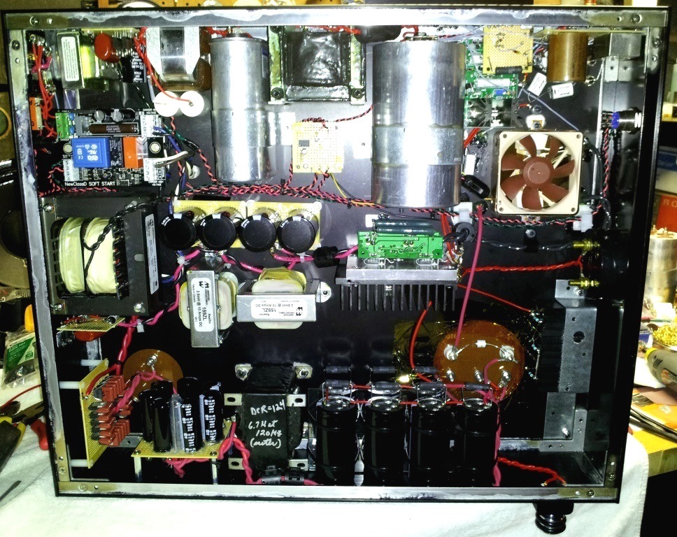

I used a shunt regulator board from K&K Audio in the cathode of the 833. I built a simple regulator for the other one - the schematics are all in the Midlife Crisis thread if you read through it, including the power supplies, which are quite hefty at such high voltages.
There is a lot of stuff in the box when completed! See attached pic of the underside of one amp.
That 540H choke is a grid choke from Lundahl. It gives a very low DC resistance to stabilize the 6E5P operating point while also presenting a high impedance to the signal AC. A bit of a luxury vs a resistor, I admit.
