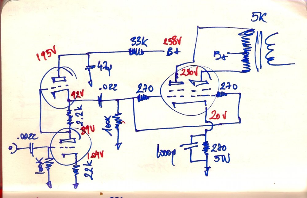

This the one I just finished.Comments and critics welcome!
I´m sure it can be improved,although it sounds great for know.

You show 270 ohm to grids of the 832A (as stoppers? I usually think of 1k-1.5k for stoppers...). Do you mean as stoppers to the 6SL7s? I see no stoppers there, just grid leaks. Or do you mean grid leaks to the 832As? Also, the 6SL7 cathode bias isn't bypassed. Is that correct?

I´ve changed the grid stoppers to 1k,bypassed the cathode resistor from 6sl7 with 200u.(because I had one lying around)
Two options for grid 2 of 832a:
1/a 100ohm g2 resistor reads 250v,234v to plate,21.9 at cathode.if my maths are correct I have 81ma=17.2w plate dissipation
2/10k g2 resistor reads 215v,244v to plate,18.8v at cathode.69ma=15.68w.
the data from 832a shows different max ratings but I´m a bit lost at that point.

Hi gja,
Your schematic seems incorrect. Two obvious points:
1- no phase inverter for push-pull operation.
2- no drive to the screen grids.
Maybe correct and re-post for clarification.
Regards, KM
I wondered about that too. I've seen threads about people trying to run the 832A single ended, but that hasn't worked at all.
No "seems" about it. That schemo can't work since the plates of the finals are in opposition, and will null out. The only signal you'd get would be what little got through due to final/OPT imbalances.
Looks like he fouled up a schemo for a SE final, with the dual tetrode sections paralleled and pseudotrioded.
In addition, I'm curious as to how the driver stage is supposed to work. The lower tube has a cathode current of some 0.47mA, while the upper tube passes about 1.3mA through its cathode. The voltage over the 33k resistor suggests that the ensemble somehow draws about 1.9mA.
gja, what are you trying to achieve with this circuit? Why wouldn't you just build one of the circuits in this threads that are proven technology?

Coupling cap and input cap values seem awfully low to me too... But I'm curious about a built version sounding good. Miles' comment about the finals seems right to me, though I'm a bit weak on the fundamentals. Sure seems like it's kinda push-push, and couldn't really work.
So that has me curious. A working prototype based on a schematic that can't work? What's wrong in this picture? I'd love to know.
