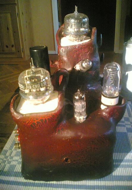

adalin said:
I just finnished a new chassie for my amp and hopefully all the pieces will fit in it 🙂
I use the PC connector style for my anodepins, it works pretty good

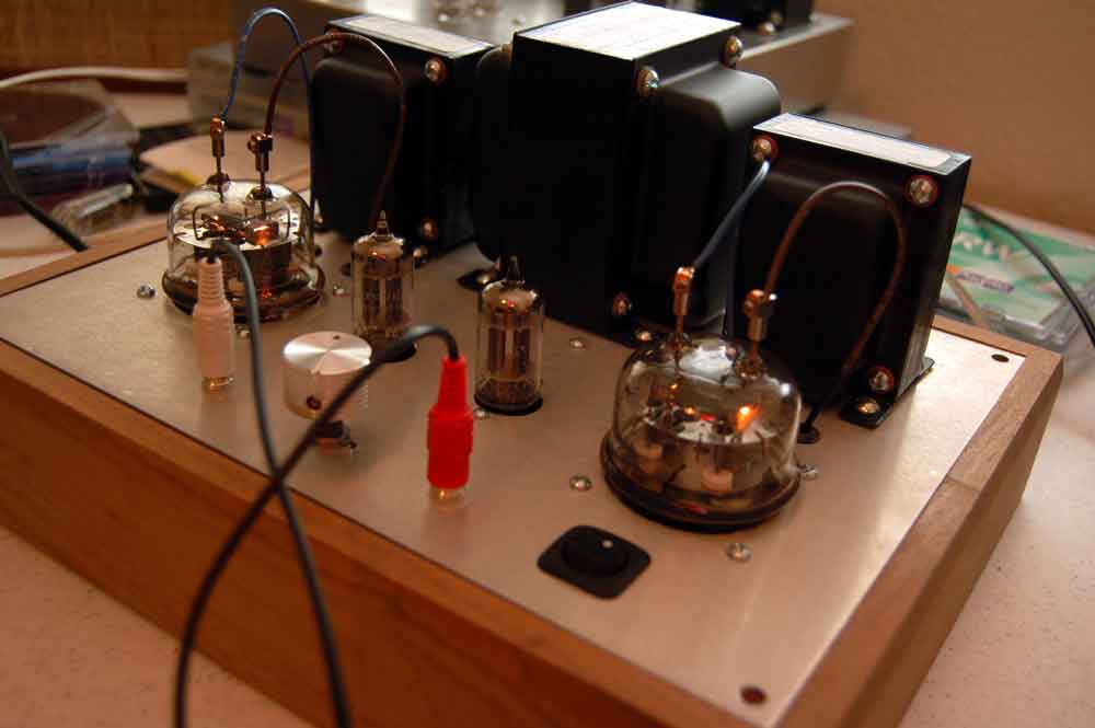

Hi Fellows,
Picture of my 832 amp is below. I used the Audio Hobbyist design and it works quite well. I have not hooked it up to my distortion analyzer yet but it sounds exceptionally good. Very open and plenty of punch. I used some slip on connectors from a terminal block for the plate connections - from a Phoenix terminal block.
Hi Arnold,
Well, I guess most people would insulate them. But I have no kids, no pets, no spouse and my girlfriend knows better than to touch those leads, so it's probably OK. It works for me but it might not work for everyone. Safety first and it is important.
The amp sounds great and I'm quite happy with it. The 832's work quite well. The plates glow just slightly red, which is how I like it. I did not put blue LED's in the bottom. And those are Hammond 1608 OPT's.

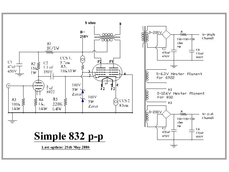

I design and build a low power Simple 832 pp not too long ago, sound bright, open, punchy and its nothing close to sweet to me.
Just watch out for the Screen Grid current. And since the cathode for the 2 beam tetrode are common, I have no idea as of how to balance the 2 plate currents.

arnoldc said:
Shouldn't you put some insulation on those horns? 😱 😱 😱
