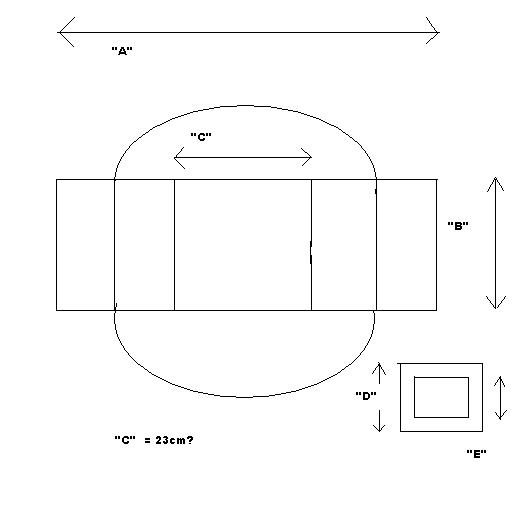

I've wound a 10k:4 OPT for a 813 triode wired SE amp capable of approx 35W.
The core is approx 23cm2 and there is no signs of saturation.

Richard: the core is 23 square cm. The "C" in your scetch is 45mm and "B" is 52mm.
/Olof
