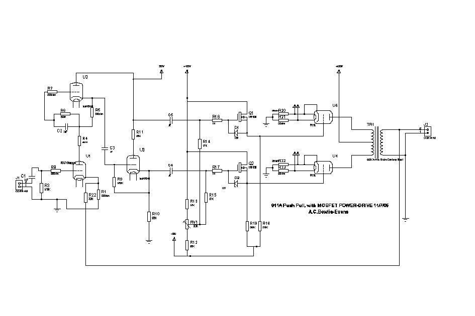

811A P-P design
I eventually built a 811A on P-P, and used MOSFET drive as in Tubelabs Power-drive ideas. The amp sound amasing, even uses AC on the heaters of the 811A's and with careful tweaking of the cathode circuit has bearable hum!--I wanted to stay away from DC heaters as the tube's cathode/grid bias will be different along the length of the heaters, as well as the possibility of that odd phenomenon that causes the heater wire to alter its diameter from one end to another over time with eventual hot-spots and failure, (Or so Ive been told)...............
Bags of power to spare, and the MOSFET drive means the idle current is dead stable, Ive set it at 50mA per tube, and running 420V anode--I have run the breadboard now for a month or two, and really should get on and make up the finished Stereo version......
Ive used MOSFETS to drive the 811A tubes, as I didnt fancy the non linearities which can be present with a tube cathode follower arrangement--Seems odd looking at the post above to see a KT66 as a driver tube, but Im sure the KT66 has guts to spare for this job!!
Im using some cheap output Tx from Maplin, with impedance of 7K A-A, and considering its such a small Tx, Im surprised at the power!--I havent tested its power bandwidth properly, It just sounds great!

Power-drive
The scheme Im using follows nearly exactly the Power-drive scheme, except for a few cct value changes to suit the available voltage supplies I had available from my mains Tx Ive also added a zener for protection to the MOSFET S-G junction. Its voltage is 12v half watt type.--I had an earlier failure caused by gate-punch through, when I changed a pre-amp tube without shutting down.......
Im driving the power-drive section from a conventional resistor loaded phase-splitter and not the CCS loaded design part as in the original Power-Drive scheme.....
--Nice and easy to set-up the bias, just adjust the bias-pot and forget it--Its VERY stable even after many many hours use/abuse and with those new unused Chinese tubes, I got off fleabay especially to mess about with it .............
Im currently working with +150 and -50 volts for the power-drive rails, and have values of 2.5K from 811A grid to the -50 V rail and a MOSFET potential devider made up from a 20K pot with a 47K to the +150 rail and a 22K to the -50V rail and apart from the addition of the zener, Ive used the power-drive basically as-is.
Use a fair sized heat-sink for the MOSFET's or say, an old Pentium processor heatsink--Run the fan from a rectified 6v heater supply and youll have a nice cool MOSFET's and no fan-noise.--My current breadboard set-up for heatsink, holding both MOSFETS
Currently, my P-P has only the one bias-pot potential divider supplying both the MOSFET's driving the pair of 811A tubes. There is only a difference of around 3mA between the tubes idle-bias and these were not bought as matched tubes--Maybe Im just lucky here...............
Ive tried adjusting the bias point, and anything above around 30 mA sounds good, Below this and you definately start to lose something...................
Due to the fact its a source follower design there is near total transparency, you dont get any 'sand-sound' from it--It seems an ideal option to the usual cathode follower set-up to drive the 811A. Plenty of drive-current for those high transients! I would really recommend you give it a go--It really does wake up the amp!

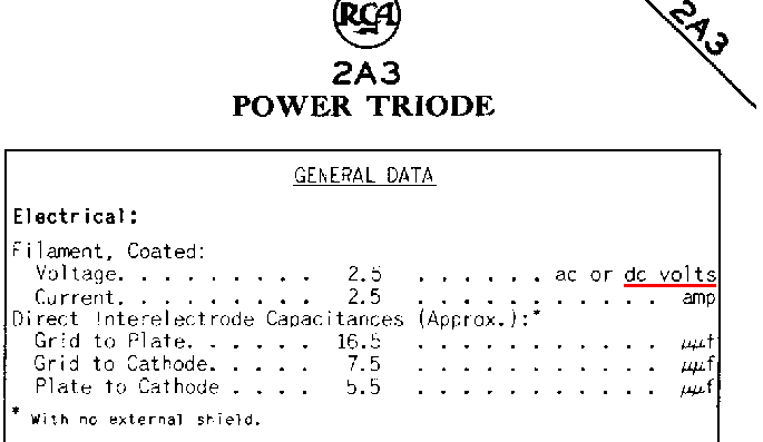

"Most of these old directly heated valves were never designed for DC heating anyway..."
Spec sheet (attached) says otherwise.
