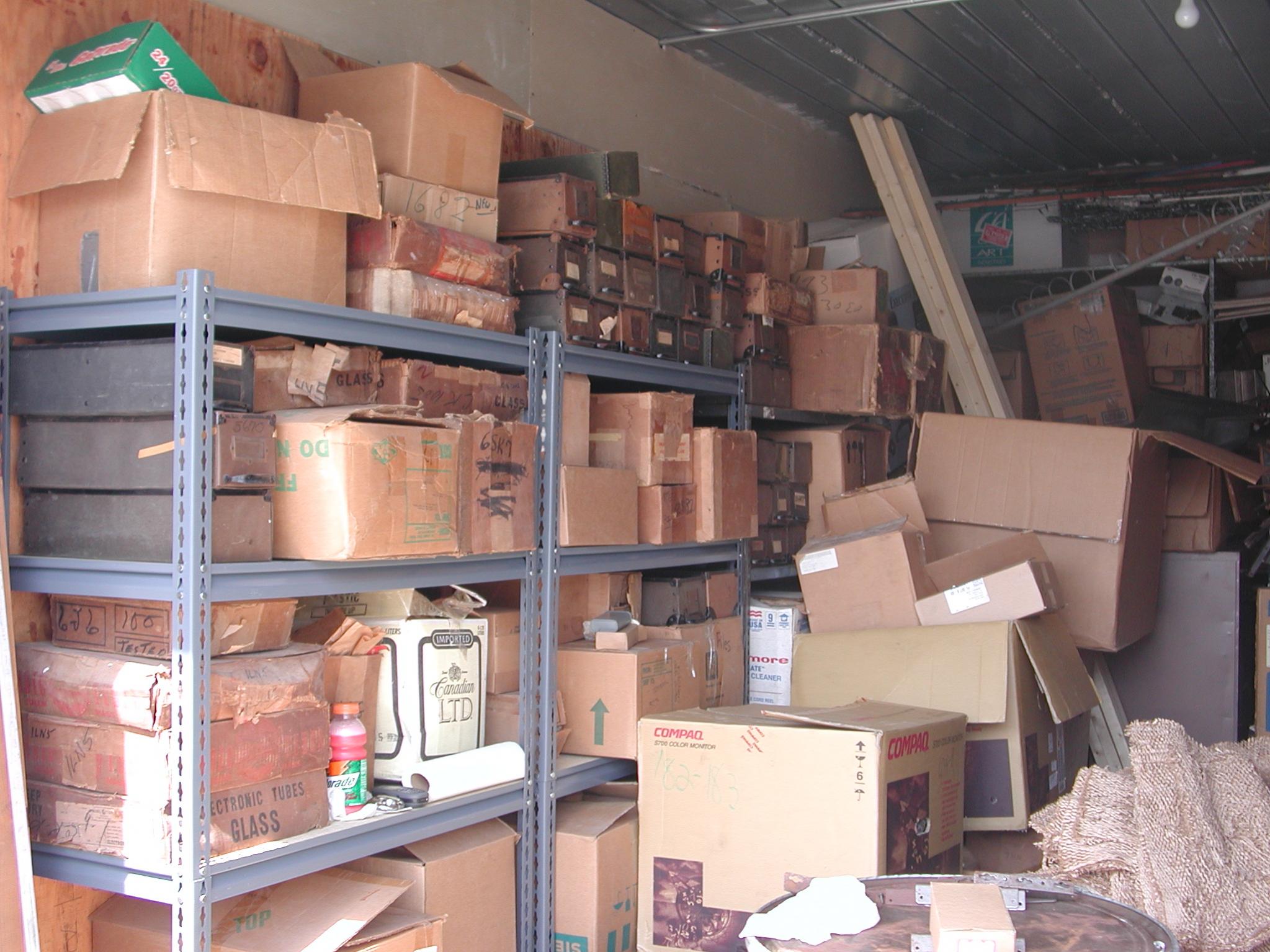

Now we have a house full of "stuff".....Sherri is not happy about it. I enclosed 2 pictures from about 5 years ago when we still had #1 and #2. I was in the process of building a loft to allow 2 layers of "stuff". A lot of the "stuff" I was given came from a collector of vintage aircraft and military electronics. Note the 1937 postmark date on the box from Douglas Aircraft. It contained some tubes.
