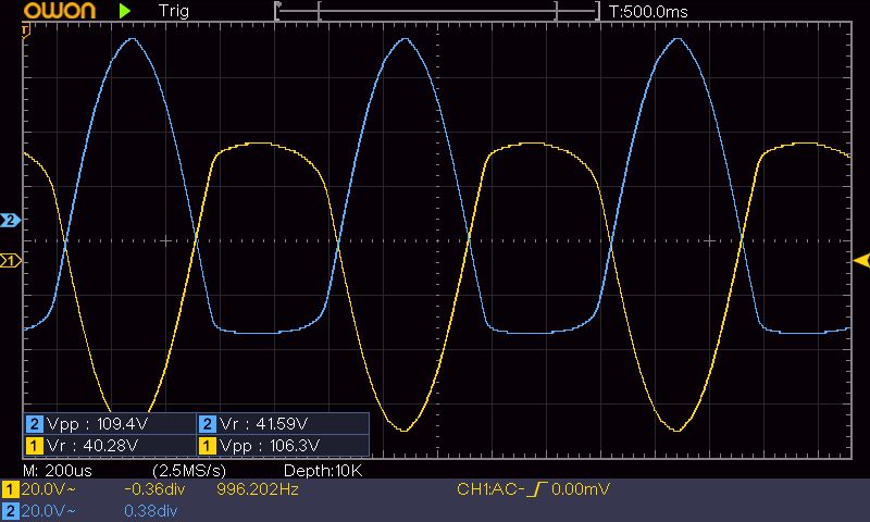

Since the sims show that 16W output is expected for UL there may not be anything wrong with your input or driver stages. Could it just be that the designer advertises peak power (aka music power) rather than rms power.
Does each grid waveform clip symmetrically at both top and bottom ?
Do you want to try and sketch a loadline for 6SN7 triode and estimate what the Vpp should get to at on-set of clipping, given the B+ voltage and cathode voltage for the splitter stage.
No, clipping is not symmetrical.
I can try do this drawing, but as bohrok2610 wrote, I am afraid that it is waste of time to do anything else. But if you can help, I can do that, I will learn something new 🙂

I would expect the 807 g1 grids to conduct whenever the grid becomes positive with respect to the cathode (at that point they will clip).
(Each 807 g1 grid will only clip in One Direction).
Is that what I am seeing in the graphs in Post # 30?
If so, that looks normal to me.
When you change from Ultra Linear to Pentode mode (Actually Beam Power mode), the grids will clip at exactly the same drive voltage (same grid g1 to cathode voltage).

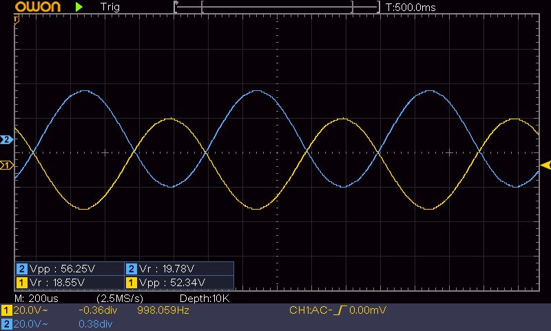

Nothing is 'clear' from the results you have shown imho, and it would be a waste of time to think that any testing that you haven't done so far is a waste of time.
Based on only one marked up schematic in post #1, I will use that for assessment. A bogey 6SN7 with a per triode loadline of 47k, and Vak max of 295V - 113V = 182V, and 0V crossing of 182/47k = 3.9mA, has a Vgk=0V limit of Vak=40V. So triode max Vpp swing is 182V - 40V = 142Vpp. The centre idle is circa Vak=110V, or 110+113 = 223V relative to 0V - which is a bit higher than the 196V shown on your circuit diagram, which is likely due to hot biasing to alleviate cutoff region distortion. The indication on the schematic that Vgk=123-113 = 10V at idle (2.1mA cathode current) is suspect.
Your results in post #27 indicate less than 60Vpp swing. The clipping results in post #30 indicate about 110Vpp. Biasing for better symmetry may get you well beyond 60Vpp before onset of clipping.
That doesn't stop the output stage from having issues, but at least you allow the first 2 stages to perform without getting in to clipping, and so ease the job of the feedback.

#30 shown clipping on G1 on both 807, but 807 are removed, and FB disconnected.I would expect the 807 g1 grids to conduct whenever the grid becomes positive with respect to the cathode.

One more time, I check all DC voltages on 2 firsts levels. Everything matched, only B+ for 6SN7 is 320V.
I try to draw on paper your number, and will see. Thanks

If the g1 signals on the 'missing' 807s (807s removed) is clipping then that is the drivers or input tube clipping.
The clipping appears to be at about 20V. If the 807 g1 to cathode is -20V, then you will not get more output with the input stage and drivers (unless the alternation is in the other direction [the larger alternation] drives the 807 grids more positive.
Oh, the 18 or 20V was your Post # 27. But that is just before the 807s draw grid current.
