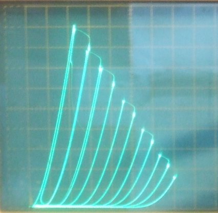

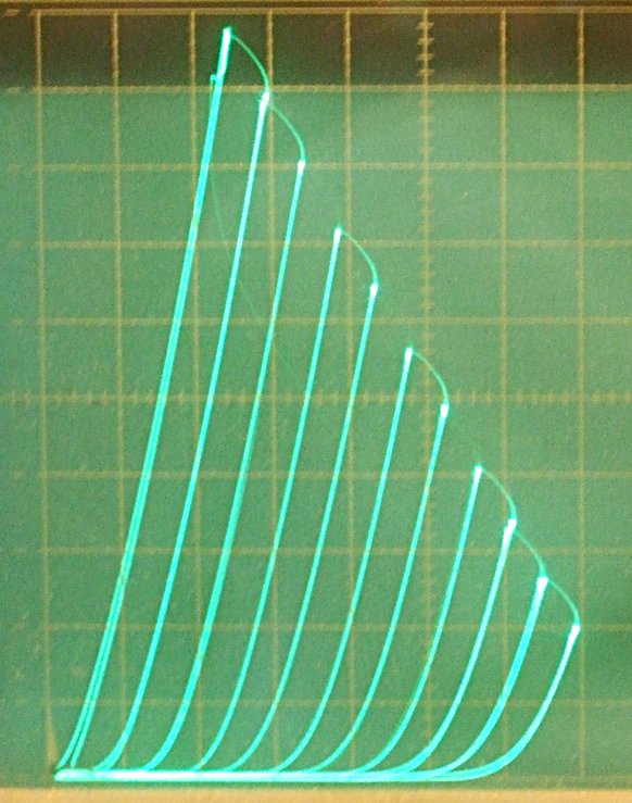

6HJ5 in triode? Not real special in triode, some curve roll-over.
Try 26LX6 or 26LW6 for super triodes. (not that they will work for long as triodes, suffer run-away at HV in direct triode mode over time)
The Sweeps need a screen V drop or an R divider with a Mosfet follower to get the screen V down some for psuedo-triode.
Might be interesting to parallel a pentode and a "shunt Schaded" pentode (or beam tetrodes...) to make the "extended" class A version.
Dunno, looked great to me. But I'm only interested in the lightly loaded juiciest bits. "Watts" is a much misunderstood figure of merit. Just me, of course.

I would say 6HJ5 is typical in triode mode for Sweep tubes, certainly OK. (pic 1 below)

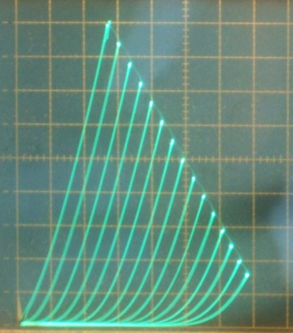

26/36LW6, 26LX6, 36MC6, 12HL7, 6LQ8, some 6JC6, and many others make some amazing triode curves. (pics 2 to 5: 36LW6, 6LQ8, 6197, 12HL7)
(often depends on the make, and then some selecting on the curve tracer)
