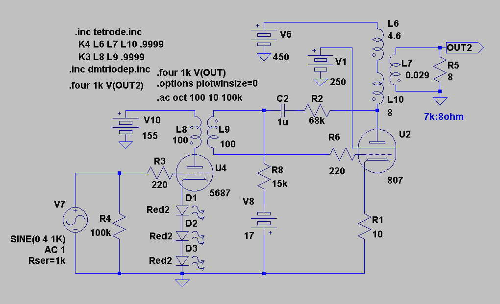

Hey Joe,
The UL version with B+ 300V will leave you with ca 4W. If you go tetrode at 450V/250V you will get something like 8-9W. This is what it could look like. R2 may be trimmed. Also 5k/7k can be tried.

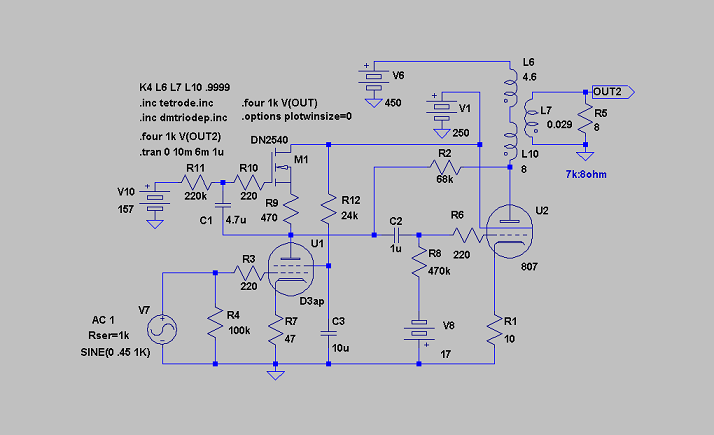

If you want superior performance you should skip the triode/IT and go for a high-Gm pentode like D3a or E280F. The 6AU6´s you have won´t do as they are far to unlinear(distortion-cancellation doesn´t help) with a heavy load like this.

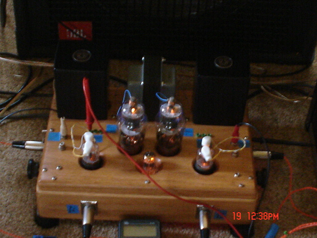

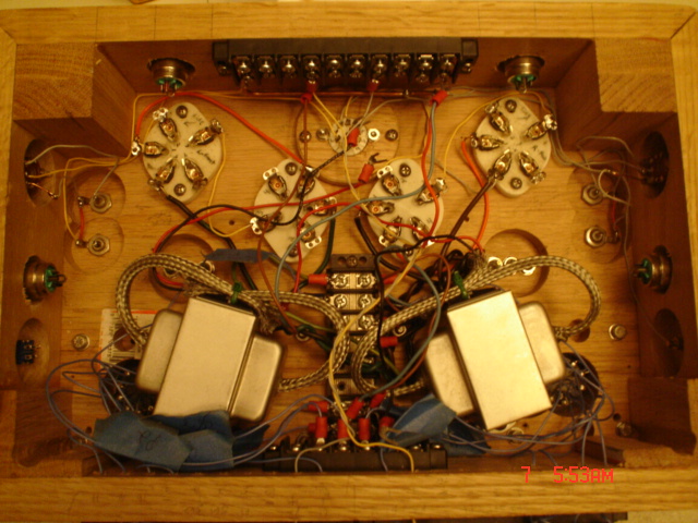

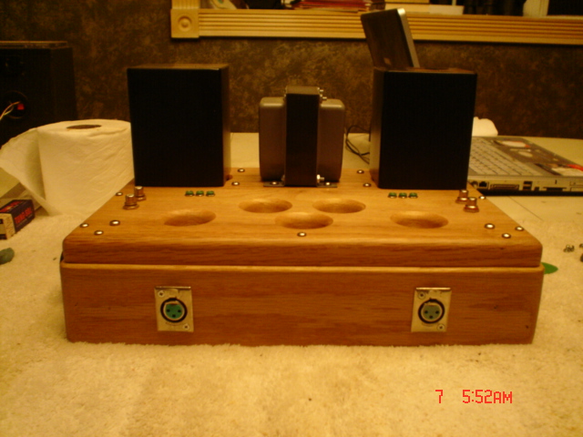

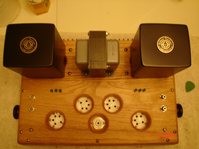

Superior performance ..? I am allways game for such a thing for the small $ involved of the changes. I would have to find some D3a or E280F. I have the heaters wired up in this chassis allready in series because of the 12.6v filament tranny in middle of pic but can easily change it around for a pair of 807.Main PS will be outbourd anyway. I can save my IT's for another project as I have other SE OTpairs about in closet. Main reason going 807 is I like 6l6 family tubes for sound + allready have them & trying to get away from 300B as my PP 300B amp ran away not long ago & I refuse to retube such expensive outputs. 807 still cheap for some reason. Can you expain why the D3a non IT version would out perform the 5687 IT version..? Thanks for the large amount of help indeed. Just so you know I am not just dreaming here is a pic of signal chassis .
Joe
Wow, that looks nice. Maybe you should go for 5687 anyway as the chassi already is done.
A possible explanation: D3a is more linear and the unlinearity that is left might be the same style as the 807, thereby canceling the 807s.
But it isn´t sure you like the D3a better. It´s up to you to decide.
My schematic might need some fine tuning but that is up to you.
