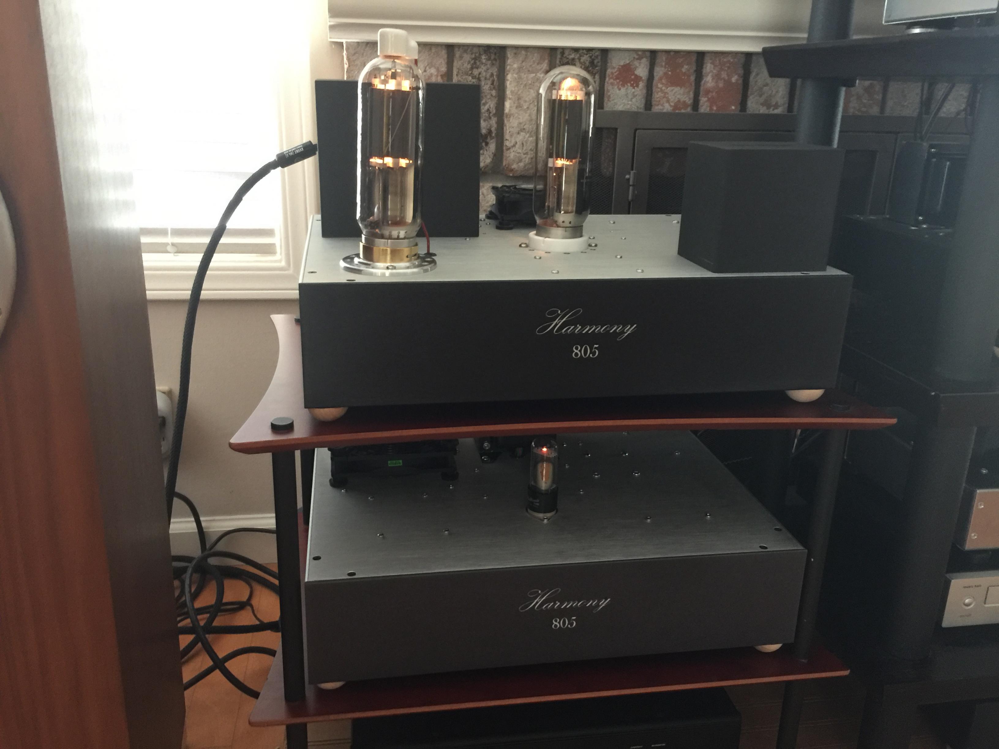

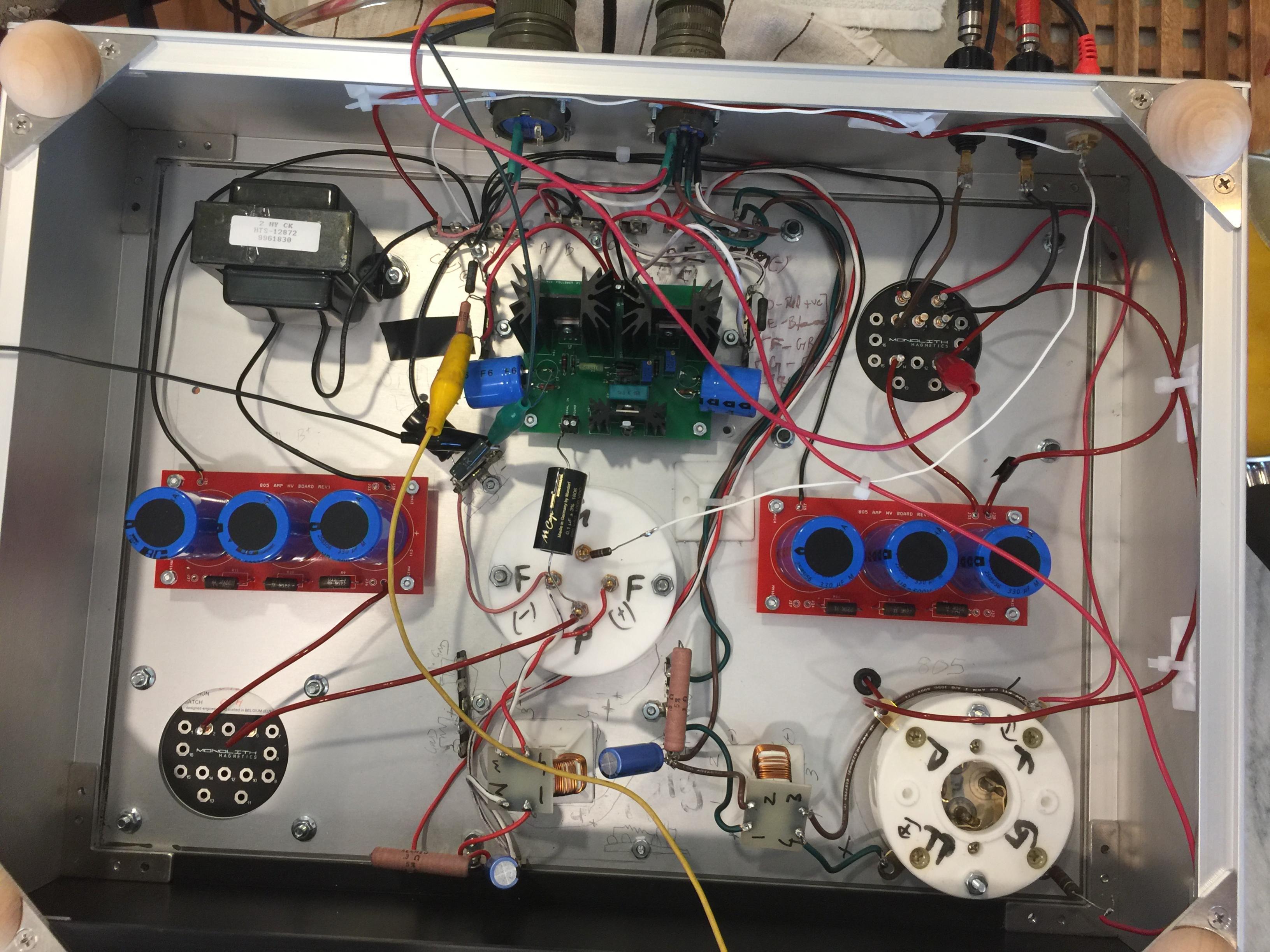

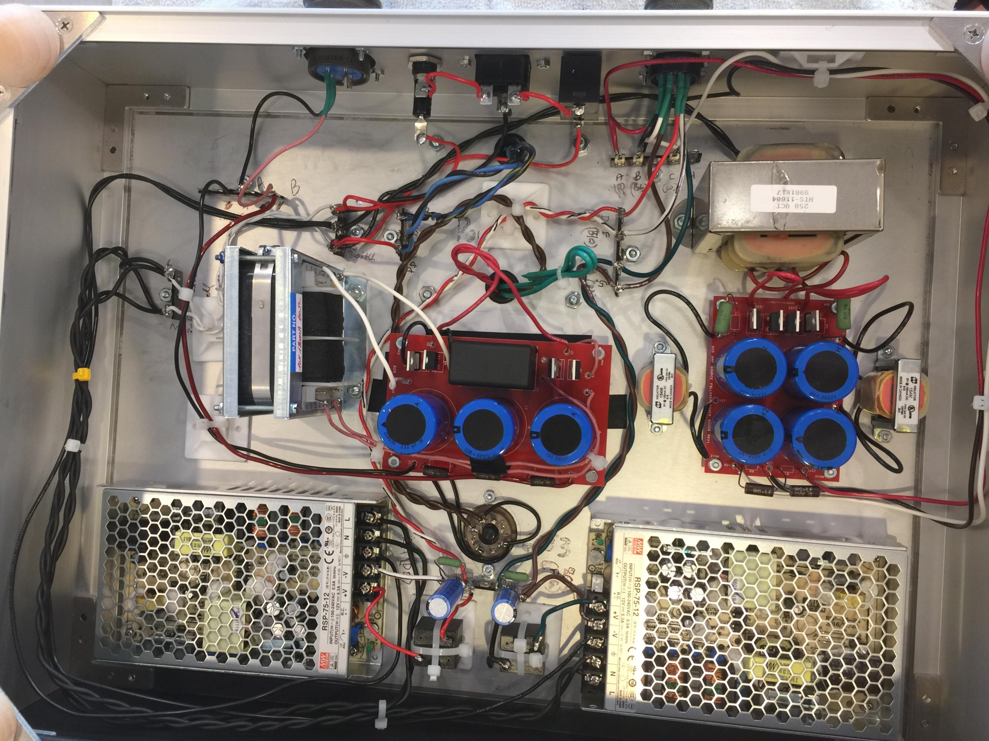

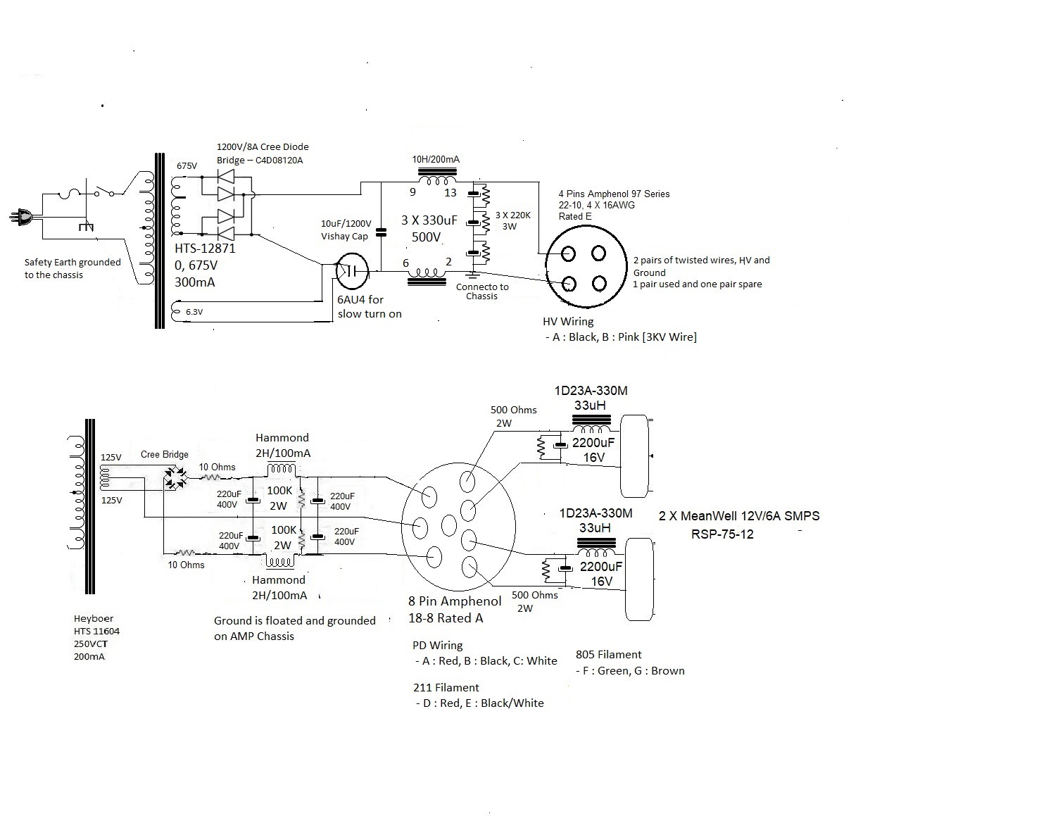

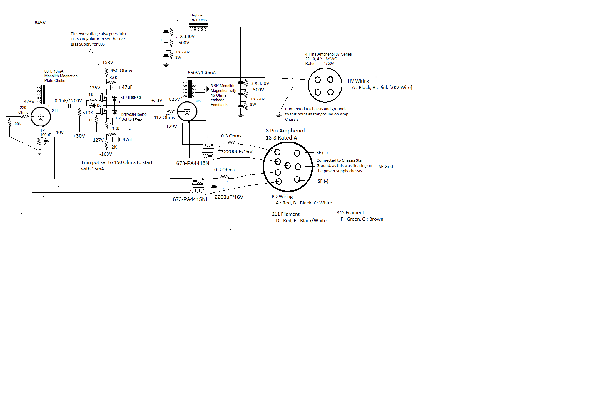

Hi I just finished a 805 A2 amplifier with 211 as a driver with a mosfet source follower. These are mono-blocks, with 2 chassis per monoblock, one for power supply and one for the amp. Attached are the schematics and internal construction pictures. The plate chokes and output transformer is from Monolith Magnetics, chassis is from Landfall, power transformer is Heyboer -- all great folks to work with! Amazing sound that is effortless, with deep and wide soundstage. This replaces my 811A amp that used similar source follower circuit and meanwells for the filament supply with 6E5P as the driver
Thx
Sridhar
The choice of 211 is purely hedonistic :), I have always been wanting to build an amp with a power tube as a driver. I don't think you need that at all. You can do a similar two stage with a high gain tubes and constant current plate load and cap coupled to the mosfet source follower. Tubes I would have used if I went that route to build are
- triode connected C3g
- triode connected 6E5P
- Triode connected 7788
- Triode connected C3m -- may need a preamp
- 5687 -- may need a preamp
- etc

These days, there is no better choice than a power MOSFET source follower, especially for these RF power triodes that pull some major grid currents. It's not so much of a problem for power pents in Class *2 as the grid currents are a good deal less -- about an order in magnitude -- so a cathode follower grid driver isn't overloaded.
Power MOSFETs have rd(on) ratings of single digit ohms, so current sourcing won't be a problem. Being such inherently high gain devices, the Zo of the source follower is quite small, making for less distortion when it has to source currents into +vgk (Zo is of no consequence when current isn't flowing).

See this: MOSFET Follies, half way down the page, there is a description. The design isn't difficult since solid state can be designed from formulas, not loadlines. Since these are inherently high gain devices, it really doesn't matter much which particular transistor you use, provided it can handle the signal frequencies of interest.
For source follower duty, what you want to see is a low Crt spec, as this capacitance becomes your input capacitance. In follower duty, Ci is bootstrapped to a very low value.
