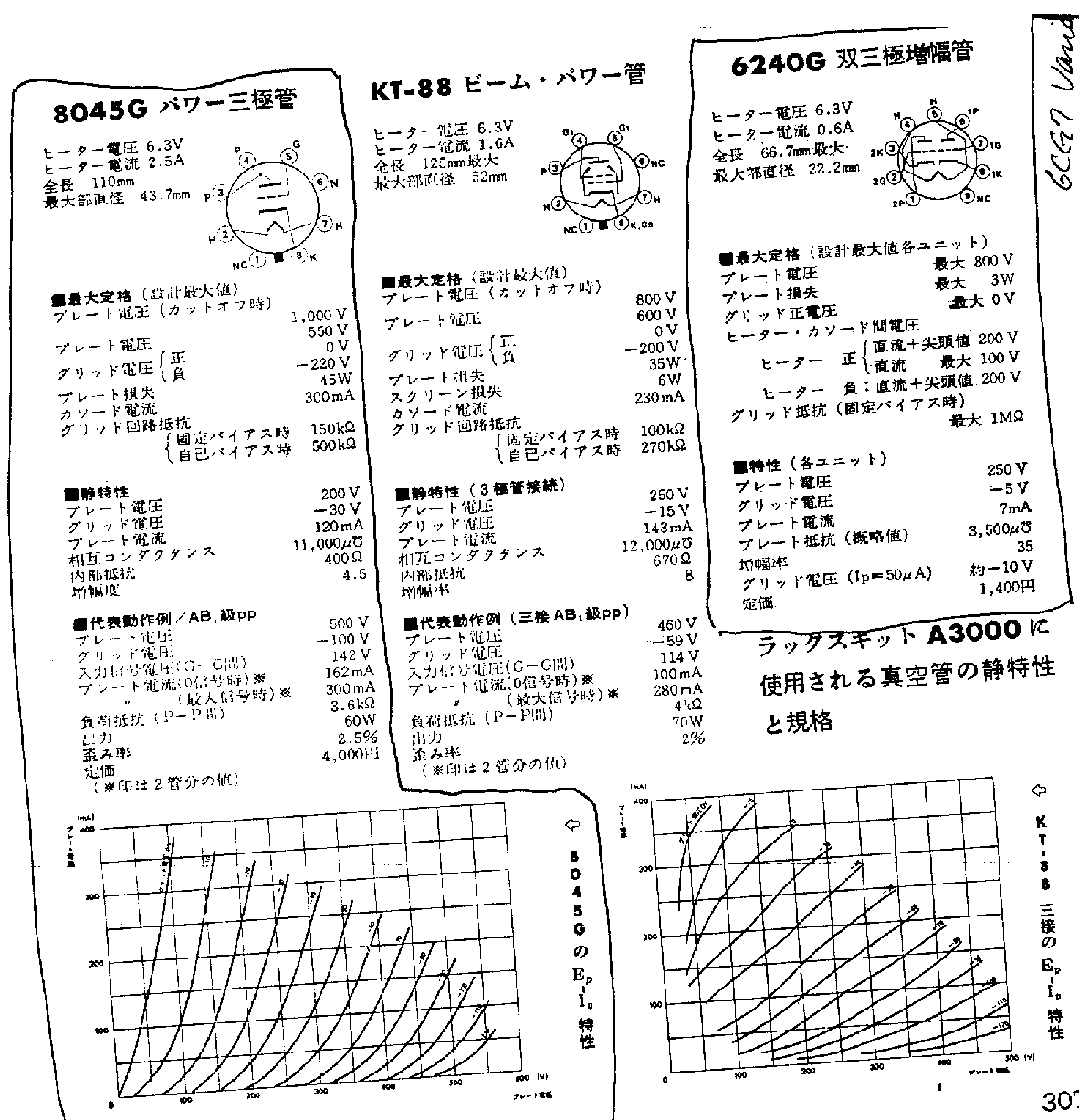

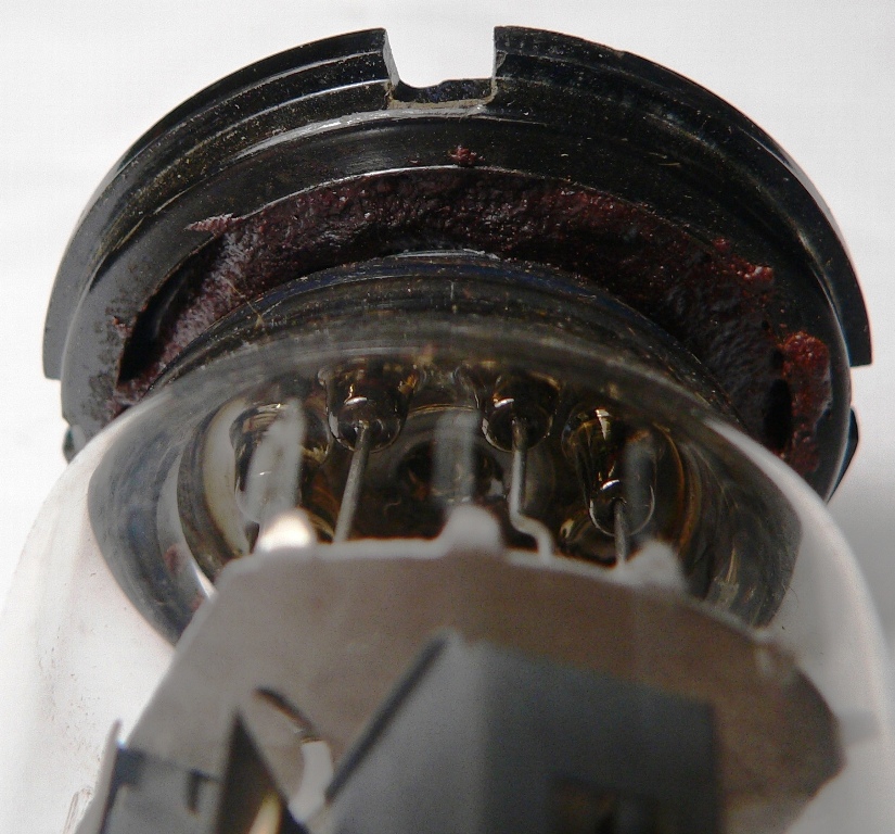

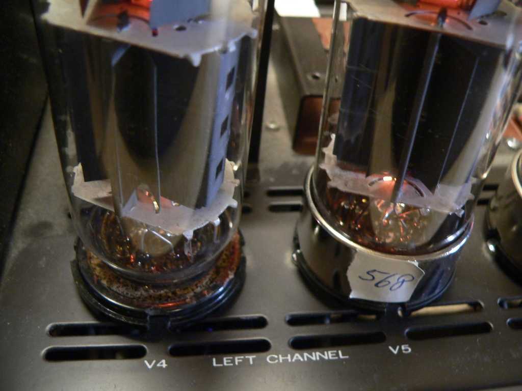

I don't recognize the internal construction of these tubes, but they don't look like the GE 6550's that I have.
yes, compared to the svetlana 6550, these have smaller plates...

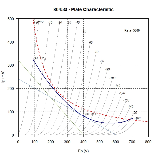

-57V bias is gonna kill the tubes... here is a workable 5k loadline with -77V bias:
you are probably right, i got those estimates from the RCA handbook, i am not looking to use these tubes single ended, like SY, i am a push-pull kinda guy...😀
btw, the RCA tube manual gives -Vg = (Vp x 0.63)/mu
i use this formula a lot when i want to find out which cathode
resistor to use...

Thanks for the pics and info. I wonder how they are able to withstand 1000V peak between the g2 and g1 pins? De-rating them some does sound like a good idea.

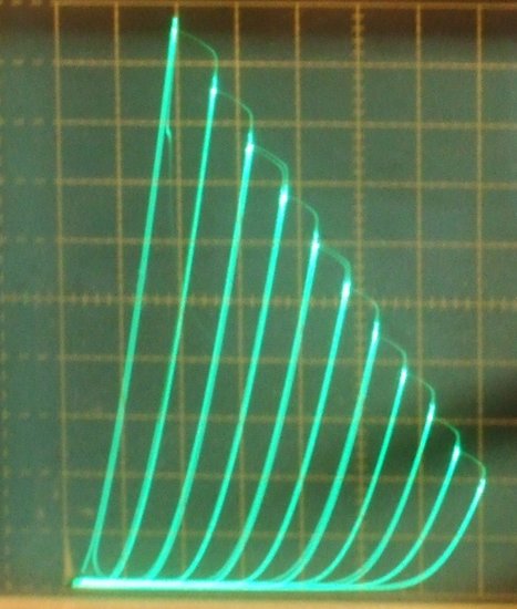

The 6LW6 makes for some beautiful triode curves too (below), but as George mentioned, they can't be trusted in HV triode mode. They like to run-away.

so i think i will run these tubes at no more than 350 volts plate and 60mA cathodes...
That would be very safe, although kinda inefficient - the filament eats 2.5A - much more than the 6550/KT88, plus the heat loss in the cathode... but since you wind your own PT, it probably matters little to you. 🙂
i will make the psu in such a way that i can increase cathode current and plate voltages if i desired it....

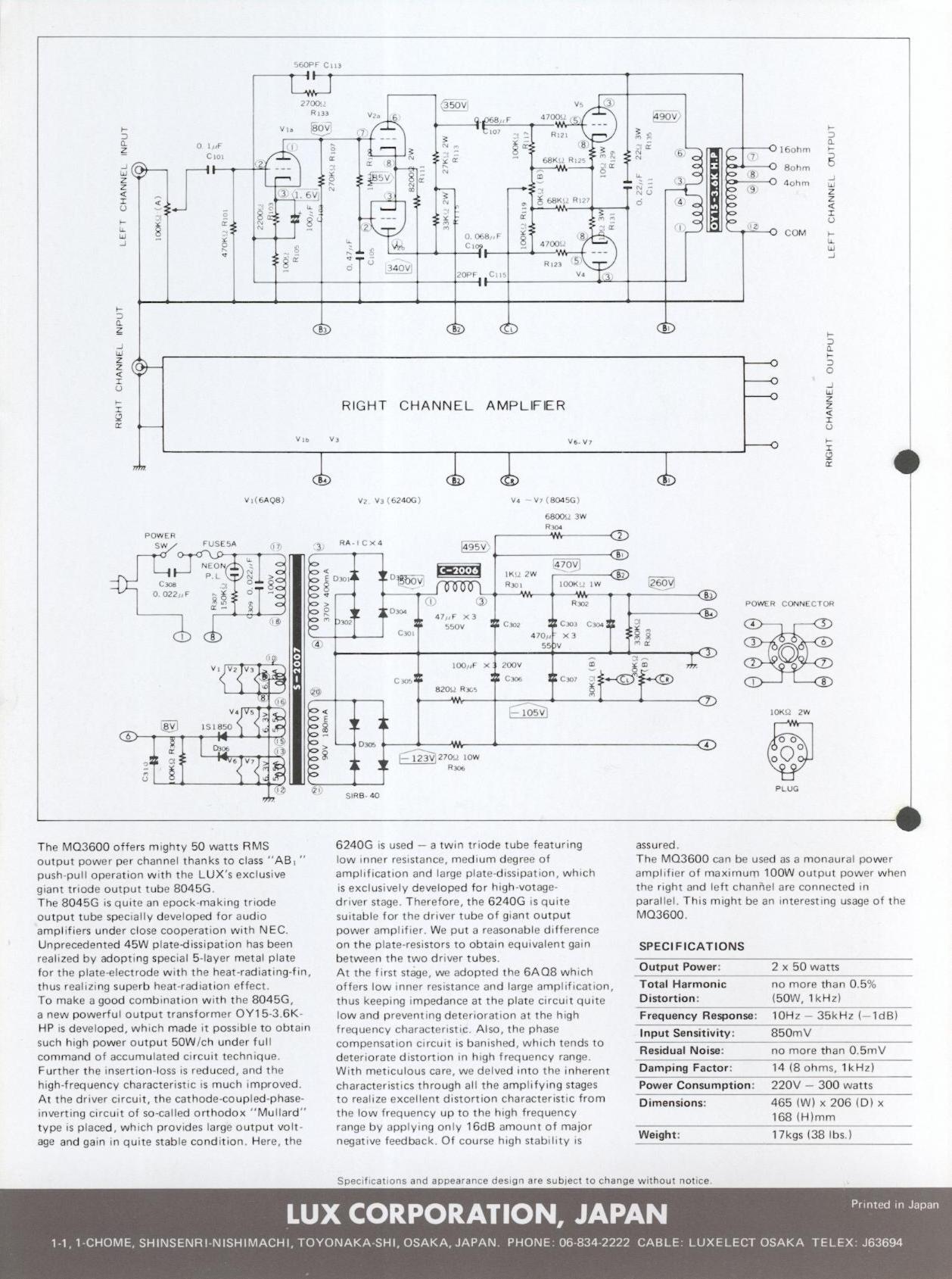

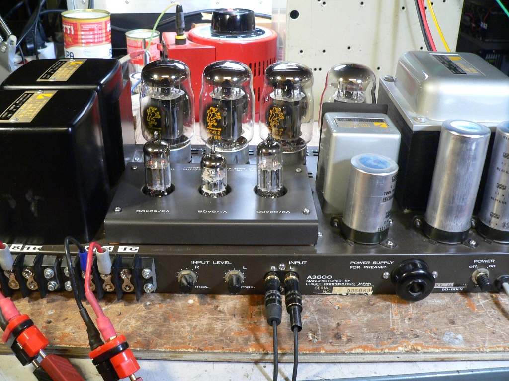

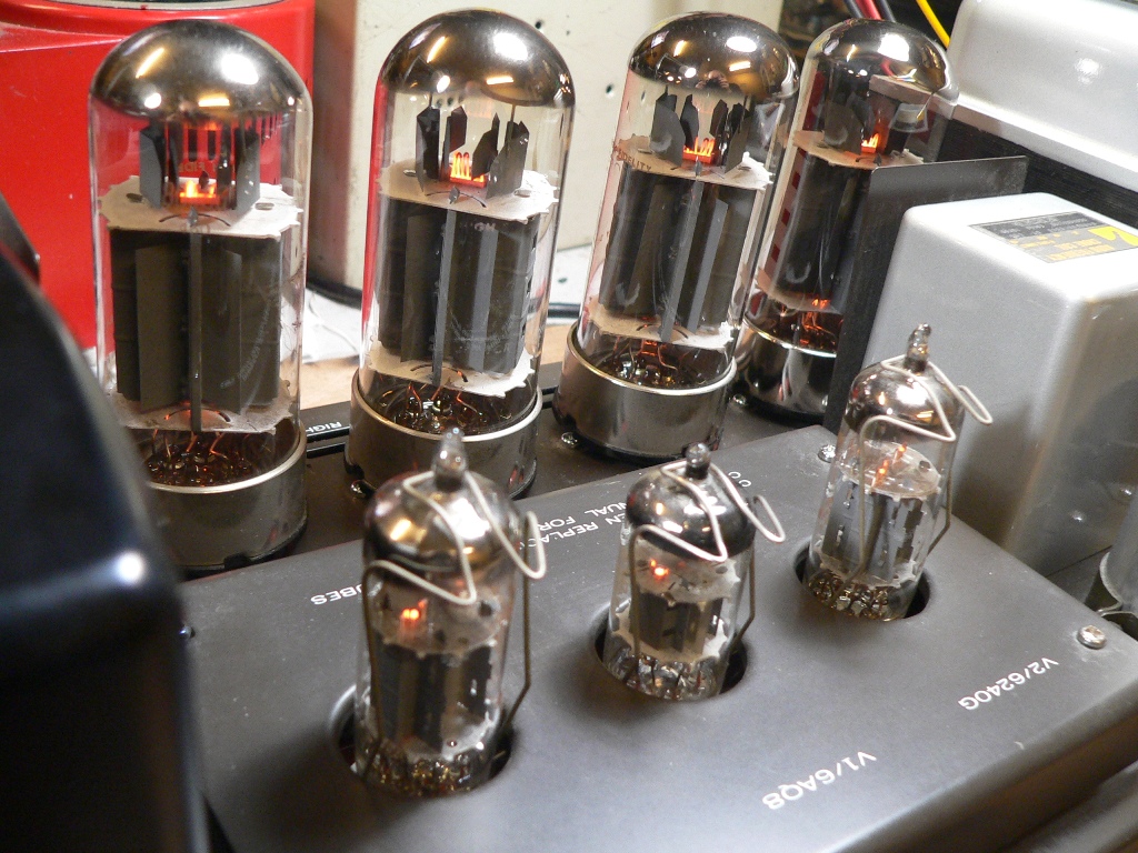

hello
i recently repair two luxmann amp, one modified for GEC KT88 the other was original 8045G triodes.
this tubes are very nice the amp but with GEC KT88 or svetlana C 6550 give 30watts+-
the only modification was lowering negative bias supply and resistor from anode to G2 and something on feedback network.
the original 8045G 50 watts!!!
-grid bias was higer and no G2, triodes.
my customer have 12 of this tubes so i can use the best ones.
i think was made from TV swing plate , i have photos of this beautyfull amps

for info the amps was MQ3600 and A3600
same amps but one can supply pream thts all

8045G is closer to a TV sweep tube. A 6LW6 with a cooler (lower gm2) screen grid. The 6LW6 Mu is like 3.7, instead of the 4.5 (more like 5.0 actually) of the 8045G. Probably a necessary mod. to increase the grid 2 voltage rating for triode use.
Smoking amp is correct the 8045 is based on a sweep tube.

A big sweep with the Pentode Retaliation circuit should be able to give the right triode mu. No worries about over voltage-ing the screens as at idle/DC it is a pentode. AC operation gives some darned fine triode curves...set the mu with the right FB resistors.
