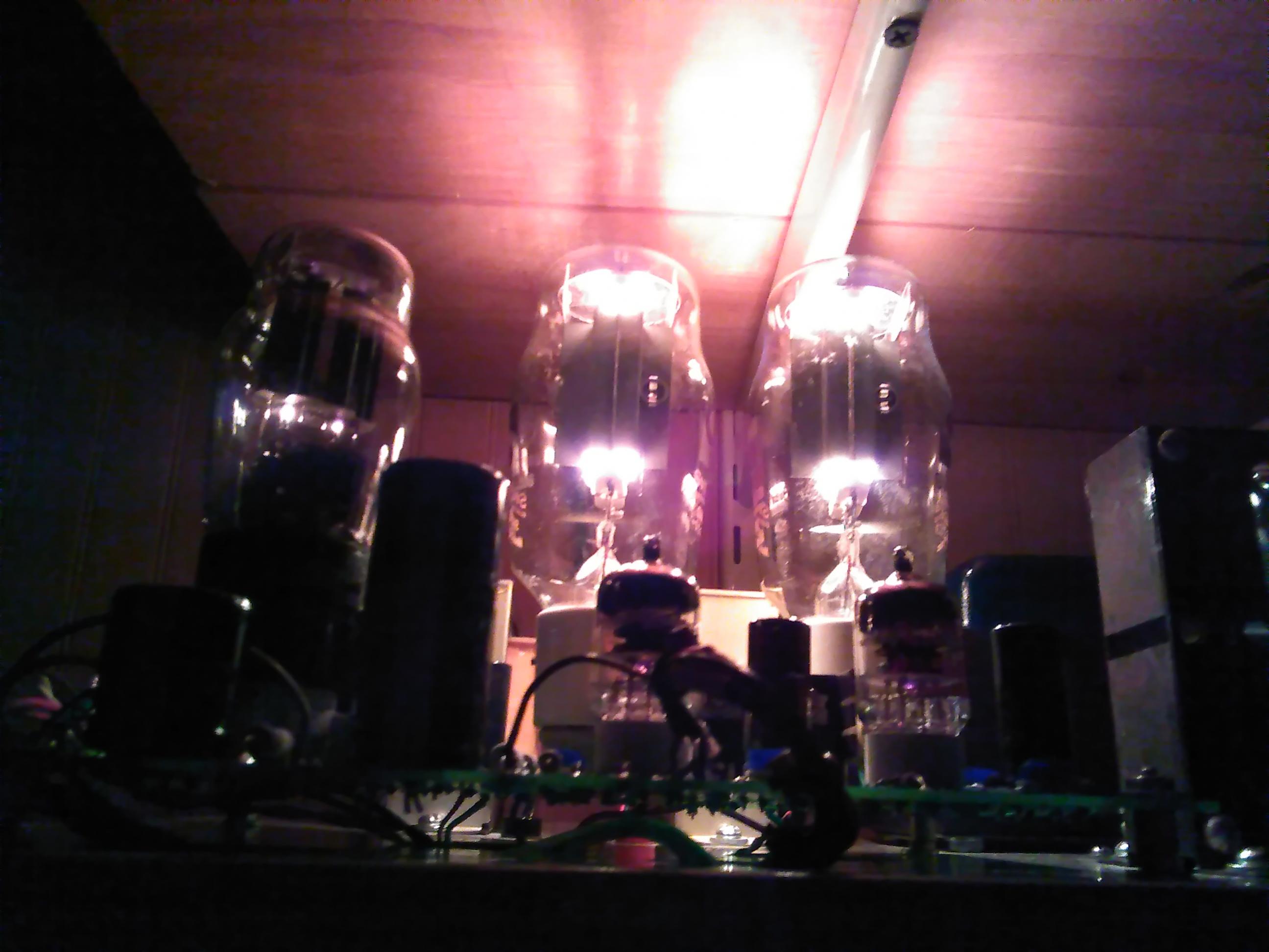

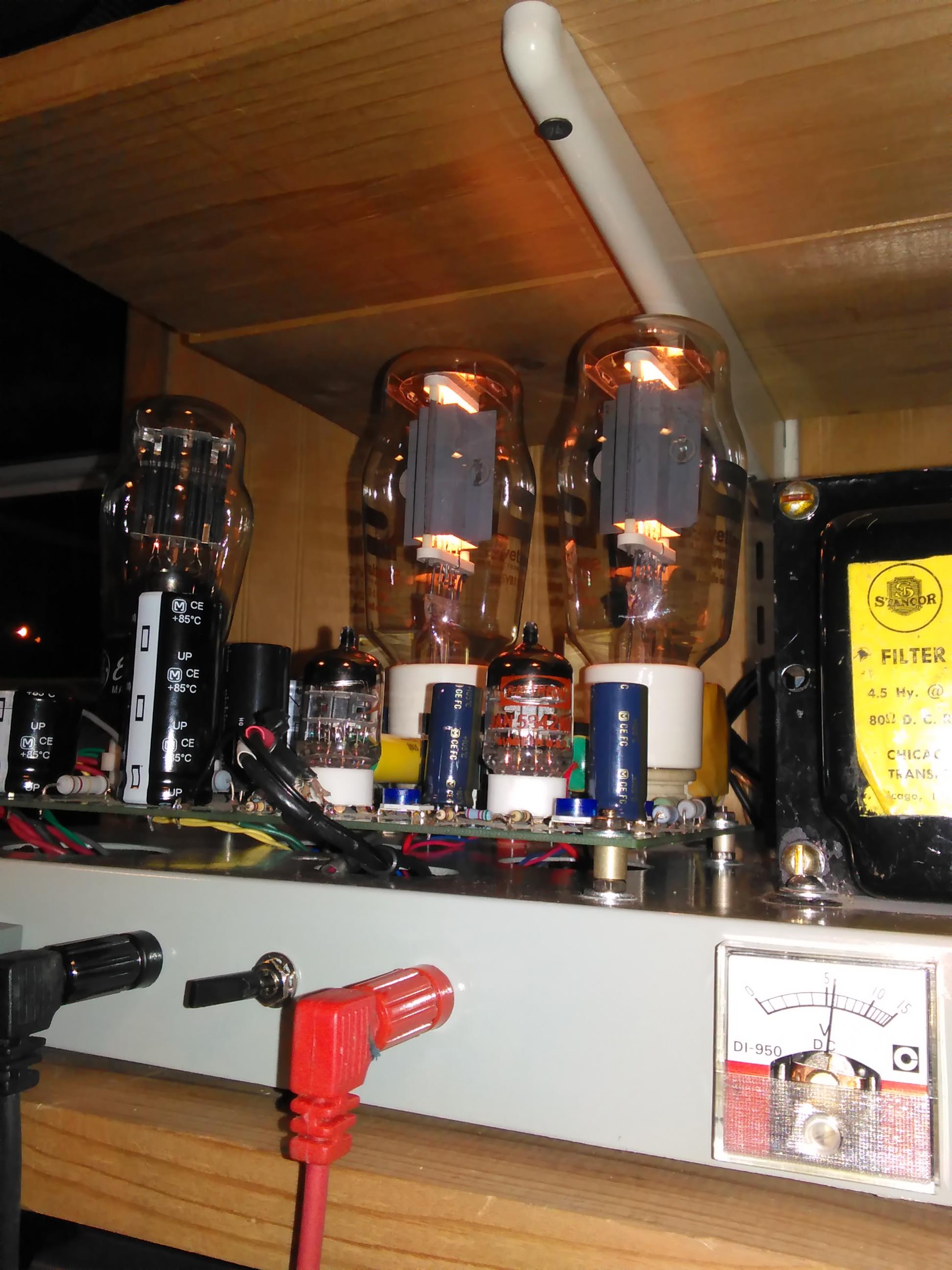

But, on a positive note, here are the SV-811 cranking away.
This also shows the metering I settled on: I replaced the ammeter with a voltmeter reading the voltage on the 7.5 volt line; and added a couple of banana jacks on the front panel - the switch toggles between the two channels for reading plate current on the power tubes, and also lets me read the B+.
I whacked some HF probes in half to make the right angle connectors.
The volt meter has already come in handy, darn it.

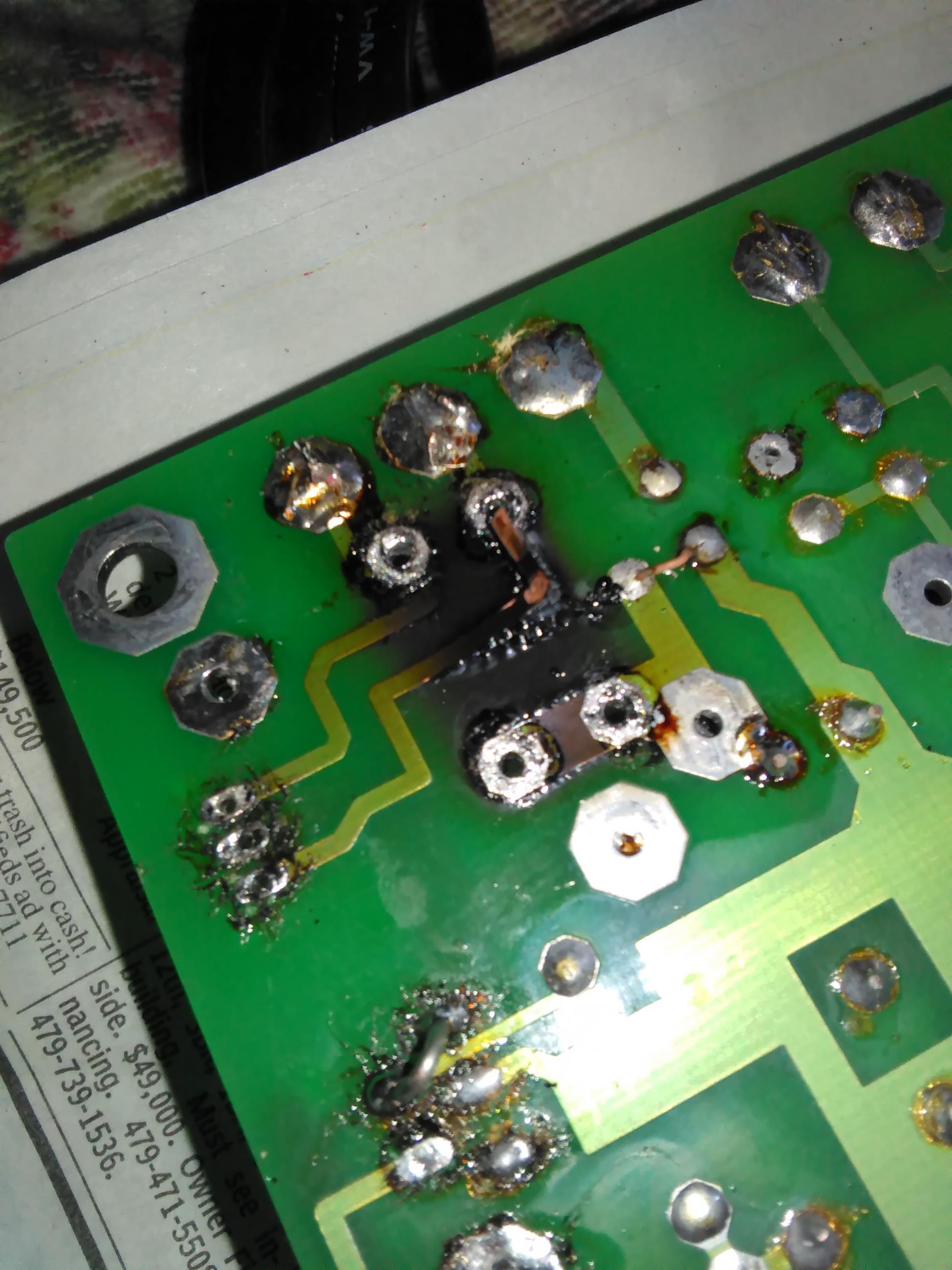

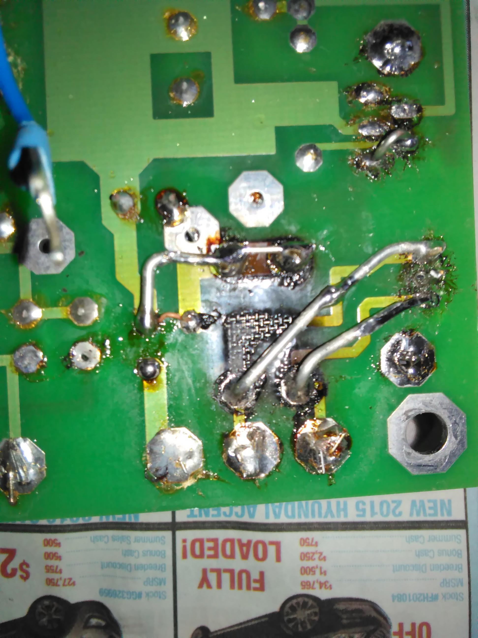

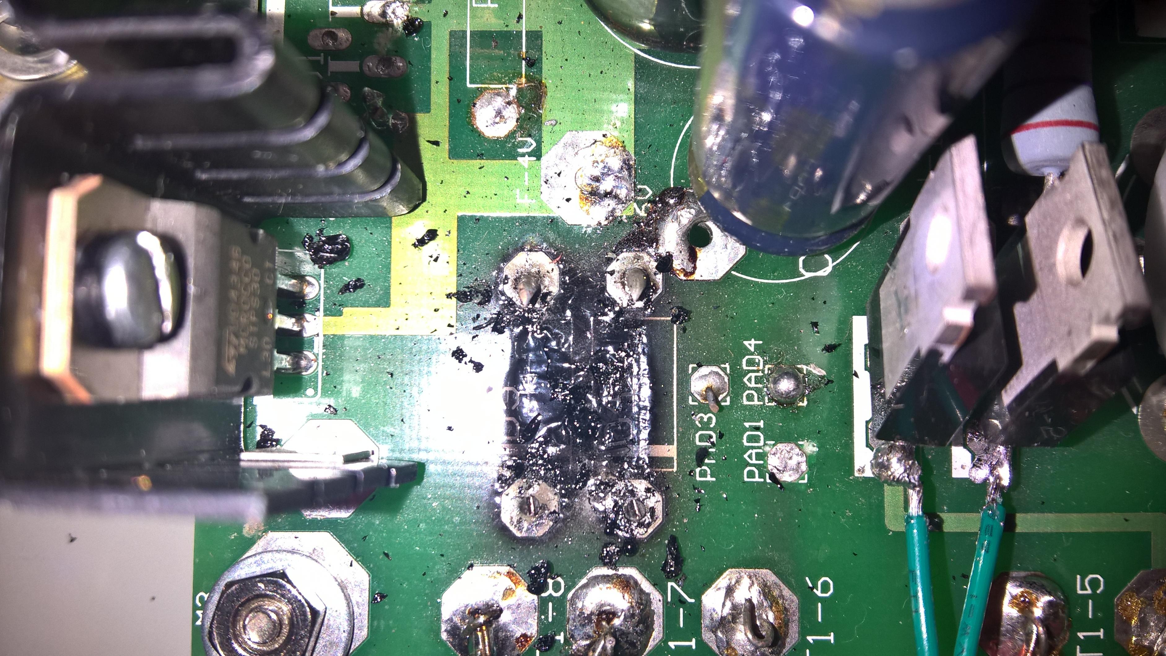

A pretty serious scorch event - my radio room still stinks several days after the event 😱
TIme to order more victims, um .. parts ...

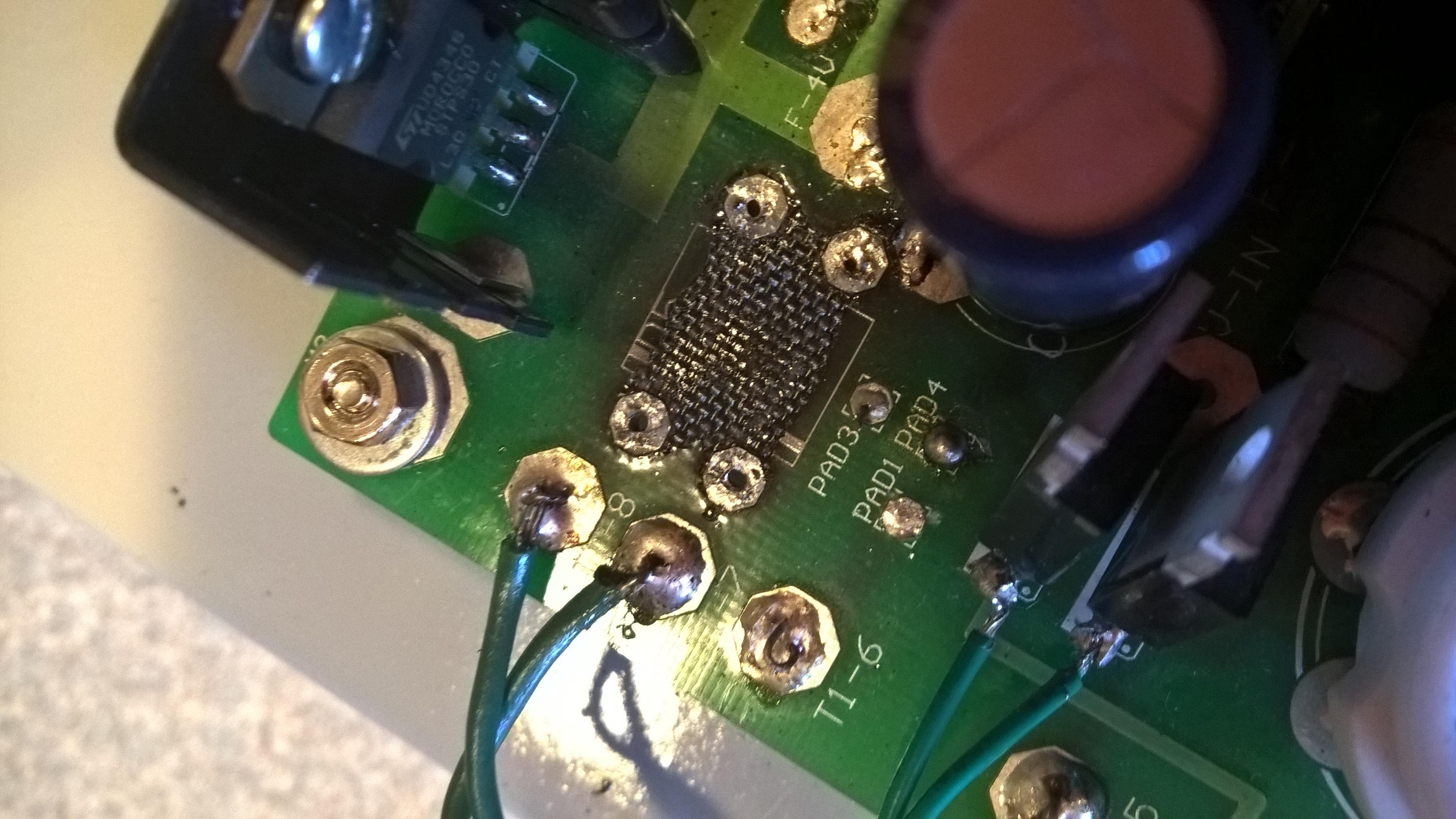

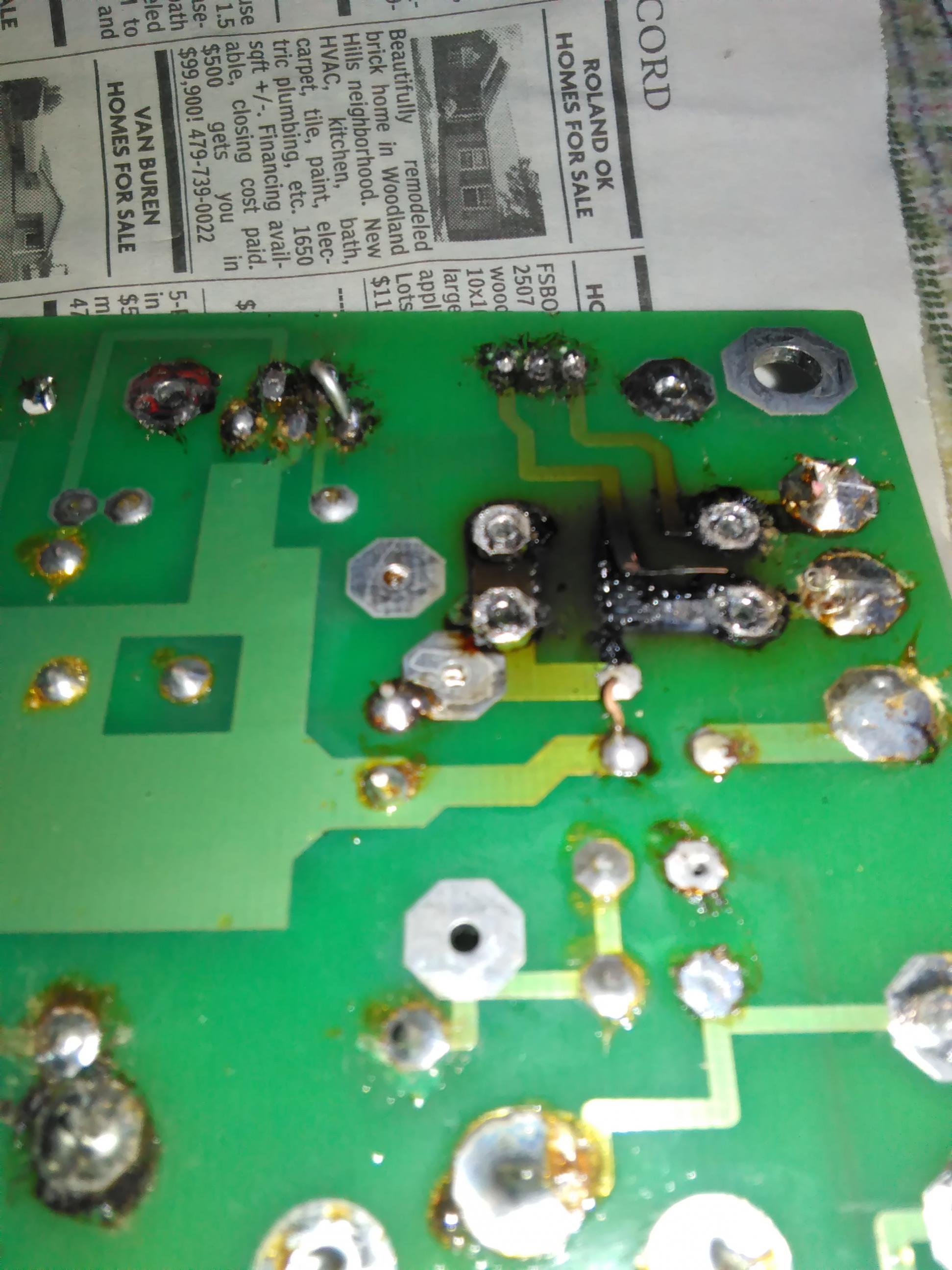

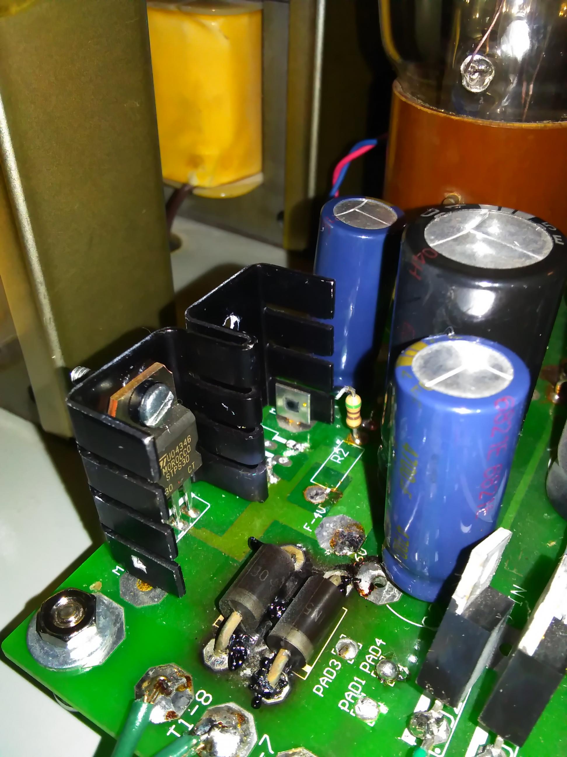

Well, it's repaired, and back in 801 service.
I've had the parts for awhile, but put off the repair, in part because of the tedious nature of work in that part of the TSE board, and in part because the need for rework was entirely a function of stupidity, which I really didn't need a reminder of.
Anyway, as I expected, the damage below board was a lot worse than the damage above board. The traces were pretty well toasted, more resistance than conductor I expect, in light of the increasing voltage drop with increasing current. Since I had it apart, I replaced both 1N5401 and the schottkey dual diode, although I expect all the aberrant behavior was due to burnt 1N5401's and traces. I also replaced the 6.3 volt capacitor in the filament line of the 801A's with a 10,000 uf 10V part, and replaced the power supply electrolytics with 500 volt parts.
It's working nominally, 6 volts on the 5842 heaters, and a steady 7.2 on the 801's under load. It hasn't taken me long to make this board look as trashed as the SSE board I pulled from this chassis. 🙁
I have to say, the 811's are the real deal, and having the opportunity to have tried them out was worth the mayhem it caused. They will get more attention in the future.

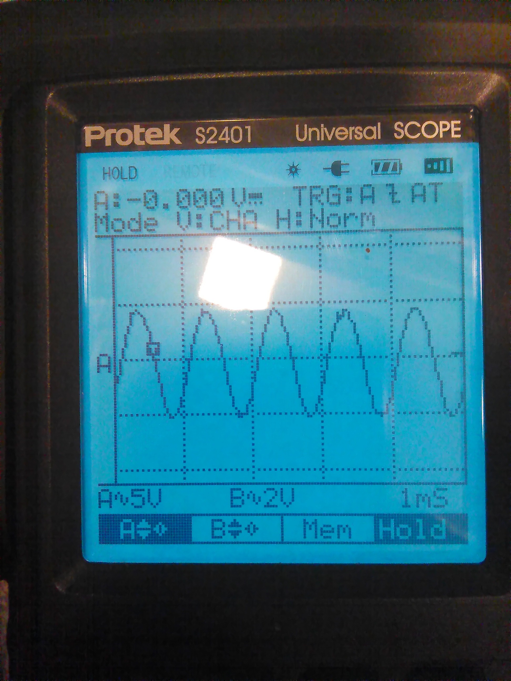

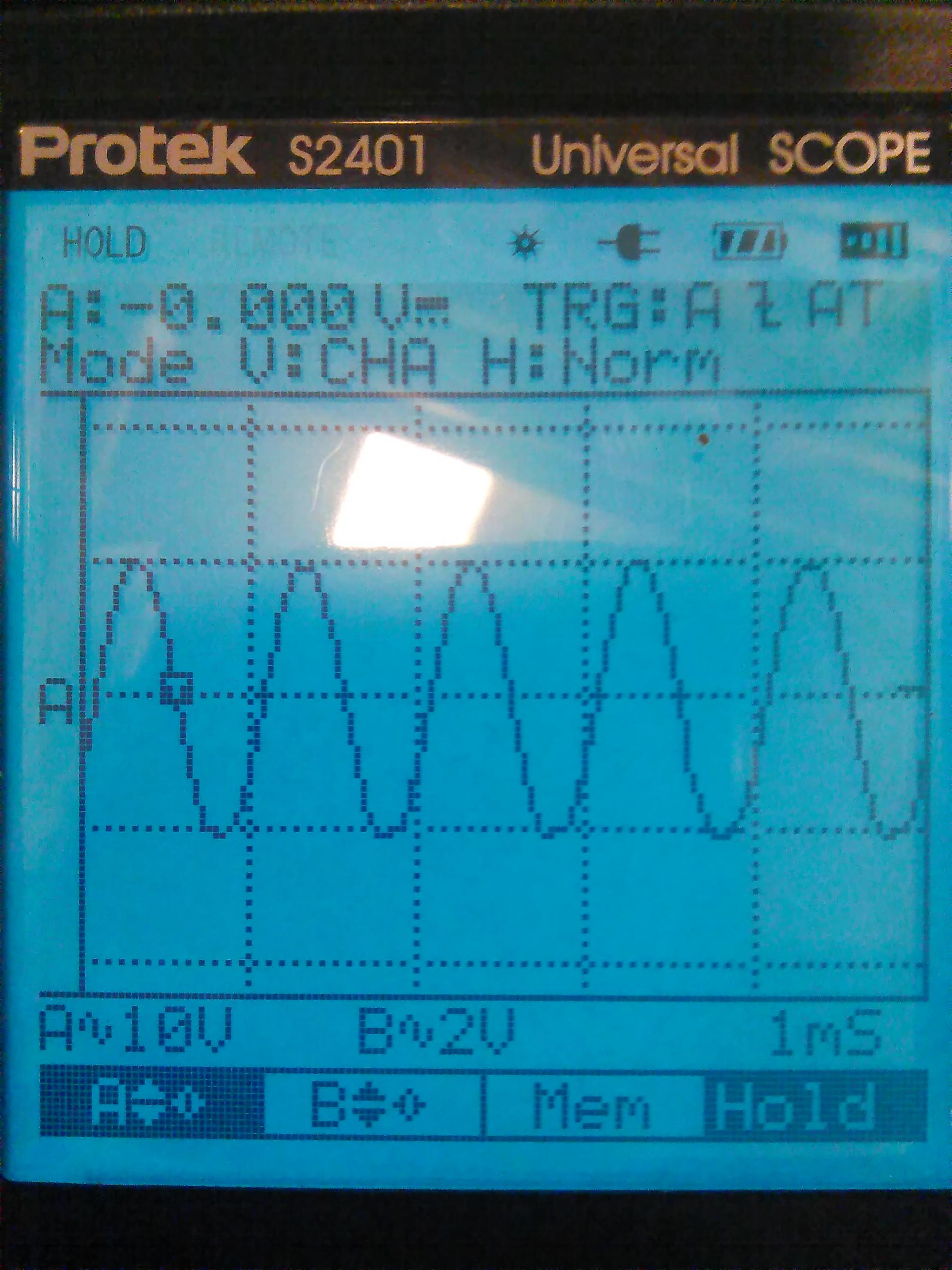

I think my initial thoughts on using the 801A were wrong, and the defining characteristic of successful employment of the 801 on the TSE board is current through the tube, and not voltage across it.
The magic number seems to be 50 milliamps, plus or minus only a few milliamps. As the plate rating is twenty watts, by definition this limits voltage to 400 volts or so.
The first pic below is the output of a 1 kc sine wave into the TSE 801, 25 milliamps current at 425 volts, being delivered into an 8 ohm resistive load. 10 volts p-p into 8 ohms is 1.6 watts, if my arithmetic is correct. In fact, this is the data sheet output value for an 801A at this operating point - it will do this at 20 milliamps. This is also the data sheet point for a type 10 at these same points, if one cares to look. This is all 801 will do, until you get to markedly higher current through the tube.
The 10 may have less distortion at these numbers - I can't say because I don't have any. I'll put them on my hamfest look list to see if I can get some examples.
Now, ( second pic ) look at the same 1 kc sine wave into the TSE 801, 50 milliamps current at 410 volts, being delivered into an 8 ohm resistive load. 20 volts p-p into 8 ohms is 6 + watts, if my arithmetic is correct. And, IMD is markedly better at higher current - at all output levels, you can literally watch IMD drop as current is increased in the tube. Above 50 mils, the decline in IMD is slight and insignificant; not worth pushing the tubes past their rating in my opinion.
I repeated these tests at higher voltage ( up tp 450 - I didn't want to set anything on fire like the last excursion to 500, and it now seems unnecessary to go there ) and lower currents to get the same twenty watts power through the tube, and consistently ran up against the 1.6 watt limit before the sine wave showed distortion. Thus my conclusion: current important, voltage - as long as it's above 400 or so, not so important. And, the number for current is 50 milliamps.

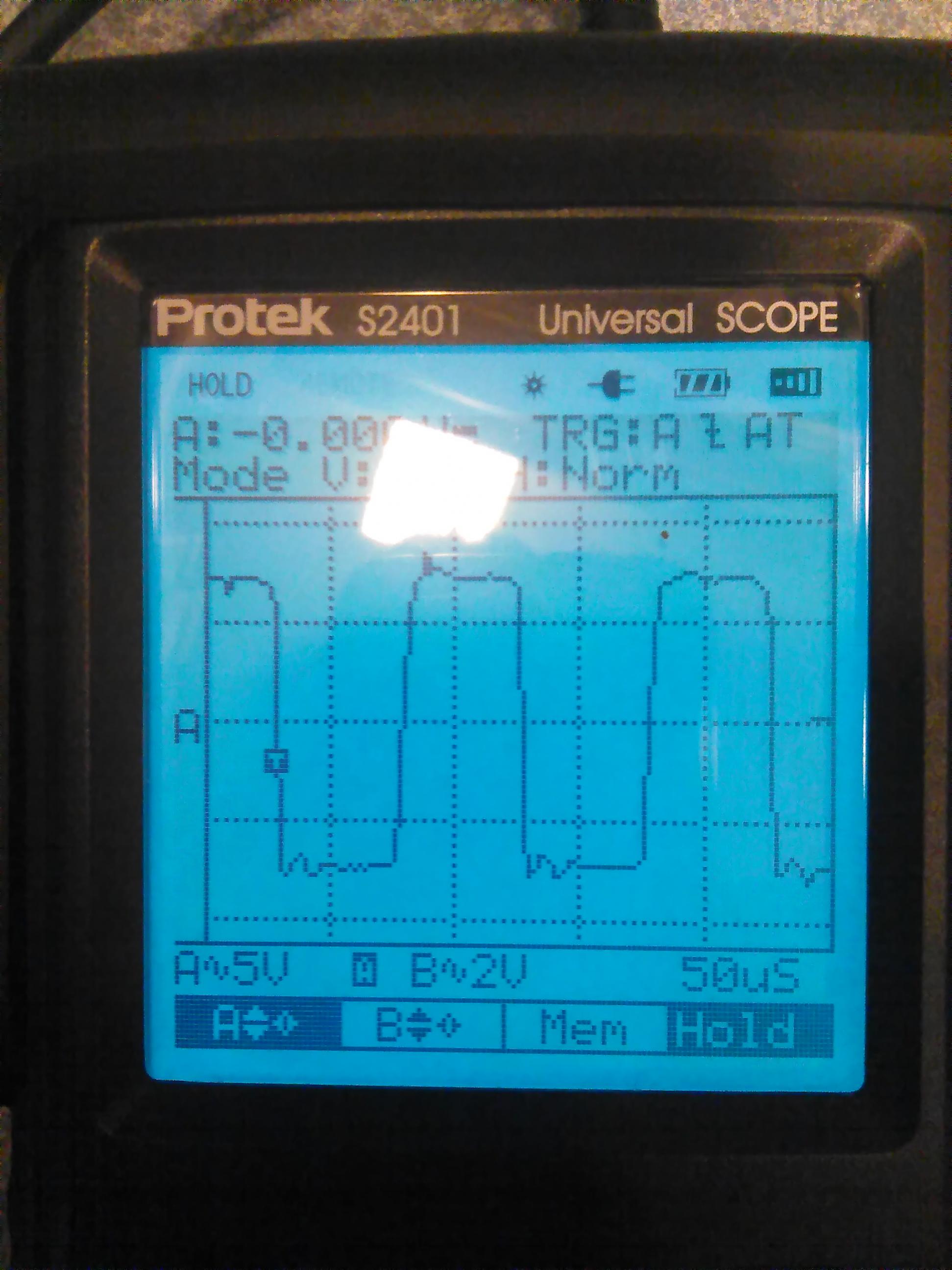

The third pic is a 10 kc square wave at about 3.5 watts output. I don't know much about interpreting square waves - I'll leave that to someone else. The ringing looks to be on the low side of the wave. The sine wave also distorts asymetrically, beginning on the low side of the wave. This is consistent on both my analog scope and the digital one.
Sorry the pics are not better - these are on my handheld digital scope to use the hold feature, and for my convenience on the bench - it's an older scope so the resolution is lacking compared to newer models.
All of these were with the Hammond 125ESE at 10K load.
I think I'm about done here until I can get some 10's or 50's. I've looked briefly at lower plate loads, but distortion seems to go up significantly at 5K, so I don't see much point in looking at that further.
