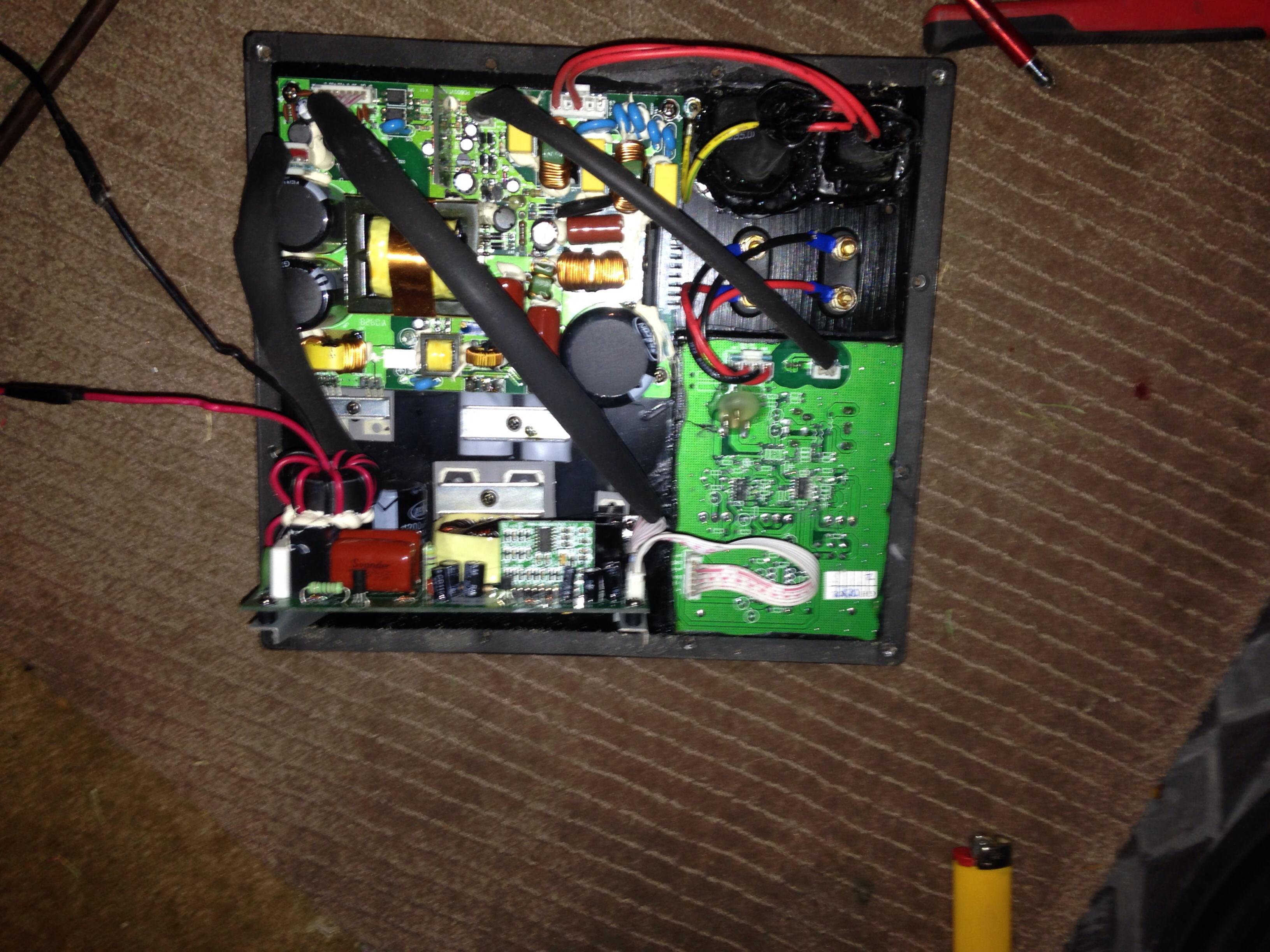

Hi, repairing it is a lot easier than replicating it, rgds, sreten.
Thank for all info and suggestions....
I think I will try to repair it ....
It is going into stand by/protect mode as soon as I turn it on ...
It just started doing this with no obvious reason ... It was just turned on but I wasn't playing any music ... It may have happened because I left it on over night?
... If I pull it apart myself what should I be looking for?

Keeping in mind that you should fully discharge the power supply even after the unit is unplugged it will hold lethal voltages. It is not safe for a novice to do. If you know a qualified electrician or tech, have them help you to:
check for bulging or leaky electrolytic capacitors
check power MOSFETS
check power MOSFETS
