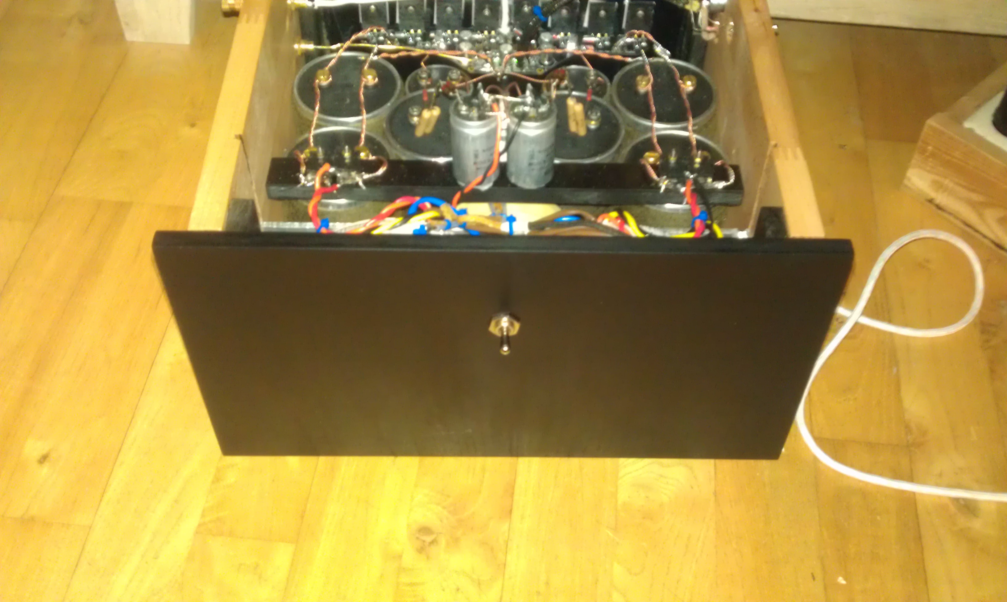

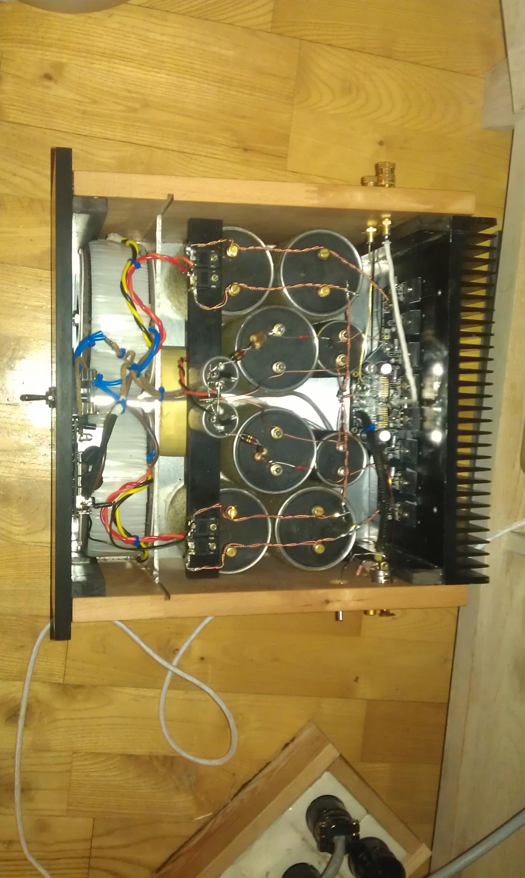

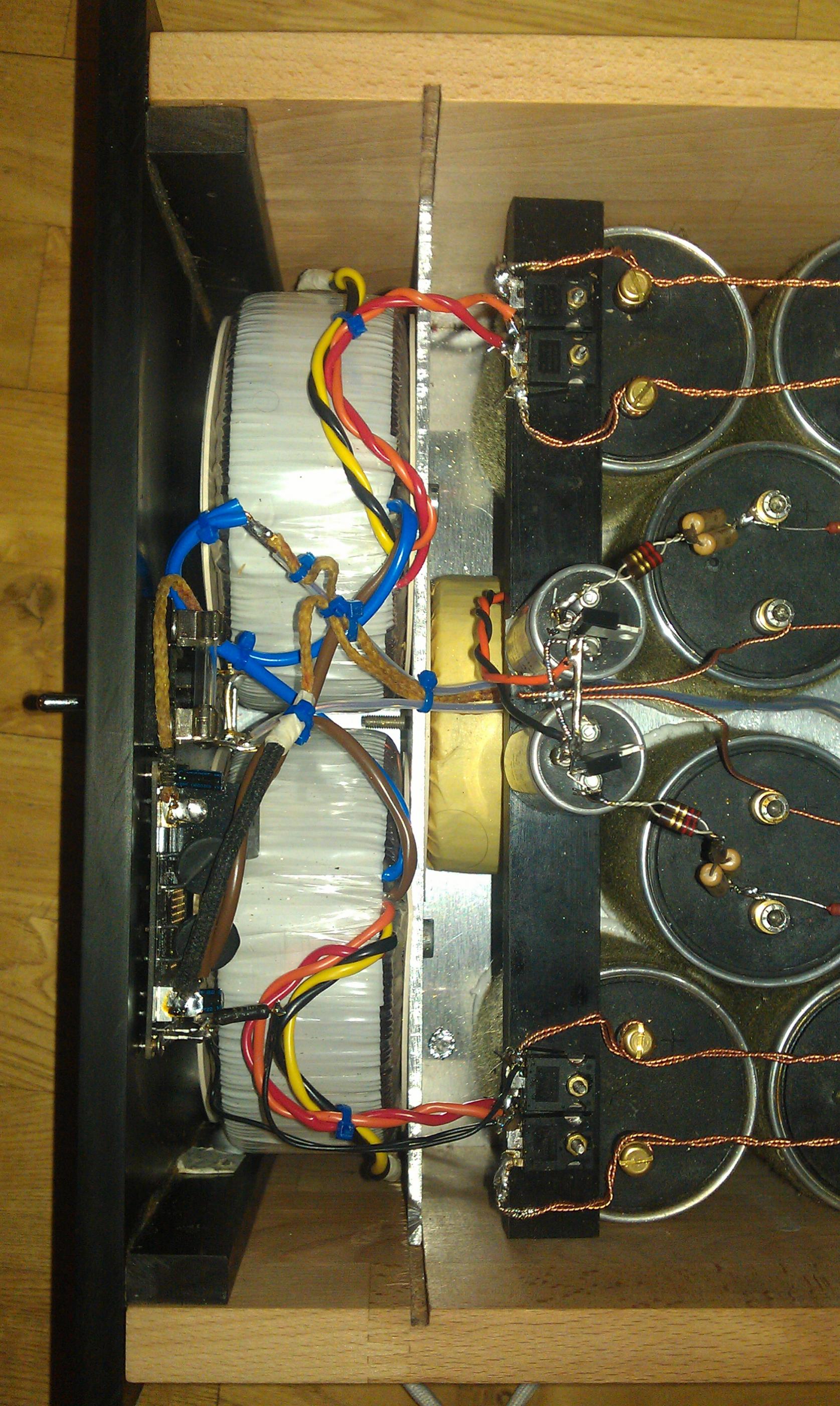

Fino !
Just listened to my new NXV 500 R2 . Its amazing -- sounds wonderfull. Much better than the earlier moduls. Has the missing warmt in lower midrange upper bass. Transparens is so much better also. This amps is way better than the NCore 400 I made for a friend some weeks ago. The N Core 400 sounds like a clock radio compared to this.
Fino !
Hi Erlend
That's awesome!
Good to hear some feedback on how someone else is enjoying the sound quality of the nxV500 R2 modules.
Erlend would it be OK for me to put your comment in the Testimonial page on my web site?
Cheers
Anthony
Do that and I will send you some pictures. They are not complete finished. I am waiting for some components .
Great!
Please send me some photos.
Cheers
Anthony
