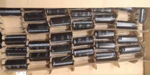

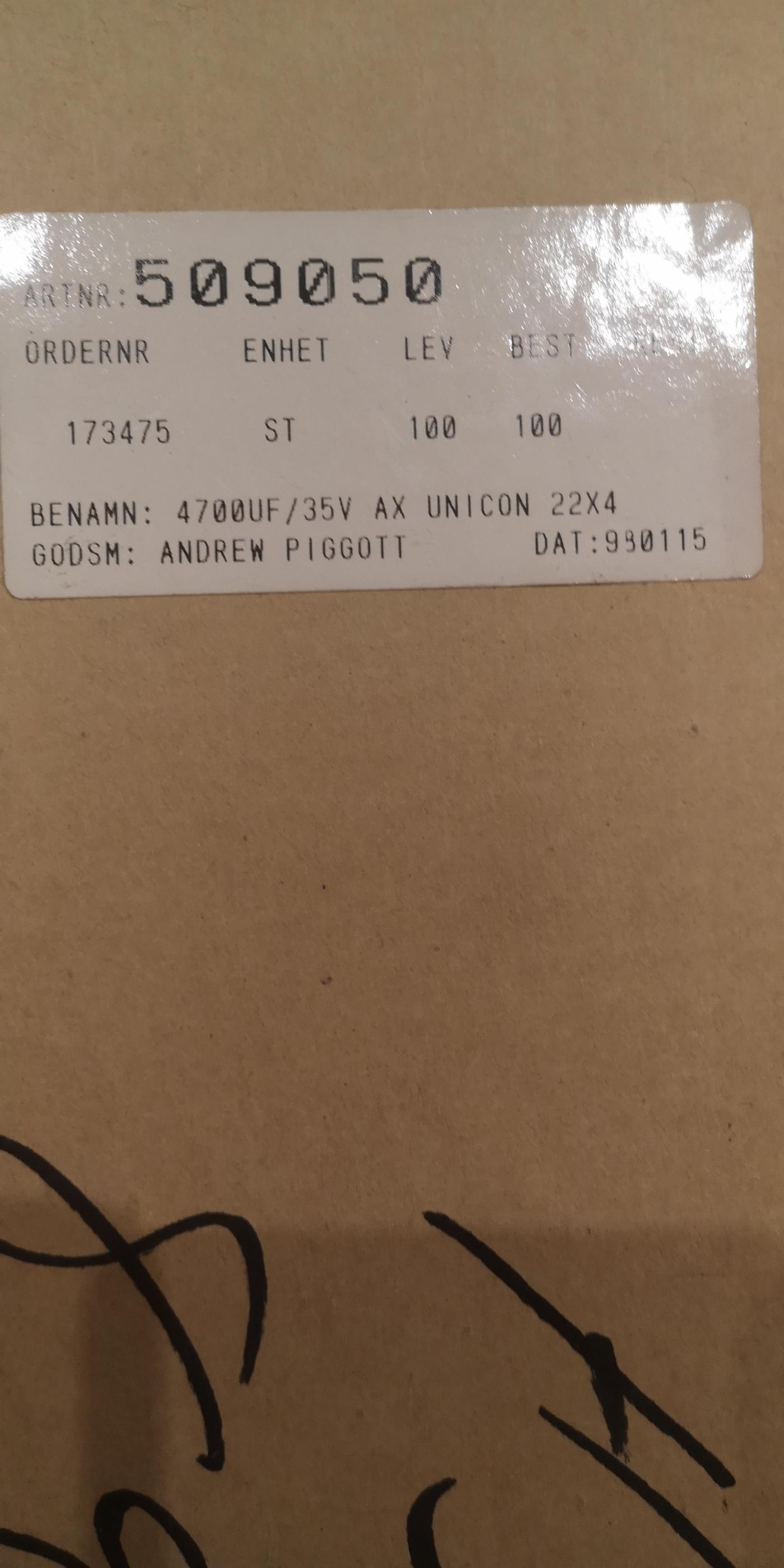

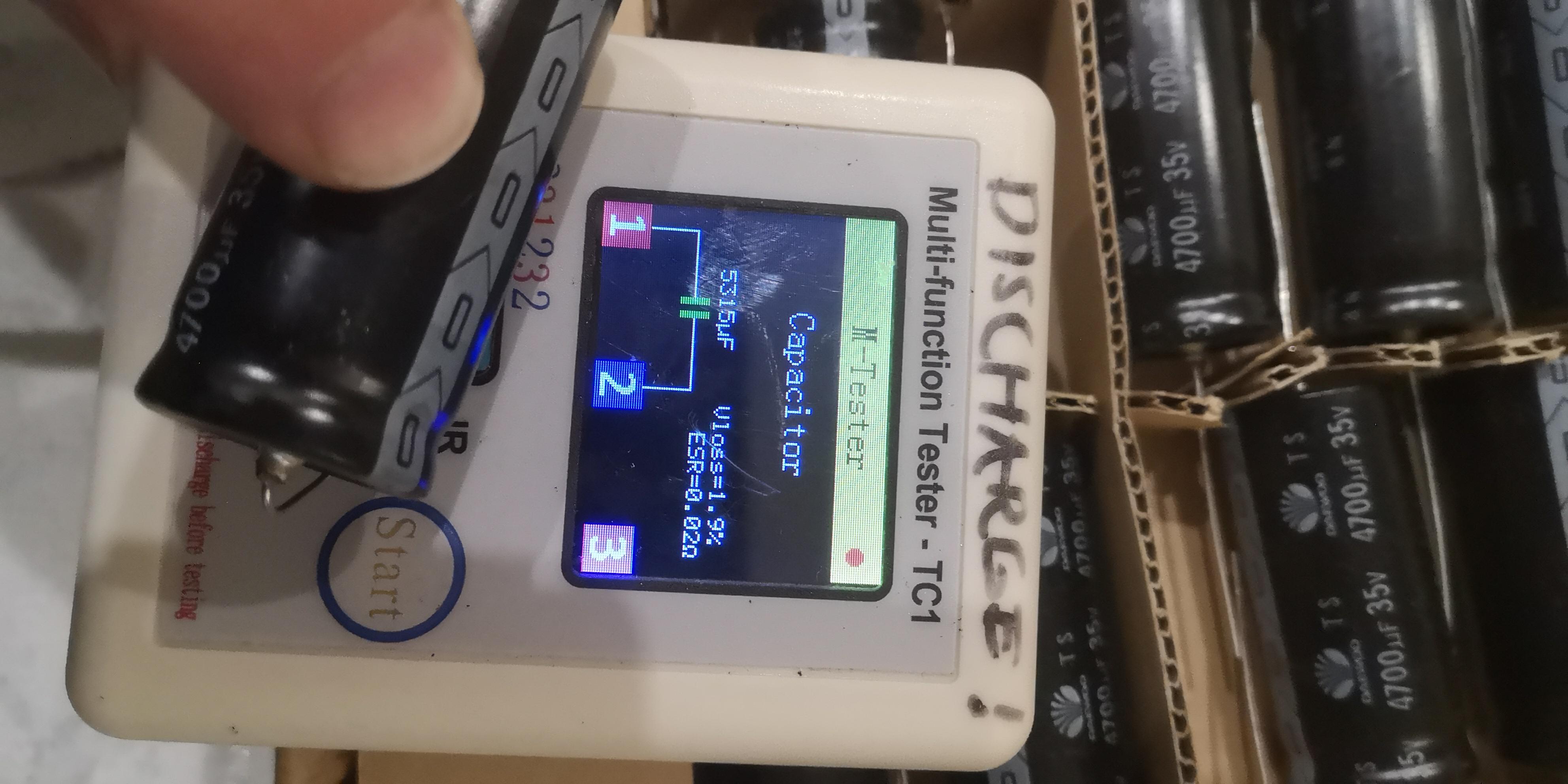

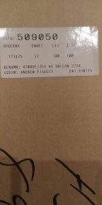

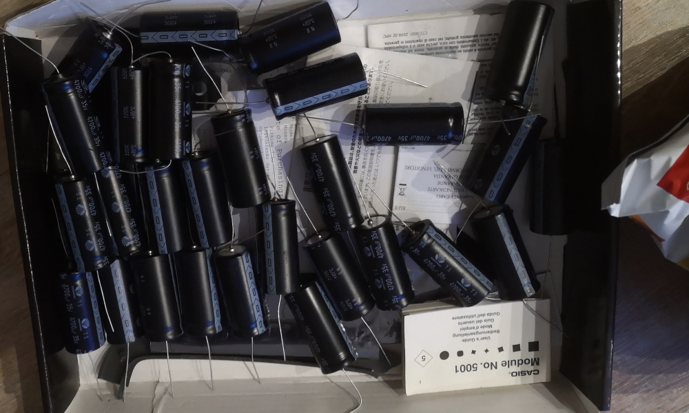

I have a couple of boxes with 20 year old NOS capacitors (4700 uf) - they all have a perfect ESR and a capacity of 5200 uf (measured) ...I use them in a couple of Class A amplifiers without any problems

I just opened one box - nothing has been reformed - I measured as it is
how about the ripple current at the nominal voltage, same as in the specs? 🙂 some might mention about the leakage current.
I have 1976 amp with original caps and it still working fine, but if you buy new caps that are 8 years old something is not right here...
of course i can't tell you exactly how big the leak is..but how much i tried to charge them - after a month or two they held a charging voltage (25V) well ... some were 20-17v ... of course there were some differences but nothing critical.
