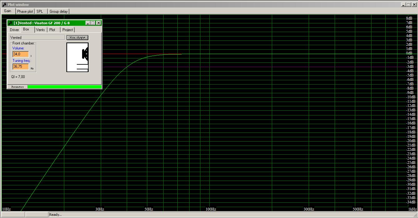

I was thinking of these for the 3 way :
GF200 Visaton 20 cm (8 inch) High-End woofer with double voice-coil
GF200 - Visaton 20 cm (8 inch) High-End woofer with double voice-coil - Europe Audio
Scan Speak 10F/8424G00
10F/8424G00 - Scan-Speak 4 inch wideband coated fiberglass - Europe Audio
Scan Speak D2608/913000
D2608/913000 - Scan-Speak 1 inch dome tweeter fabric diaphragm - Europe Audio
for the box i can go maximum of 45L , but it can be smaller , my room is small 15m2 or 49 sq feet , thats why i dont want bigger boxes

I looked at Felipe's Visaton GF200. It's really a driver suited for reflex around 40-45L.
Visaton - Lautsprecher und Zubehör, Loudspeakers and Accessories
It's the Qts of 0.34 and Vas of 68L that tells you an acoustic suspension design would be around 22L. You'd want a softer surround and a bigger Vas for any closed box solution near 40L, if I have any understanding of the simple calculation.
In confirmation, Visaton offer a 40L reflex design for this driver called the Classic:
The suggested Monacor SPH-200KE has similar low Qts of 0.38 and Vas of 54L, so is maximally flat around 20-25L enclosure.
SPH-200KE - Monacor top HiFi bass-midrange speaker 120Wmax 8 Ohm - Europe Audio
I'd guess a suitable driver for closed box is really going to be Qts=0.5 and Vas 50L here, unless you look for a foamed surround low Qts driver like the old acoustic research drivers, which had enormous voice coil inductance (3mH...) and magnets. Closed box is quite unfashionable these days, so you have to hunt around for a driver.

I think the point for Felipe's original question is that a driver designed for closed box is really a different animal from a driver designed for reflex.
For closed box you can use a much lower inductance (say 0.3mH or less) which is good for extending frequency response, higher Qts and a softer surround, all of which help integrate the design. Worth looking around for something appropriate, though I really don't want to spend time on it myself. I'd suspect the appropriate single driver for 40L closed box is likely going to be found in the 10-12" range.
Just my OCD nature, but I looked into the 40L closed box drivers at Wilmslow Audio in the UK.
Mid/Bass Units
Peerless do a Qts=0.5 8" suitable for 33L maximally flat response, a 10" suitable for 70L and a 12" for 175L (which is 6 cubic feet!). 40L closed is just a very bad design choice based on what most companies actually make, and you really only get 20% leeway on going below Vas by adding damping!

A solid recommendation
OK, Going to assume the Peerless 8" 830869 driver is currently available through Europe Audio. It is listed there at $91.00 USD.
This is a great woofer with a smooth extended response, has a combination of FS and VAS needed to fit within the 40L enclosure limit. Excellent reviews, nice off axis response, nomex diaphragm, Faraday motor enhancement, and other excellent tech features.
Flexible, can be used as a pure woofer, mid woofer or dedicated mid range.
Hard to beat. No special crossover tricks (or DSP) to work well. Nice cast frame too.
