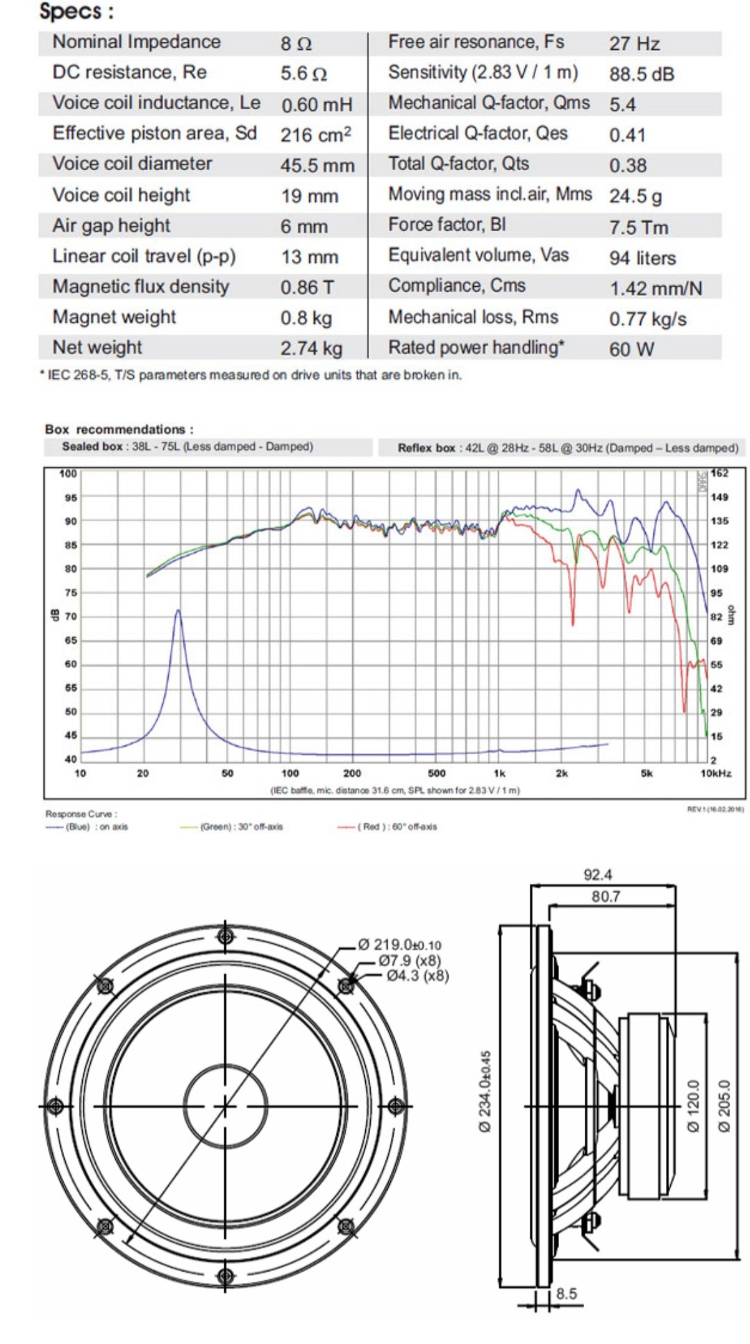

I'd go with the SB23NRXS45-8.
It has an excellent motor and sounds really tight / accurate in a vented box. It will do mid-30s F3 in 45 ltrs and copes with a decent amount of power.

Yes I like it , I may just go with a design I found on another site.I'd go with the SB23NRXS45-8.
