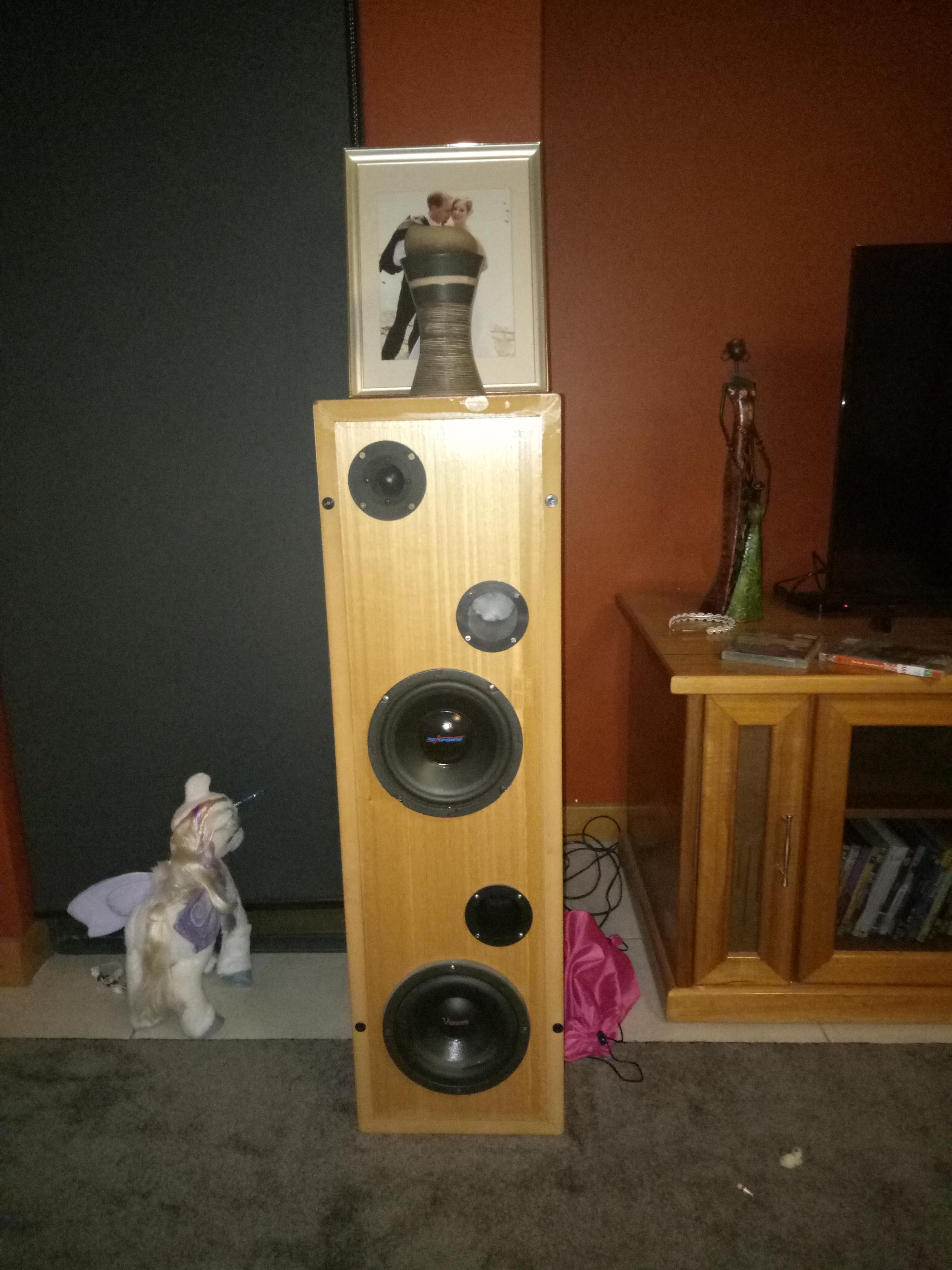

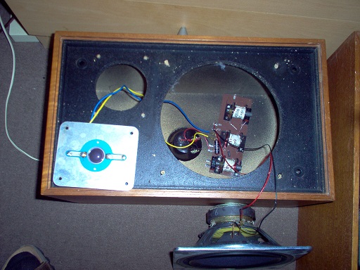

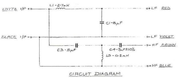

Hi, I'm after some advice or comments.
I built some cabinets to suit the Jaycar CW2136 drivers many years ago. Cabinet volume is 33ltr, 66mm port at 165mm length. They sound OK, but I'm looking for advice about some better quality 8" drivers that I could use to replace my existing ones. Drivers suitable for my existing 33ltr cabinets...
The lower driver in the picture is in a 40ltr separate compartment, and is driven by a separate 300wrms and (sub signals only). The sub is fine, just looking to improve the 8" driver and possibly the tweeter as well. Speakers sound very light sounding and lack bass without the sub woofer being http://www.diyaudio.com/forums/atta...river-replacement-img20180421212441-jpgactive.
Thanks in advance.
As has been mentioned, that tweeter could be closer to the bass. I might turn the whole thing upside down and fit the tweeter in the lower port. Very John Devore! His speakers go for about $5,000.

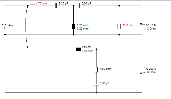

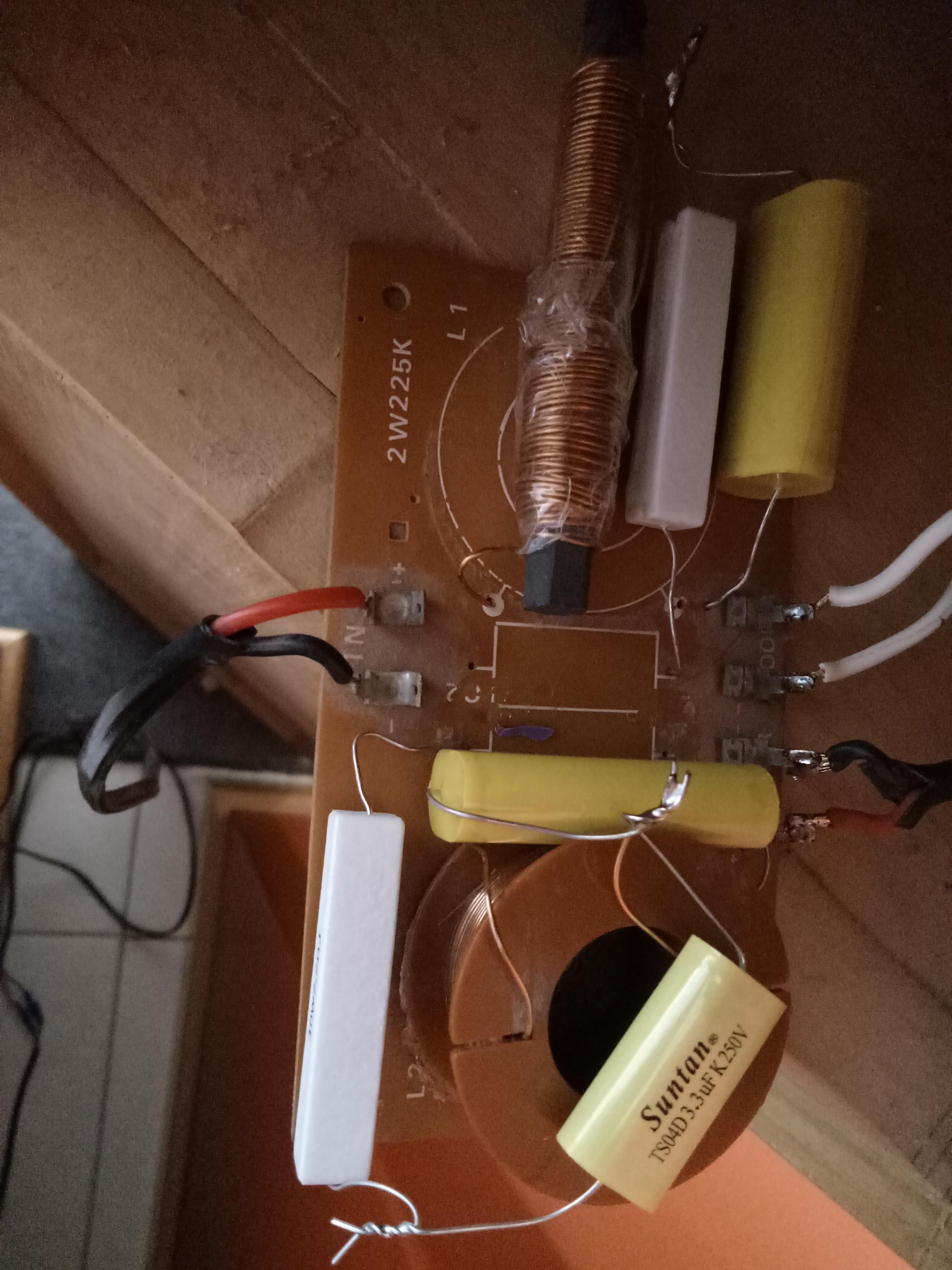

To answer Steve's question about the crossover frequency, 2.8khz sounded quite good to me. I built the passive crossovers at 2.5khz, used my existing former boards and made them. They are very rough at the moment, but they sound great. Bi amping them and running an active crossover allowed me to test different crossover types, slopes etc. But doing this I lost me outside speakers (as they were using my other amp). I've attached a picture of my very rough crossover as per system7s design. To me they sound very flat....

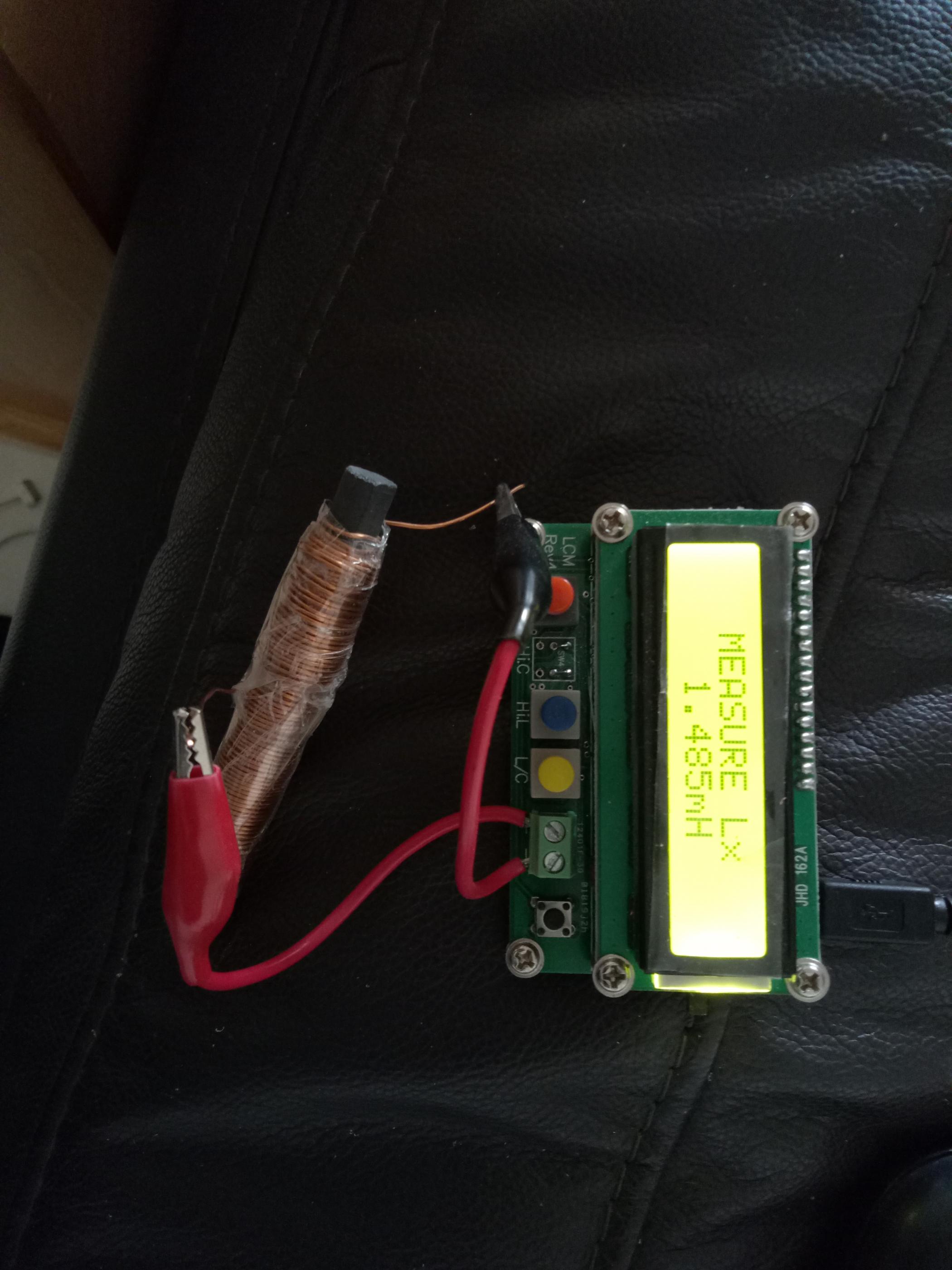

FYI I hand wound the air core, and used my inductance meter to fine tune the final result. The ferrite core inductors are 10mm id, 79cm long. Ended up requiring 2 and a bit overlaps to get the final inductance close, then I just wound on a slight bit more to get to 1.5mH.
I also used relatively high quality capacitors (250v rated) and, 0.8mm wire to wind both the air core and ferrite inductors. We are in the throws of moving, so as soon as I have a spare minute all post some plots. I use my DSO, with a sweep generator, one channel of the CRO measures the microphone, the other measures the sweep generator (in case the sweep output isn't entirely linear in level). All up the capacitors cost $100 Aussie, former wire was cheap, and obviously the resistors were cheap as chips.
Aw, brilliant work, Brett. Your first proper crossover! 250V is normal for MKP capacitors. Actually, cheap non-polars work well enough too. Don't listen to the people who say you need gold capacitors, an' all that nonsense. The crossover circuit is the main event.
I still use that KEF negative polarity idea.
It's not bad for a one-size fits all, eh? I have it running on one of my current 8" plus tweeter speakers. And it's far better than the circuit I found in my old Monitor Audio R300-MD speakers.
Dissi dug up the circuit for the KEF Celeste III, and it's been a constant inspiration. So simple. Of course, ideas evolve. I think I am up to 13 components in my latest effort. But you'd have never built it. 😱

I originally wired the tweeters with incorrect polarity, the system actually sounded OK, but the mid-range was very faint... Obviously there was some cancellation due to phase. With the tweeters reversed, the system sounds awesome 🙂 Was a pain winding the ferrite cores, but once I got one right, I just measured the length of wire, and built two from that which I fine tuned.
Thanks again system7, such a simple circuit but made a massive difference to the sound. I ditched the 22ohm, and used a 2.8series resistor to balance the tweeters. Thanks all again. Now the bug has bit, I may start designing more and more 🙂

I was very impressed with your engineering ability and especially the use of an inductance meter. 🙂
Theory says that inductance is proportional to the square of the number of turns, so you can always unwind an inductor for smaller values too. But you take off less than you might expect...
Nylon zip ties are useful to fix components down to a PCB with a few holes drilled in it. You usually try and arrange coils so they don't share an axis, which you have done correctly.
Tolerances don't matter terribly. 5-10% is usually near enough. You won't hear it. As it goes, the 22R does do something. It slightly damps the tweeter voicecoil, and takes down sibilance. But it's subtle. I always model these things with similar drivers do see how it all works out. The 2.8R protects the amplifier a bit from a resonant short circuit if the tweeter blows at a party.

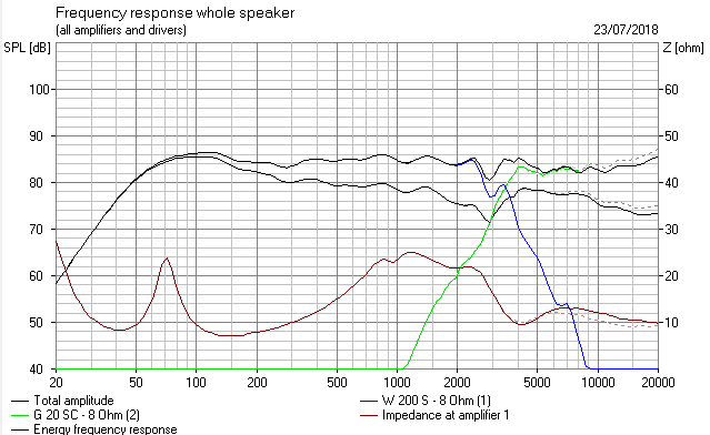

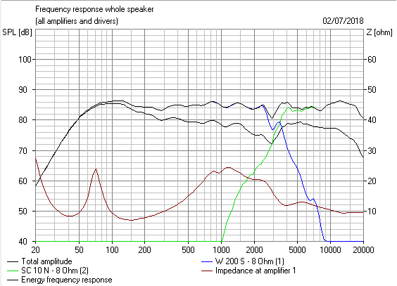

So I have had a go at this in Visaton Boxsim.
As Alan Shaw of Harbeth says, the great thing about a CAD simulator on your laptop is you can sit on the beach with the wife, kids, AND a drink, and design speakers too. Win-Win, IMO. 😀
Anyway, here's my suggestion for your next step. Try a Zobel on the tweeter. This is impedance correction for most 6 ohm dome tweeters. It really outpunches its weight. Sounds astonishingly good. IMO. Turns a speaker that sounds OK, into a SMOOTH one that wins a cigar. 😎

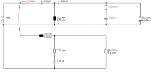

Sysyem7, the zobel on the tweeter has definitely smoothed them out, WOW was my wife's comment on the difference in sound.
Just a question, baffle backstep literature I have shows a resistor across the inductor on the woofer, I may try winding an inductor by winding 1.0mm wire around the OUTSIDE of a 10w resistor, and try to get a combined inductance of 1.5mH. One of the inductance testers I built allows me to adjust the drive frequency, meaning I can adjust it to 2.5khz and confirm inductance at crossover point. Is there any news for a parallel resistor on the backstep network. I'm also going to remake the front baffle, curve the edges, move the drivers around etc
So I've purchased a few books on speaker design, including a book by FANE (I also play guitar so their speakers interested me). Also some books on crossover design etc. Someone mentioned that my speakers suffer from a bit of breakup at approx 2khz. I may even remove the dust caps, and try my hand at making some phase plugs to see if they can fix the issue. I'll do some before and afters....

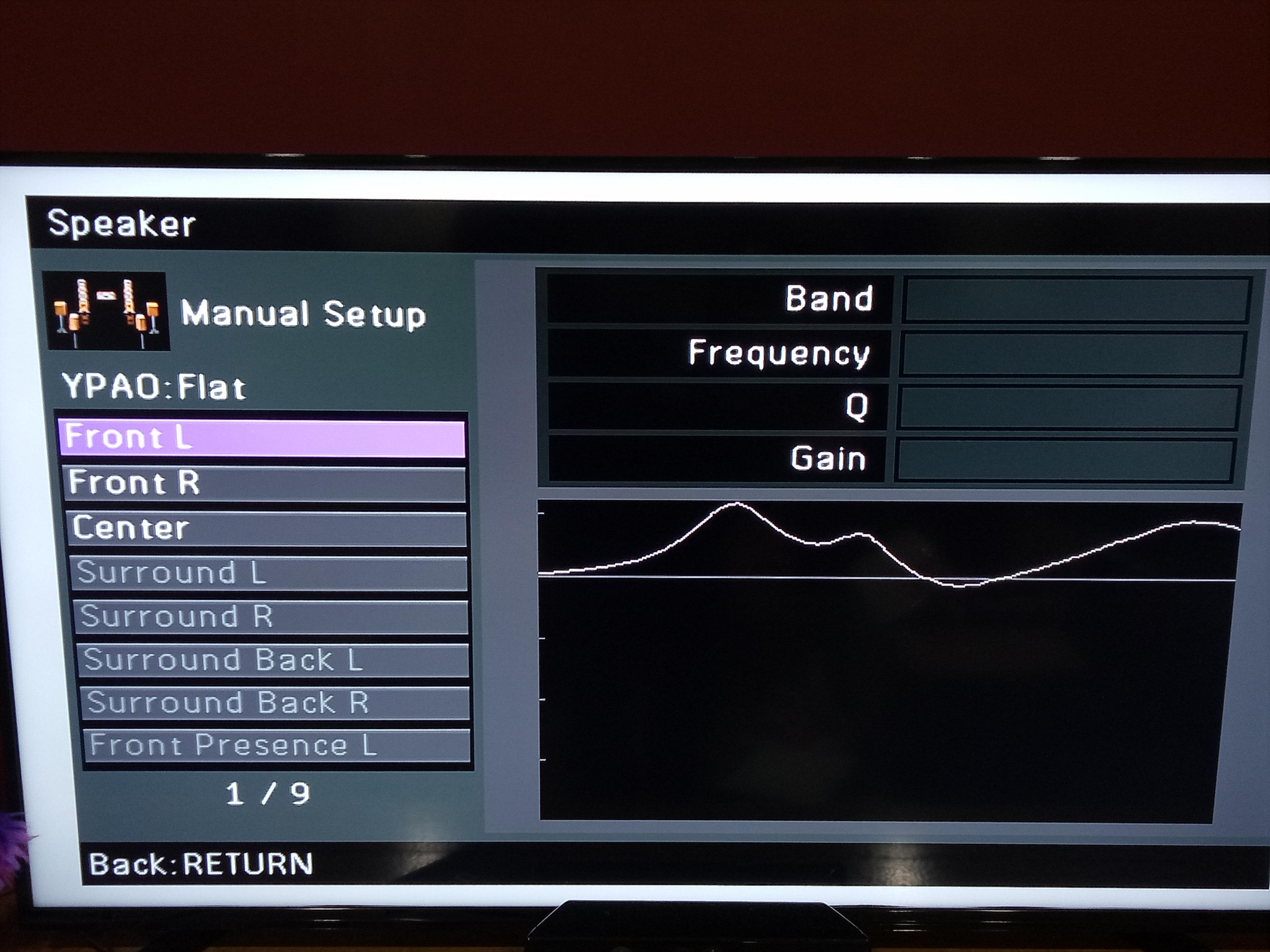

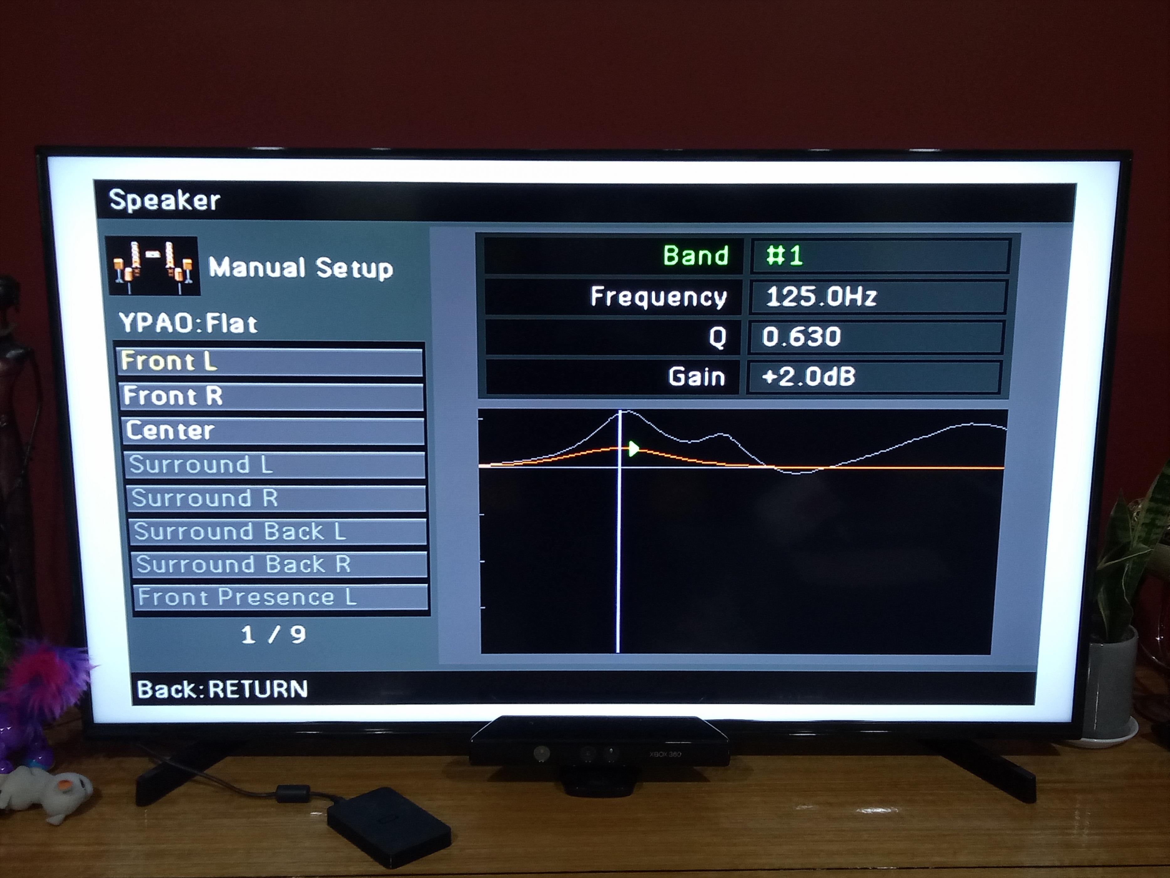

Here are some preliminary results...
I don't trust automatic test results, and I will do my own testing with my DSO, etc.
So my speakers as it is have a 2+dB dip at 125hz, and also at 5khz.
Before the crossover corrections they had huge peaks at 125hz, 500hz, and 7khz.
The before plot image is the file name that ends with 5826.
All of these plots are with the lower speaker not connected, and my amplifier in true direct mode (IE what goes in comes out without any eq, tone control etc.).
Sorry, I generally write this on my phone, I've noticed its got a habit of changing words for me.... Two of the previous posts were supposed to be questions, not statements. So what in a nutshell, and ideas about baffle step for woofer being wound on a wirewound resistor as a former. I've done this before with carbon resistors (not for audio, but piezoelectric drivers), maybe it won't work due to wirewound resistors already having quite an inductance. My other post that was supposed to be a question and not a statement was about the gibbon x drivers, do you think they have used a low pass filter for the 9" drivers, a band pass for the 'woofer' and a high-pass for the tweeter? Or maybe the two 9" are tuned differently to give a nice even frequency response in the lower frequencies??? Thanks again to all, I'm packing all my gear up to begin the painful task of moving house. More to follow 🙂
You do occasionally put a resistor across a bass coil. Maybe 68R or so. But it really doesn't do much. There is a use for, say a 1.5mH coil in parallel with, say 2.2R as passive 2dB bafflestep or tonal shaping. Seas ER18RNX with 27TDFC
The above sim won't be wildly wrong. A dip at 125Hz is likely a diffraction effect. As is a tweeter dip at 5kHz. I wouldn't worry about either.
John Devore is always a fan of the easy load. But he doesn't go for absolutely flat. Nor do Harbeth. I really couldn't guess the crossover. And I really don't care because I follow my own ideas. Some win a cigar, some don't. It's the hobby. RMAF 2015: DeVore debuts long-awaited Gibbon X production loudspeaker | Part-Time Audiophile
This is a VERY clever circuit:
I found that one in an old Wharfedale Shelton XP2. But KEF used it a lot too. A lot of basses have a little shouty 2dB peak around 1.3kHz, and the circuit fixes that. Sounds quite neutral.
From what I can estimate, it will work with most 8" basses. 8 inch basses usually enter breakup around 3kHz, which shows in the phase plot, but it usually is not too offensive.

I'm still tinkering...
I've fabricated new front and rear baffles, the font bring the 8" driver and the tweeter closer together. I'll fire the two ports rearward, and I'm going to add another 8"driver for the sub 120hz signals. The venom sub that I have is was very cheap, and is probably quite poor quality, but I figure if I keep tuning the lower cabinet till I get a nice roll off, I should end up with a nice sound.
Either that or I buy some decent drivers. The visaton drivers look very nice.
What's everyone's opinion on ribbon tweeters, or decent quality tweeters?
