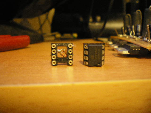

This is what I use to bias and unbias op amp

In my searches I see headers and wire wraps. They all just show the part only and not how it is used so I have no idea how to use them. jaudio thanks for the pics! I was thinking to get wire wrap sockets and run wire beneath the PCB from the appropriate pins to a 2 dip socket mounted somewhere out of the way for plugging and changing different value resistors and JFET Cascodes.
Then I was also thinking to buy 10 pin open frame dip sockets and cut the 2 end pins off and solder wire from the sockets of the op amp pins to the two unused sockets for plug and play as well.

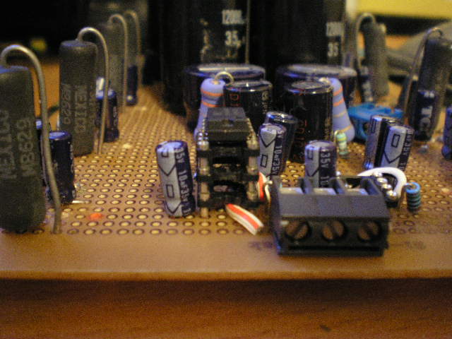

The hyperlink is very informative and I saw a picture with a "Class A Socket". I think I can modify a 10 dip or the next size up from an 8 dip and run leads inside the frame to the last two sockets for inserting resistors and jfet cascodes for testing with the op amp inserted. Of course I will have to cut off the 2 end pins and put insulators protecting the metal contacts from the PCB, but this looks like a good "one level" option! Thanks!

those pics show a socket converted to act as both header and socket.
the advantage of that is the DIP opamp can still plug into the empty sockets.
A header is similar but has pins on both top and bottom.
This allows components to be soldered to top side and then plugged into a dip socket. This needs a purpose designed PCB to accomodate the header mounted passive components alongside the opamp location.
