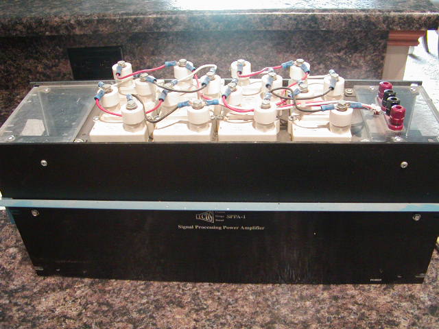

Mine is a 2 channel dummy load. I use it for bench testing any amp I test (only solid state). Any amp that is built or repaired gets tested with this load before using speakers. I also use it as a dummy load when testing distortion, frequency response, etc. using my Agilent 8903B distortion analyzer. I really want to set up a 7 channel load bank so that I can test multi-channel home theatre amps with all channels driven.

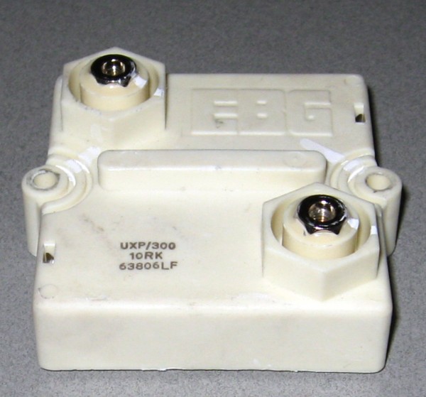

I used to use something similar to that. Four 2 Ohm units in series. Made a box around them out of MDF and mounted a line supplied fan on one end. Full power tested lots of very high power amplifiers that way. Got them glowing more than once. 🙂
That's one beast of a power resistor on that link Michel, the loads I used are metal clad types bolted to a large heavy duty heatsink and fan cooled all tucked in a 3u rack case plus different speaker/meter/scope in put connections.. It's been going strong for over 10+years now and get's a darn good beating on soak tests..

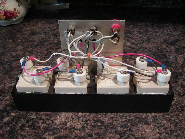

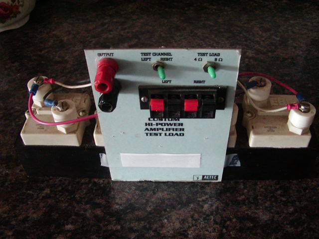

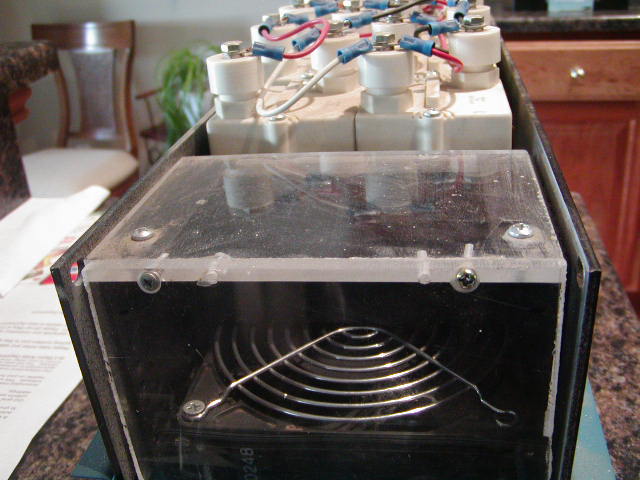

Pictures of my dummy load that uses 4 ohm 600 watt resistors. There is a little one that is setup for 4 or 8 ohm at the flip of the switch and there is my mega load that has 3) 5 1/4" fans that cool it.
