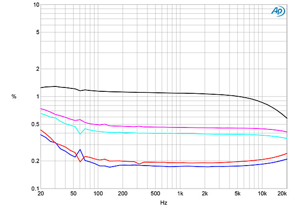

While this is not the tube amp I will be using this picture attached shows the impact of using a 8 ohm speaker on a four ohm tap. I'm a little concerned that I will quickly eat the 300b's and not get the full SET experience with a four ohm load.
20hz-20khz on an 8 ohm tap. 8 ohm is red and blue. 4 ohm is cyan and magenta.
On the other hand at 1khz on an eight ohm tap:
100mW=.12%, 1W=.4%, 5W=1.4% distortion
1khz with a 4 ohm load on an eight ohm tap:
100mW=.25%, 1W=.8%, 5W=4% distortion
Oops meant to say impact of using a 4 ohm speaker on an 8 ohm tap.
