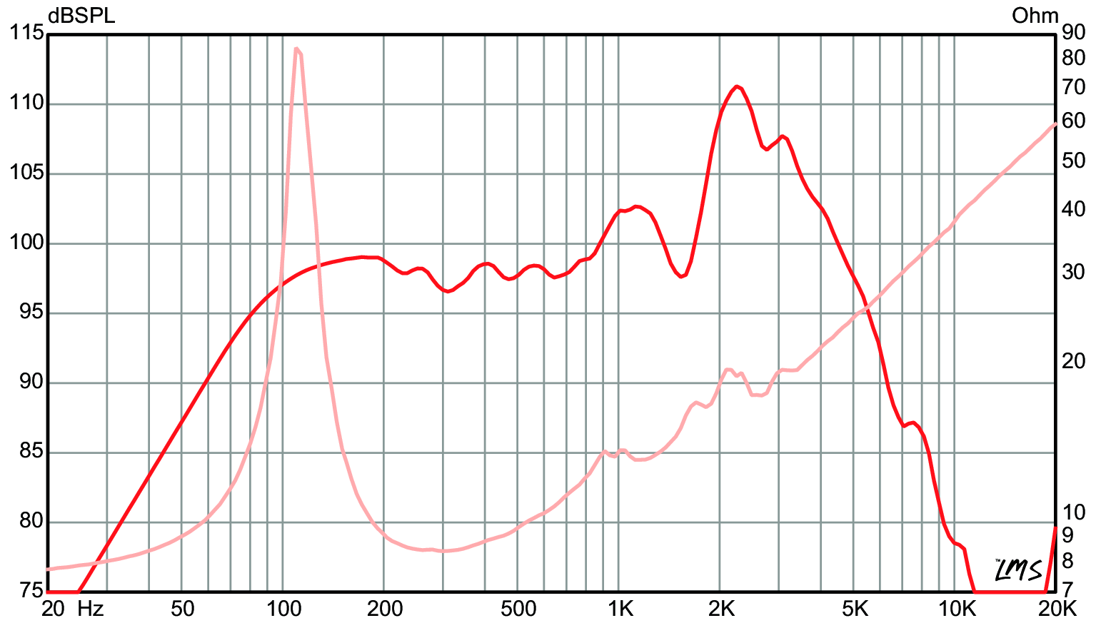

Answering all of your questions:
1) resistors do not create distortion, it all comes from amp/preamp
2) your amp is properly loaded ... assuming it´s happy with an 8 ohm load.
3) tell-us-what-your-amp-is.
Brand and model.
I´m amazed by the continuous flow of questions by people asking about something and not offering basic information.
4) Surprise!!! Tube distortion is harsh.
And even "clean" channel already has some distortion if it´s a Rock amp.
Not usually annoying because what you hear is HEAVILY filtered out by a steep lowpass filter, killing everything above 2500 to 3500Hz at steepn 24dB/octave or so.
Usually known as "guitar speaker"
Check it yourself, here´s a popular and generic Eminence speaker:
Notice between 2200Hz and 10kHz you have dropped a whopping 36dB or so.
**attached below**

I have a DI box that intercepts the signal between the amp and speaker to send to a computer
^^^^^ THAT.
You are missing all the HEAVY EQ I mentioned above.
You need to build and add a "speaker simulation" EQ between the attenuated amp signal (you must pad it down to 1V RMS or lower to avoid destroying your DI box ... unless it already has a "Speaker level" option, with the attenuator built-in.)
Attenuate anyway, since the Speaker Emulator only handles 1V or less signals.
For an inspiration, have a hard look at popular "Red Box" DI or equivalent boxes do, or what Guitar Amps use as "compensated line out"
Notice STEEP filtering.
Those who master simulators might simulate it and post the frequency response.
EDIT: and set your clean channel volume to a lower level.
You don´t hear it because you are using a resistor, but I bet you are playing at eardrum busting levels 😉

Reactive loads (mimicking loudspeaker impedance) are used (and often preferred as well) because their impedance characteristics alter frequency response of power amps with low damping factor. (These would be most amps aimed for musical instrument amplification). Basically a loudspeaker introduces an impedance peak at low frequency known as the resonant frequency and rising impedance at high frequencies. An amp with low damping factor will introduce higher voltage gain at these frequencies so basically its response will feature boost at lower and higher frequencies.
This is not apparent in all amps (i.e. amps with lots of NFB) and basically amps will feature such characteristic in varying degrees. Some not at all, some plenty.
Whether load is reactive or resistive, one still needs some kind of "cabinet emulator" to mimick the frequency response introduced by the speaker system (the distinct lo-pass filtering being the most prominent characteristic of it). Without that the signal will contain all high order harmonics of distortion -unattenuated- and the tone will be much harsher and fizzier than filtered tone (which we are more associated to hear in case of overdriven tones).
A loudspeaker is not only an inductive load. The motor also has electroacoustic properties that introduce capacitive reactance, namely at the aforementioned resonant frequency. Inductive characteristics start to matter more towards higher frequencies.
Also, reactive load is much harder for the amp than a purely resistive load! Inductance will aid harmful "flyback" voltage transients so potential for arcing increases, capacitive reactance increases potential for oscillation, and often the impedance may also dip below rated nominal impedance.
