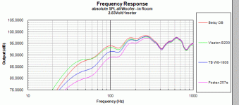

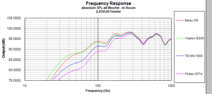

Thanks for the replies! I downloaded xlBaffle and simmed some of the drivers i was interested in. The results were not surprising actually. The drivers are all on a 20 x 48 inch baffle, at the same location on the baffle, the same distance away from the back and side walls. Different positioning and baffle sizes result in better or worse responses but i kept them all the same for this comparison.
Betsy -4db @ 100hz (Qts .78)
Visaton B200 -5db @ 100hz (Qts .75)
TB W8-1808 -6db @ 100hz (Qts .44)
Fostex 207e -8db @ 100hz (Qts .27)
They all can be crossed to a woofer at around 150hz but the Betsy and Visaton can be crossed anywhere from 100hz - 150hz so the higher Qts drivers allow more wiggle room than the low. I still want to play with a few more drivers but have a feeling the findings will be similar.
Thanks so much!
Godzilla

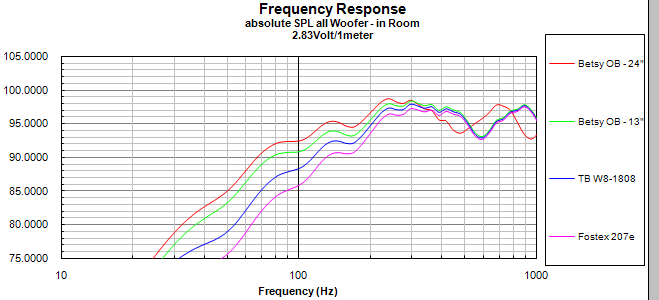

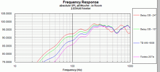

just out of curiosity I have tried 207s in 13''x36'' baffle with single subwoofer actively crossed at about 250hz not perfect but, impressive sound . if memory serves me right MJK mentioned somewhere that any FR drivers can be used on OB with woofer help.
Vadim
Interesting about the 207s on the 13 inch baffle.
Would the high qts of the betsy allow you to use it one a very narrow baffle, on top of an h-frame helper woofer?
For instance if your baffle was 10 to 11 inches wide, would the Betsy still be able to reach the x-over point around 200hz?
