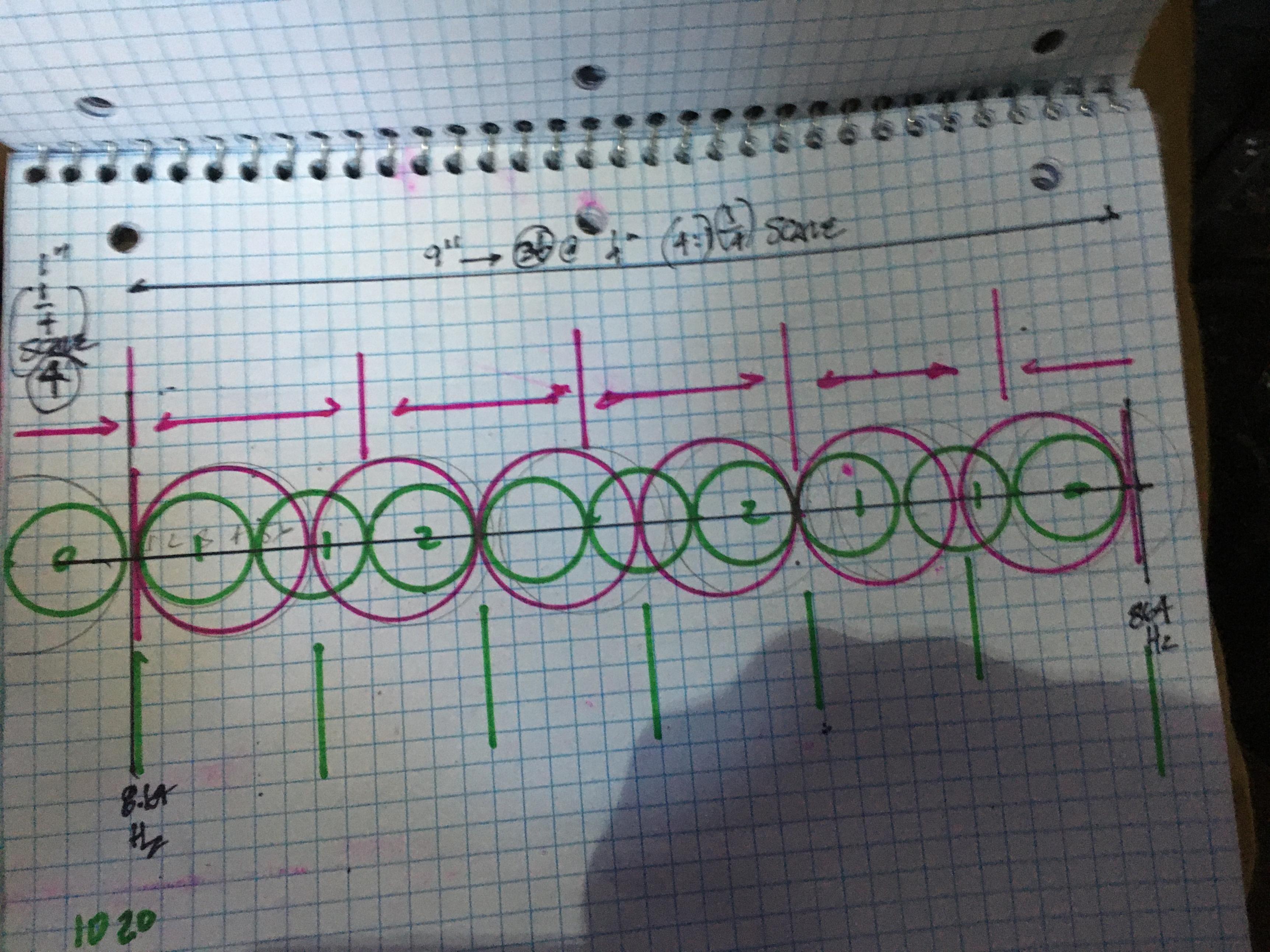

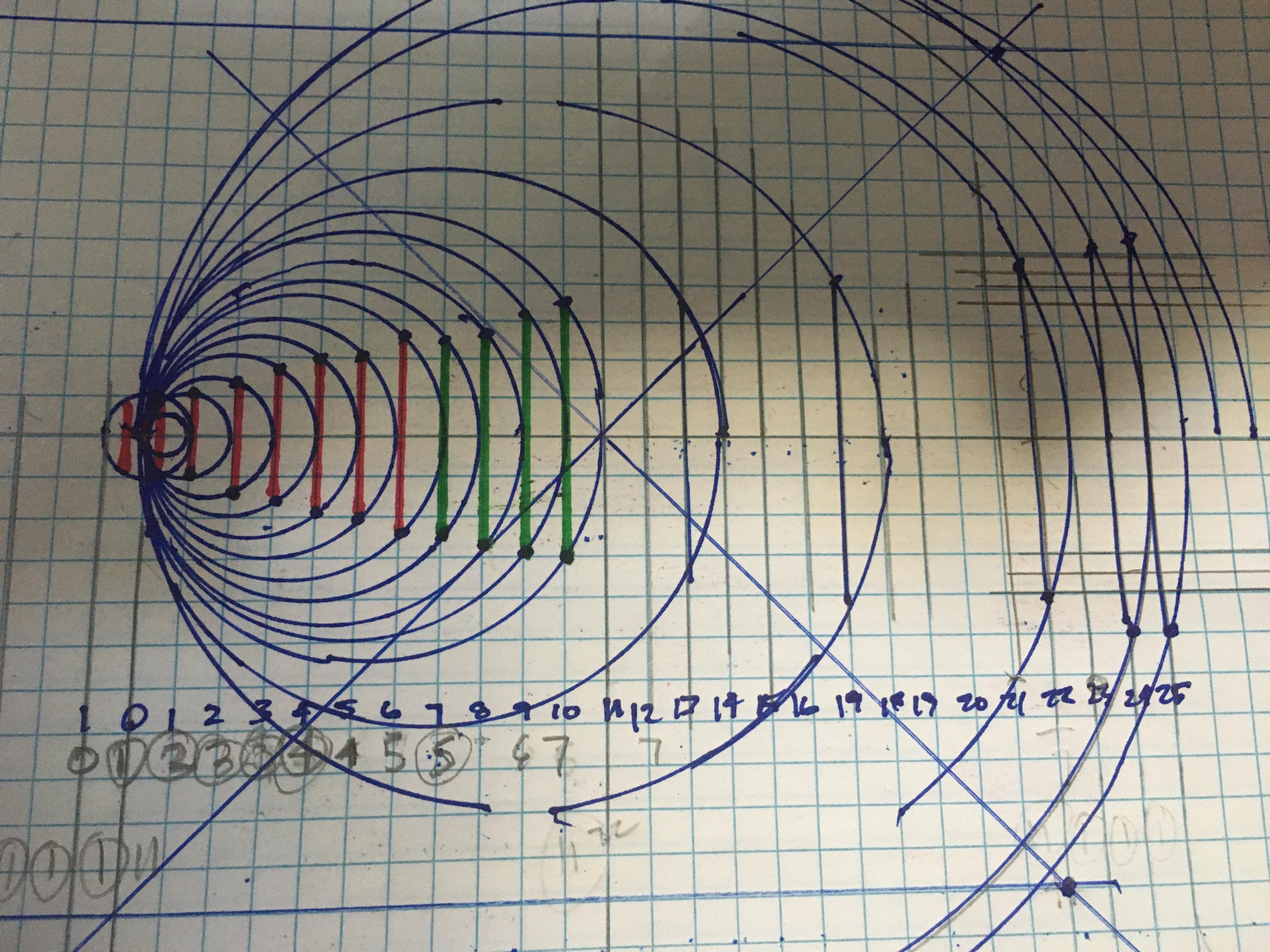

When is the exhaust cam and valves (duration in the 240-270-300 region going to be brought up so an actually relevant piece of a motor(?)??) is fair represented. Or the motor generators that charge dc batteries or run off dc batteries to power electrical loads in a (submarine for example)? phase angle and driver entry Omar nodes? isn’t that more emergency any that xmax and bore/stroke and efficient? All of these are in horn response if represented To it? What’s .349 in a qw pipe vs a .217 or so? And on the far ends this stuff resides as a potential offset exit? Different but related? all of it starts being VERy important and super intersting here (I think?) pic?
More of this? Or Give 12 positions to 360/720? 30/90, 180,360…. Inside 4 hemispheres with 45/135/225/315. .707/1.414… ? This is in a speaker too? It’s lots of ways in 3.14/6.28 3pi,4pi. And start at 0.5236/5.236(pi/ and 10x. (Both ends from 0 and 12(as 1,11 that’s curious if you draw all of this in 1/4:1”‘graph papers and have a metric template of 11,22,33,44….circlesor soheres and a ruler for standard and metric. .)It’s the exact same math as we are used to knowing as ancient 30/60/90 on a sphere. but that’s harder than it sounds? .? it’s all 5.5/7,11/7,22/7,33/7,44/7. at 0,1/4,1/4,3/4,4/4,5/4,7/4, 8/4…. Done/or pressure return ? Or continue as a pattern? But that’s it? Right? Sneak 30 into 90 and rinse and repeat. Bunch of dumb numbers until it’s both sides of the driver and towards the same exit (or phase from )from each that becomes 1/4,3/4 of 4/4? 1.5:1 in 2 circles of infinity
Hopefully making some sense outa this to be fair and helpful. This type of thing and similar in clocked points on the circles from DC.(small extra on left as 180/90/0 from both sides of the x axis at y=0? I suck at math, forgot it all using calculators or spread sheets now like the rest of us? But what happens in the 30 degree spread on the x axis but clocking this to 90degree parts of 4 in a rotation from 360 to 360/450/540/630/720.
