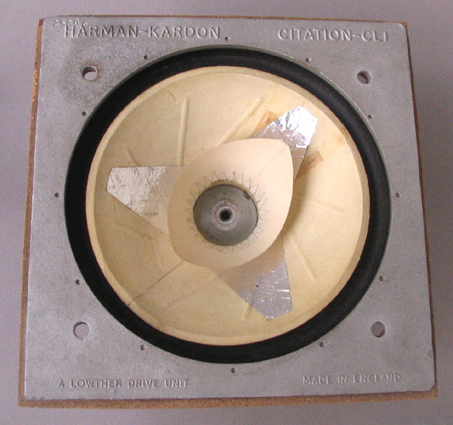

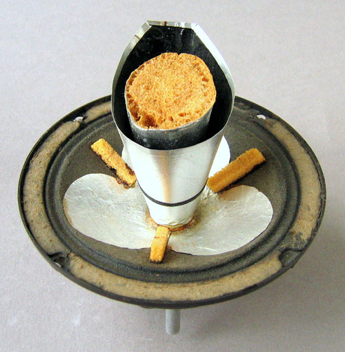

Hi Oliver,
I like your rear mufflers. Something I shall keep in mind.
Hi graaf,
The foam fingers work alright.
In the photo I have the lower finger dispersing some hf at the dustcap. The upper finger additionally improves overall reproduction.
Dual cone drivers might benefit with a pair of separate shallow horizontal fingers modifying the horizontal radiation pattern by reducing off-axis cancellation.
Cheers ........ Graham.

Concerning the foam pieces:
Due to my experience, it is always worthwile to experiment
with Grahams ideas ... 🙂

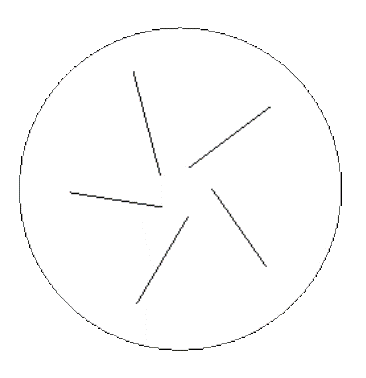

Some manufacturers apply a pattern like the attached one, to
break rotational symmetry.
You can cut slots into the cone and close them with a dampener,
or apply stiffener or dampener without slots to break symmetry.
I experimented with those symmetry breakers too, they can have
balancing effect indeed, but if the center of the cone lacks
stiffness and you have reflections from the outer edge near the
surround, the main problems will not be solved. It is OK to do
rotational symmetry breaking - no question - but in the
modifications i did, the effects of the rigid ring stabiliser were
the most impressive and a damping coat works mostly into the
right direction on a hard paper cone.
The Art of cone tweaking is a matter of the right dose ...
You can combine all those techniques as you like, but if
you end up with a cone twice as heavy than untreated you lost
the game ...

looks like Stewart Hegeman was developing similar ideas of non-uniform asymmetric diaphragm treatment
on the picture Lowther driver according to Hegeman specification
picture taken from: Citation X and Eico HFS-2 Speaker Systems
and one more
also take note of unusual asymmetrical whizzers in both drivers
I have a scan of the original Popular Electronics (?) article on those speakers.
dave
In March/April 1965 D J Oglvie wrote in HiFi News about modifications he made to a Fane (I think) paper cone speaker. Unfortunately I cannot lay my hands on the article at the moment, but from memory he glued to the cone a thin aluminium sheet rather like a two leafed clover, but with a broad centre. He called it a differential wave impedance cone. He used maths and lab tests to justify his design and gave before and after results. Again from memory these showed a slightly extended bass and reduced efficency, (due to weight no doubt) but a noticably smoother FR particularly in the mid-range. The unit was not designed to cover treble.He claimed reduced cone resonances and a more realistic sound due to less cone breakup. I tried a rough copy on a cheap unit and it did seem to be better, but at that time I was working with full range, trying to find a better alternative to whizzers, (which offended my hearing at that time). I think it may be worth following up
"a differential wave impedance" sounds like the idea was to make the soundwave reach the surround and reflect not simultaneously along all radiuses but at slightly different times, am I correct?
this can be achieved also by making uneven soundwave path lengths with cone asymmetry, like in JVC's "oblique cone":

I wondered whether the same effect could be achieved by applying a kind of asymmetrical pattern treatment to a paper cone making the sound wave travel slightly faster/slower along different radiuses?
Hegeman modifications to Lowther and other drivers and Ogilvie's article suggest that the idea is indeed workable
