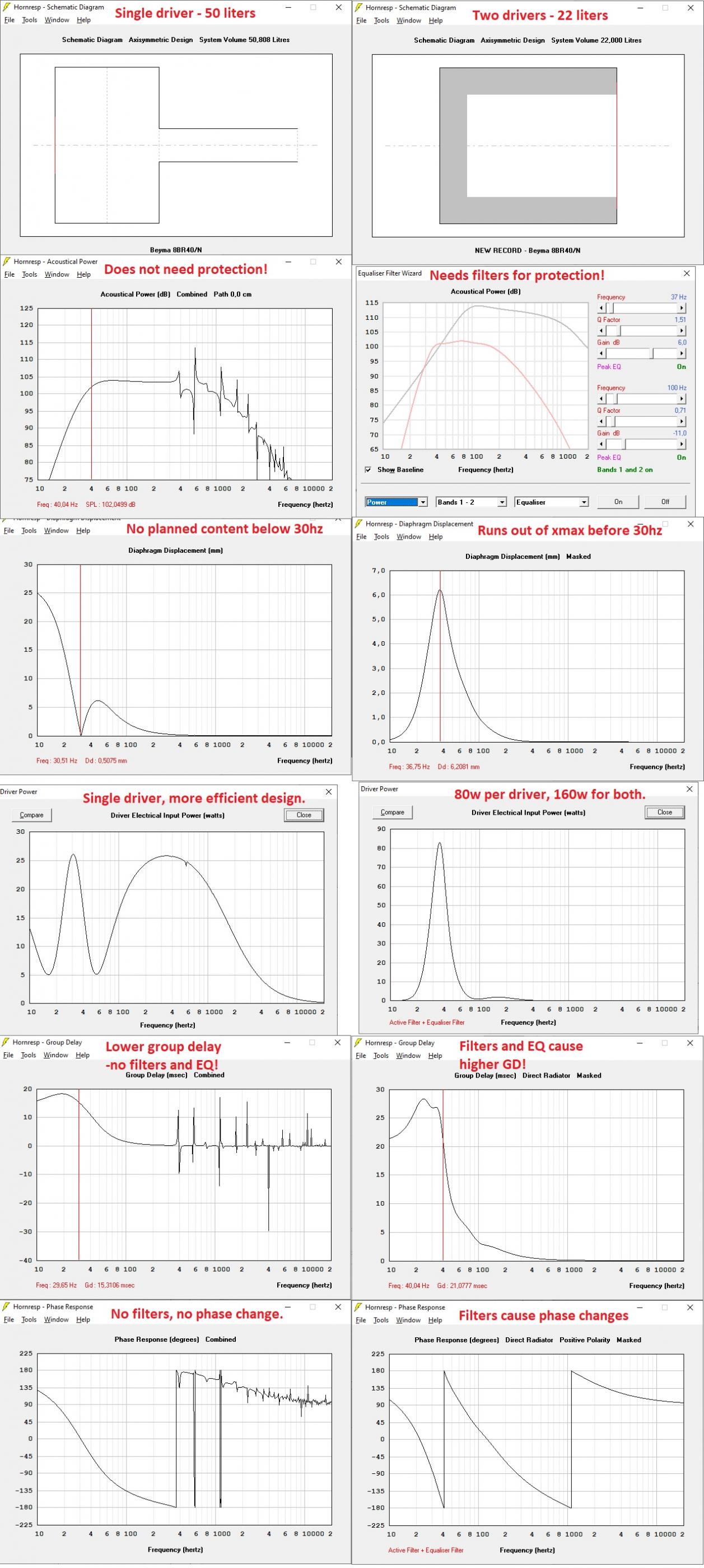

Okay guys.
This is NOT an apples to apples comparison.
In our left corner, we have:
A single Beyma 8BR40/N in an 50 liter vented enclosure.
In the right corner we present:
Two Beyma 8BR40/N in parallel, in a 22 liter sealed volume.

Filters and EQ causing higher group delay can be easily fixed. But you do still need a filter on the vented one 'cause vented boxes do also unload. You don't want to risk it.

Neither are an option for the OP. From what I understand he is looking for a single 8inch driver for a 22 litre cabinet. The sub needs to cover 30 - 80Hz if possible. He will then build of two of them.
