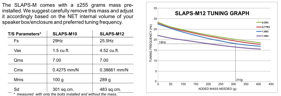

I didn't use the weights. It was too low. I like to hear my music and feel it. Read somewhere without mass it was 30hz.
The SLAPS M12 specification says it's Fs is 25.5Hz with only the bolts installed, without the mass.
Your box looks to be ~1 cubic foot (or more) per woofer and M-12, putting the Fb (box tuning) below 30Hz with no added mass (the "0" vertical line) if the tuning graph is correct.

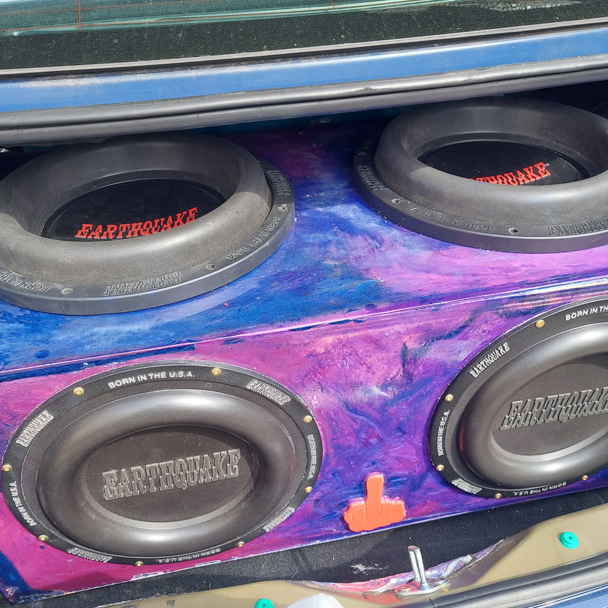

So...Something was off I noticed after a few weeks. The front radiators were the V1s and the bolted ones were V2s and the TS parameters were different. Off...being a little phasing🫠. All V2s now with added ring mounts so they fit right and man....it is absolutely ridiculous the damage this tiny 15 box is doing❤️ These things still on sale on EQ site. Welter you are also spot on. The V2s I last bought had the booklet and they are at 24hz. I never go that low in frequency and can't understand why I never did😎
