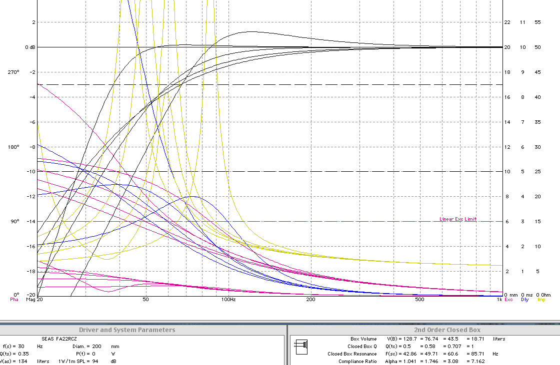

Here’s the SB20 full range, in a 25 liter box, sealed, and 13w power.
Hate to disagree but 13 watts would barely touch 102 dB
and up to full power at 40 watts. Excluding power compression
Barely touch 108 dB. Below 100 Hz close to smacking the magnet.
As posted 45 to 65 watt HiFi drivers are what they are.
pretty much ran numerous drivers. between 91 and 94 dB
GM is usually pretty close if not dead accurate with his numbers.
And the suggested hints are more than realistic.
It's just what HornResp was giving me.
Im not flawless, it's possible I keyed in stuff wrongly into the app.
Much obliged if you could point out my error(s).

I’m kind of confused because I don’t know many of the terms like thermal extension , I’m sorry I’m a noob. I still appreciate your response and opinion on the SB tho
