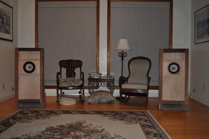

I'm using the driver below in a setup inspired by the Brio Trio. It's only 91.5 sensitive, but it is very nice sounding and very well made and if the graph is true, very accurate above 500hz. Me ears say it is. Incidentally, I'm using the Tang Band W5 below it to get a little bass (down to about 100 sealed) and it's also great.

I appreciate the input I got from a lot of really helpful forum members so I want to take time to let you know where I finished up before I close this thread ...
Hollowboy advised me that Total Recoil, a local speaker repair shop in Melbourne, make wide range drivers. So I went down there there and I finished up buying a pair. See attached pics. They are 8" drivers, with pressed steel frame, whizzer cone, phase plug, and ferrite magnet. I saw a pair in the shop with long wool fibres wrapped around the whizzer (I think that this is called the 99c Lowther mod??) but Boyd of Total Recoil says that this has been superseded by a ring of felt bonded directly to the main cone directly underneath the whizzer. Their is also a ring of felt on the rear side of the main cone, just inside the suspension.
I have built one OB speaker, Other is 50% complete, and swill create a thread in the full range forum to describe my OB project.
