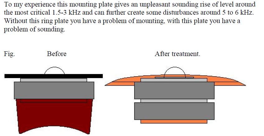

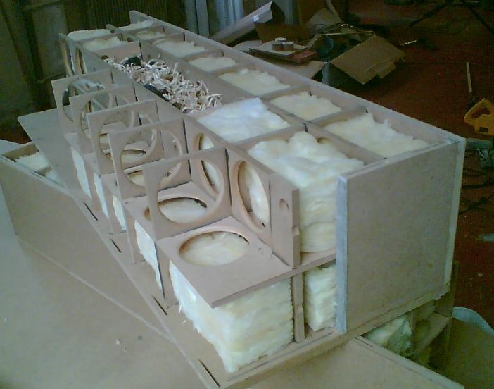

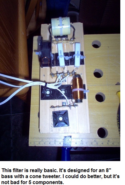

Duelund was a flippin' genius. IMO, the Albert Einstein of Audio. 😀
What is not to like about these ideas below? He did this stuff 30 years ago. 😎

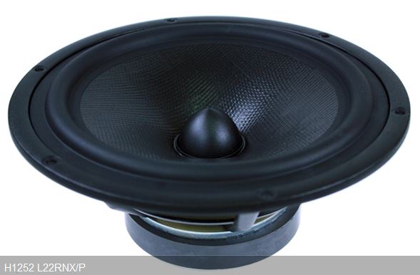

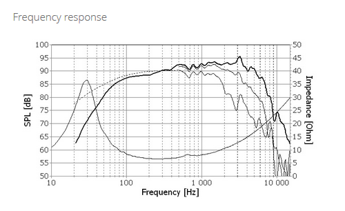

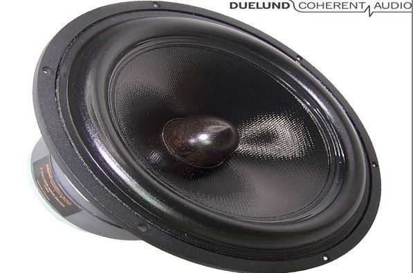

These two drivers seem to be sharing quite a few qualities. Is it worth paying extra bucks, let that decide the end user.
they're not really all that similar. Totally different cones, a completely different spider (or lack thereof in regard to the Duelund) and a different magnet structure. I wouldn't expect their t/s parameters, frequency response nor distortion plots to be similar enough for them to be considered similar in any meaningful way.
