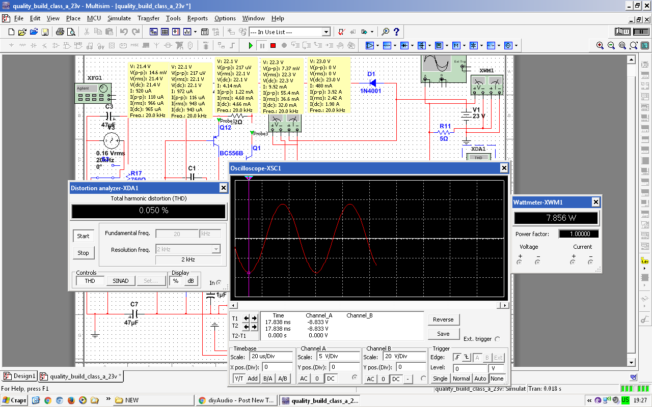

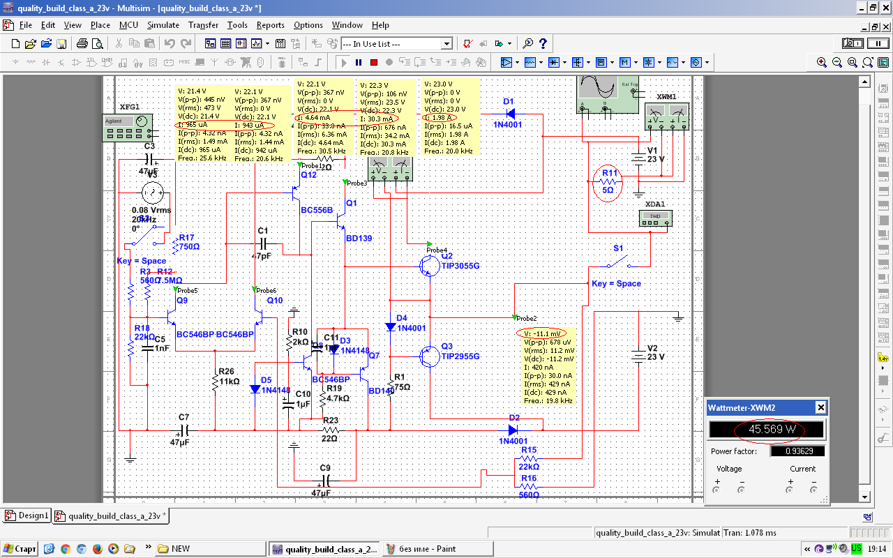

8/16W TIP3055 class A for POWER WASTING

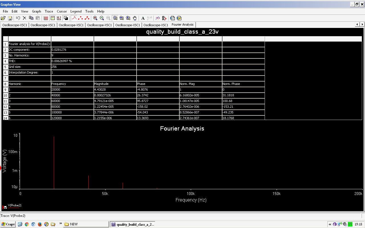

It outputs 0.050% THD @20kHz and full power (+-8.8V output) 8W power (16W peak) -> 12W average.
It outputs 0.010% THD @20khz and 6.6W power.
It outputs 0.006% ..... @20kHz and 1/4 power (...................) 2W power (4W peak) -> 3W average.
need 1-2 more pairs for full +-20v output.
There are two FFTs attached. They are both @20kHz.
P.S. What transistors to use instead TIP3055/2955 ?

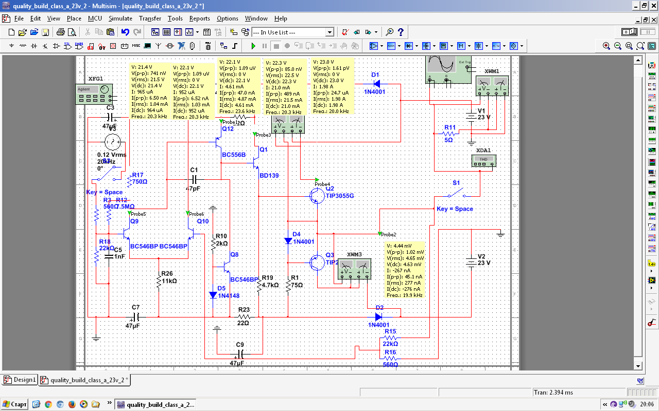

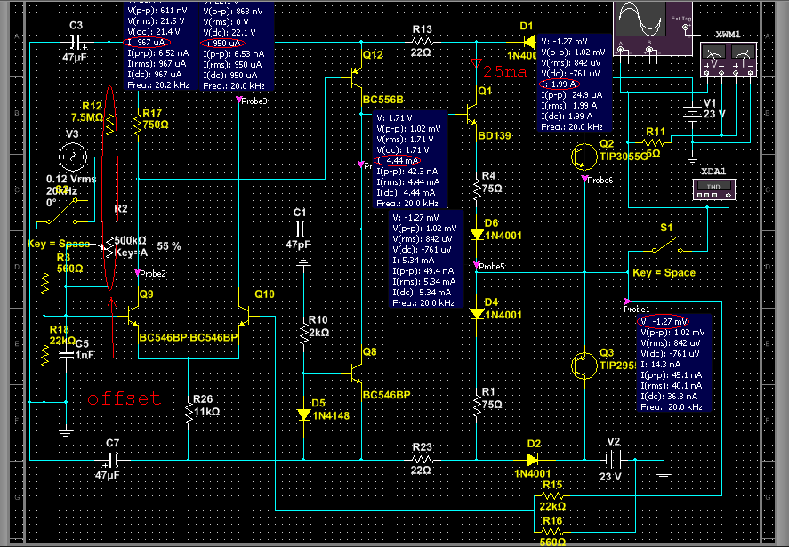

D6 was error and Q1 dont need thermotraking ! If there are D6 it will do the opposite.
LTP does the job for Q1 and Q2, D4 for Q3.

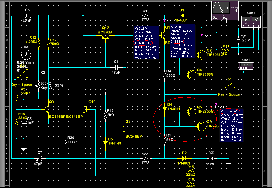

Im attaching a new sch with added another pair of power transistors, removed D6 and output power of 30 Watts.
new specs -> THD @ 30 Watts and 20kHz == 0.014% ,
its perfect for my transformer since it needs 184W, im having 260 😛
i was afraid i will run out of power 😎 cool
But hey this is only one channel 😱 not cool 😀 🙄
Can I use 368W with 260W tranformer ? If I cant I will make it Mono amp with 2 audio inputs and output speakers paralleled.
This is "Monster A"
