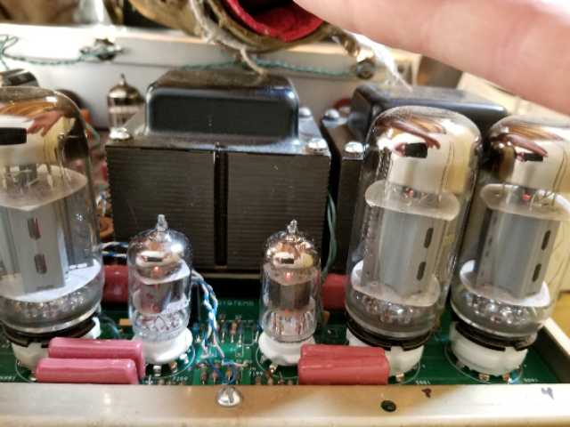

The key draw back I found of many replacements for the 7591 is replacements are taller and will not fit in the available space inside the amplifier.
really narrowed the field of possible replacements.
This was a key reason I looked at the 6n3p-E, it fit in the case!

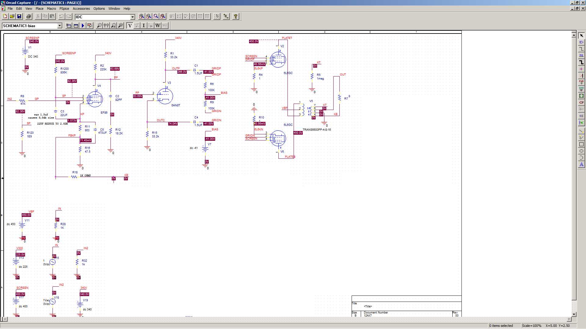

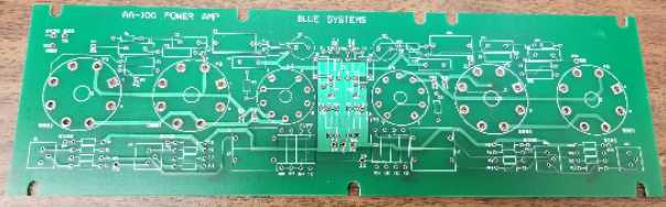

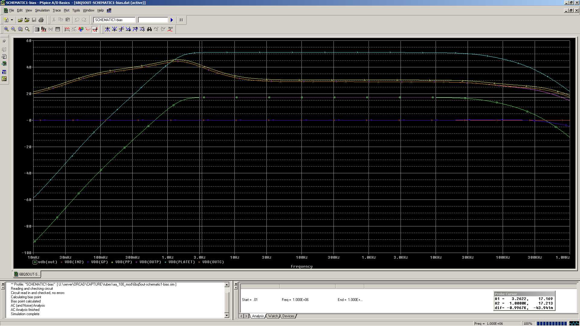

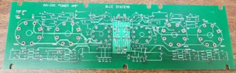

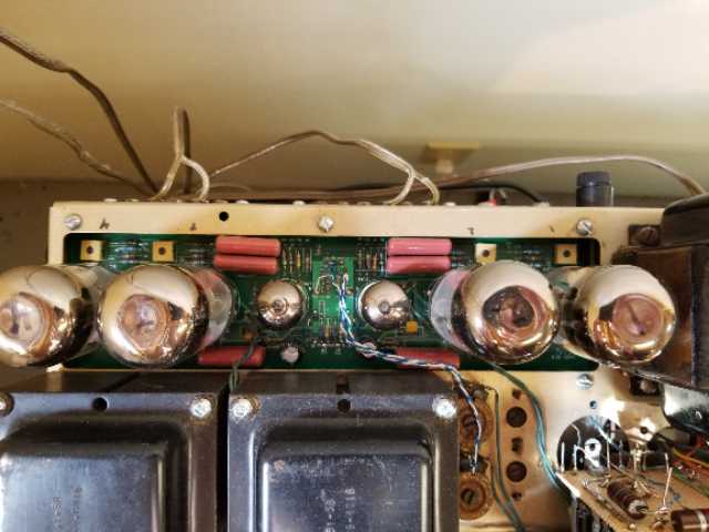

Here is my drive circuit for the 6n3p-E adapted from what was inside the AA-100. This version provides the same power as the 7591 version with THD about the same. Damping factor is much improved over the AA-100 circuit and so is low frequency stability. This circuit is quite stable even with no speaker load attached. Yes it is a lot of drive circuit changes and not applicable to all 7591 amplifiers drive circuits (12AX7 based versions are a different problem) but perhaps better than the option of parting out vintage 7591 amplifiers. I eventually I created a PCB board to replace the AA-100 power board to make the changes easier and to replace burnt AA-100 circuit boards.
