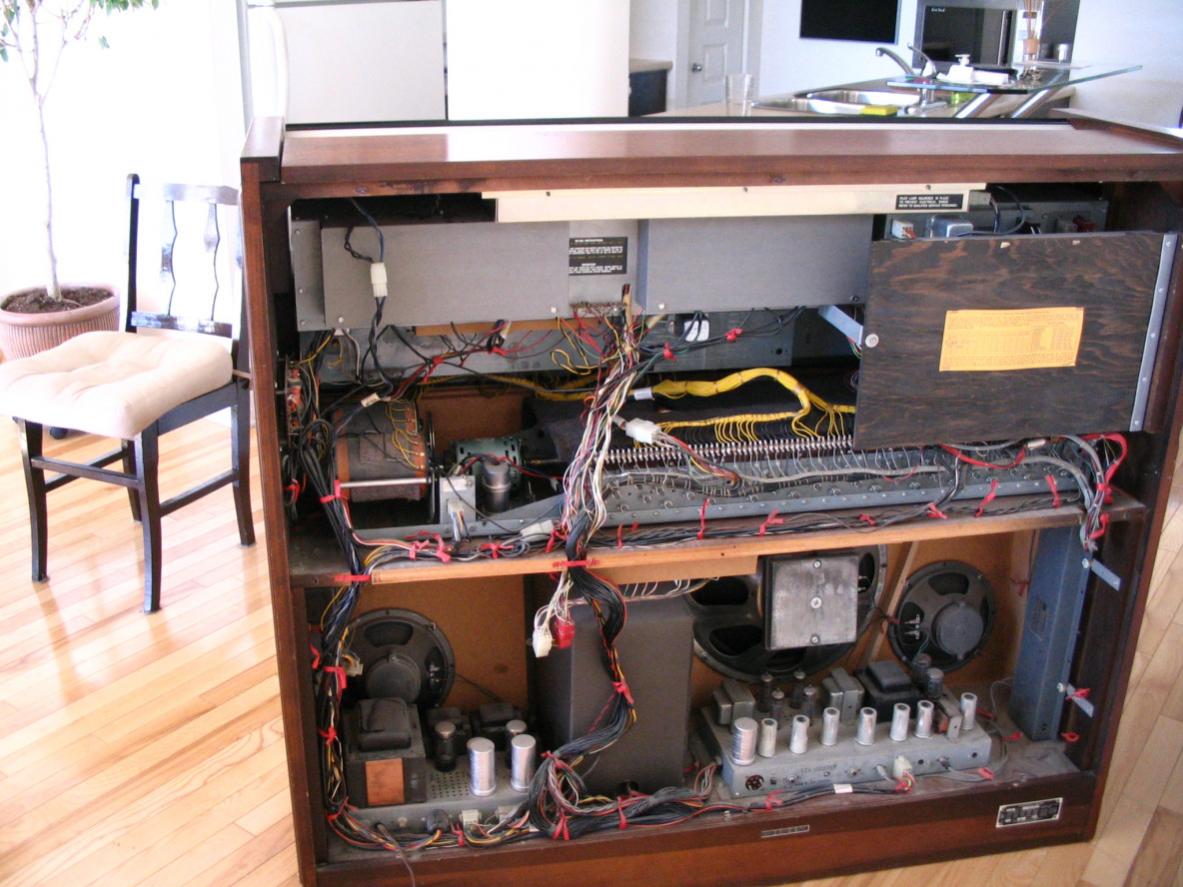

@indianajo: I have the late model with all transistorized preamps. These have been replaced with opamps. The cutoff frequencies on the low pass are well below the lowest note. Nothing wrong there.

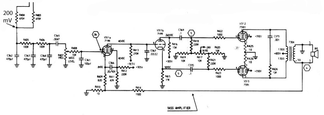

The two bass coupling caps in the amplifier appear to be tantalum and have not been replaced. C369 and C370 in the schematic. If these are much lower in capacity than marked, this would explain poor bass response at the lower end of the spectrum. The lowest frequency on this organ is 32.69 Hz. and it's really weak.
I lost my meter so I'm just going to replace them tomorrow and see what happens. I rolled the bass power tubes with the originals which were working and made no difference. All electros are new. Hammond does not indicate what drawbars are pulled to get maximum power out of the bass section. I do need those lower notes a little louder, however. I can't believe they are so low, by design, at maximum pedal.

It was the coupler caps.
Now the lowest note is loud enough to be useful. The bias divider circuit also serves as the ground reference for these caps and since they were below spec, the roll-off began too early, I presume.

Speaking of the bass, the bias adjustment has a panel mounted-plug on the chassis with three terminals, so readings may be made without flipping the chassis over. I am not sure how to center adjust--at idle or when there is some output?
The only 3 pin connectors I'm aware of on the H100 power amp are the ones going to the speakers.
I think one adjusts the bias on the 7591's to get a symmetric waveform. So one would make a bass note come out with a weight on the keys or something and adjust with scope or by listening.

The center pin is ground, the other two go to pin 5 of each 7591. It is located on the right side looking from the back of the unit, near the spring reverb unit.
I would not adjust it by listening, while it may sound good, if there is offset, it would magnetize the iron in the OT over time. I did center waveform on scope since it seemed like the best way, since it would eliminate tolerances in the resistors and tube mismatch. I set the scope for DC remove because the only place DC can come from is the test equipment.

Pin 5 of the 7591 is the cathode, so in push pull circuits you generally try to equalize the cathode currents of the two sides. Based on my dynaco ST70 experience, they were shooting for 10 ma at idle for 6CA7, which is a slightly higher power tube than 7591. With one adjustment for both tubes, all you can do is equalize them, which stops DC current flow through the transformer. at idle anyway.
I asked about this adjustment before, but I forgot about it. The schematic says it's a bias adjustment but DF96 says it's for balance to eliminate DC, which is where the 5 pin is connected to the 10 ohm resistor, which continues on the outside connector--one for each tube. I don't know too much about output tubes but as I understand it, the -24V being present means they are self-biasing, as most use the term.
