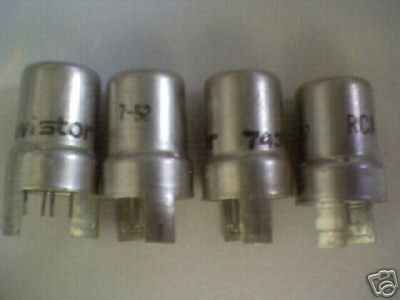

does anyone have the lead identification for the above valve,I have electrical data but no lead id. any help would be appreciated,thanks.

I have a pair of those... equivalent to the classic 6CW4 IIRC. So yeah... use wherever a 6CW4 might be used...
Might well be better sold to the vintage radio crowd, IIRC they aren't that cheap these days. A 12AU7 is cheaper, more linear (IIRC) and easier to find sockets for. 😉

thanks for the replies, soon after I had posted i found an rca datasheet at this address:
http://www.pmillett.addr.com/tubedata/HB-3/masterindex.html
the lead id makes more sense now🙂
Not quite, same pinout but 7586 has mu=35 and Cgp=2.2p, 6CW4 has mu = 65-70 and Cgp=0.9p. 7586 is actually similar to 1/2 6DJ8, 6CW4 is more like 6HA5 or other frame grid triodes. I've been able to sub 6CW4 for 7586 in CFs in HP3400 RMS meters, but you probably couldn't use a 7586 in an RF circuit designed for 6CW4 or for a plate loaded amplifier with gain of 40.
BTW, be careful about microphonics especially in the 5 - 15kHz range, you'll need some mechanical isolation.

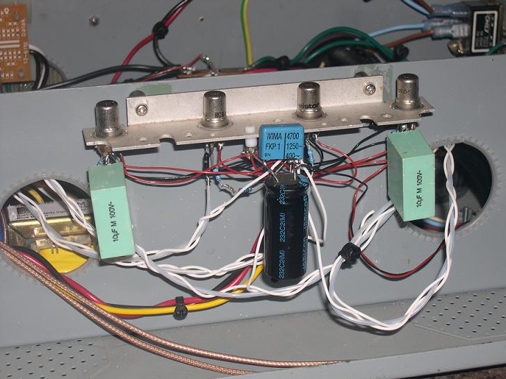

found 4 nuvistors & bases on ebay,in the process of building this design.http://www.tnt-audio.com/clinica/preamble_n.html any opinions?
The valve bases were mounted on a bracket, so the pre amp stage connections are all point to point. I used precision resistors in the signal path, roederstein/vishay coupling caps,silver wiring & a "blue" alps pot. At the moment i only have one input wired with rg178 coax (single braid shield,silver plated copper) I will be trying different cables for each input connection (rg400 coax,pure silver wire) Of course the use of the exotic parts is not for everyone & worthy of debate,
to my ears it sounds good-very good in fact, clean with good sound stage & imagery. I didn't know what to expect while building it because I had just been using the variable output of my cd player into my power amp, but i'm impressed.

Does'nt that Pre-Amble amp call for the 6CW4?
As someone earlier said, the 7586 has a Mu of 35, while the CW4, has a Mu of 70.
Did you find any problems subbing the 7586 for the CW4 in this scheme?

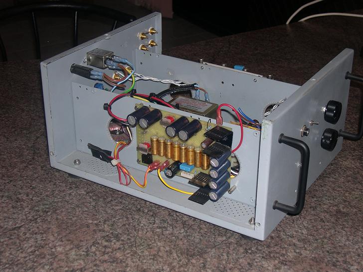

the preamp designer had tried 6cw4's in place and said there was a minor rise in distortion. midway through construction my work moved to a new premises and while destroying & throwing away unserviceable units i found 4 sylvania NOS 6cw4's, they were for use in an old DME unit. haven't tried them yet but will soon.last photo, the regulator board-a bit rough but it works well.
Wow! Post #13
yeah the box is overkill-but it was free! it was an old hf radio psu with a dead transformer so i gutted it and painted it a "car primer" grey (better than the rusty faded green) I liked the fact it has internal "walls" to provide some degree of shielding.
