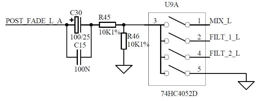

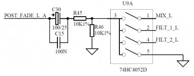

I'm designing a dj mixer and came across a problem with audio signals switching.
Above is a part of a well known mixer that is using thoses 74hc4052. The signal comes straight from the output of a TL072 and goes to another op amp on every switch output. My concern is that the datasheet specify an input voltage from gnd to Vcc. So how does this ic can be used for audio signals since they are AC?
I'm sure i'm missing something, sorry if my english's bad and thanks in advance.

In any case, a 74HC4052 can handle negative voltages when there is a negative supply connected to pin 7, VEE. With pin 16 (VDD) at +5 V and VEE at -5 V, it can handle anything between +5 V and -5 V, see https://assets.nexperia.com/documents/data-sheet/74HC_HCT4052.pdf
I usually use a pair of Zener diodes biased at relatively small currents as power supply for analogue multiplexer ICs, to reduce the risk of anything weird happening when the input signal exceeds VDD or goes below VEE. In particular, the built-in ESD protection diodes will then effectively clamp excessive input signals and the risk of latch-up will be very small.

...datasheet specify an input voltage from gnd to Vcc. So how does this ic can be used for audio signals since they are AC?...
Are you unclear how AC can be mixed with DC? This is fundamental to most audio.

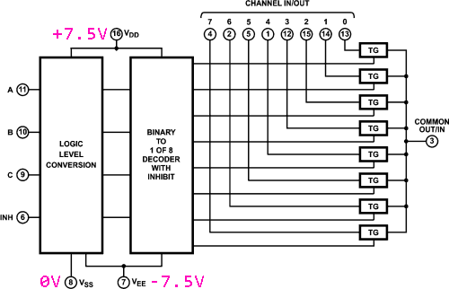

The '4052 data does not say "gnd to Vcc". The analog pins may be swing from Vee to Vdd. There is also a Vss which is reference for the digital control.
As Marcel says: For much audio work, the "obvious" biasing is Vdd at +7V, Vee at -7V. It can accept 7V either side of zero, or 14V peak to peak. A pretty good signal.
This mixer probably runs on +/-15V rails. The plan you link has a 2:1 voltage divider, so the signal at the '4052 is only half the opamp, or about 7V each side of zero.
