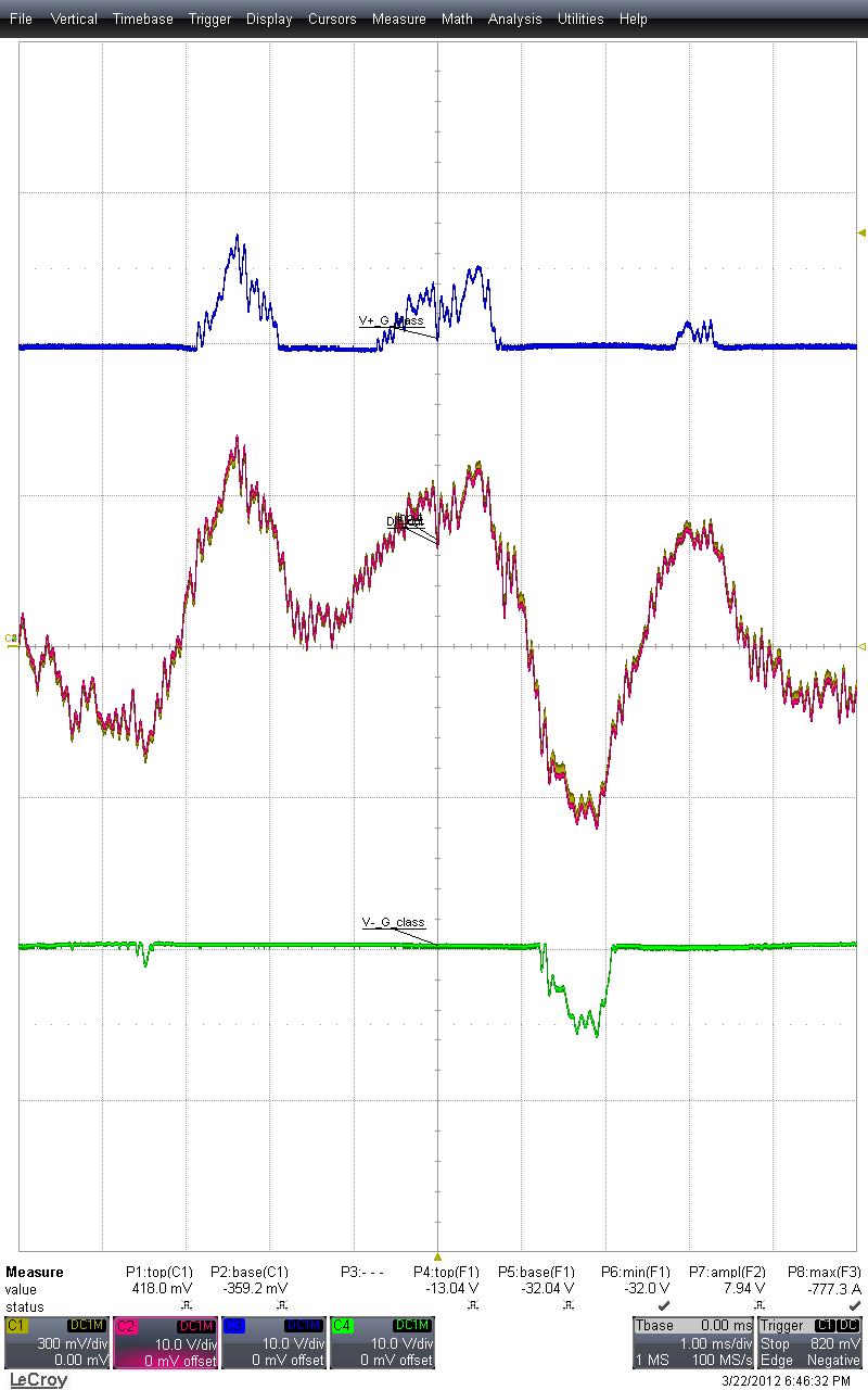

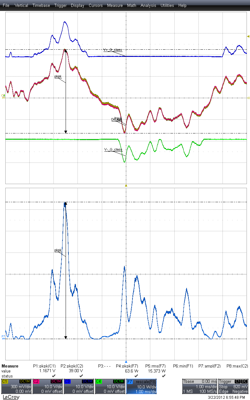

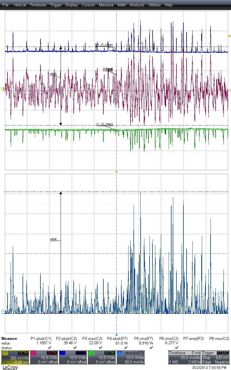

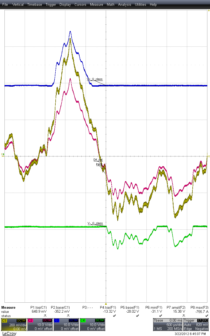

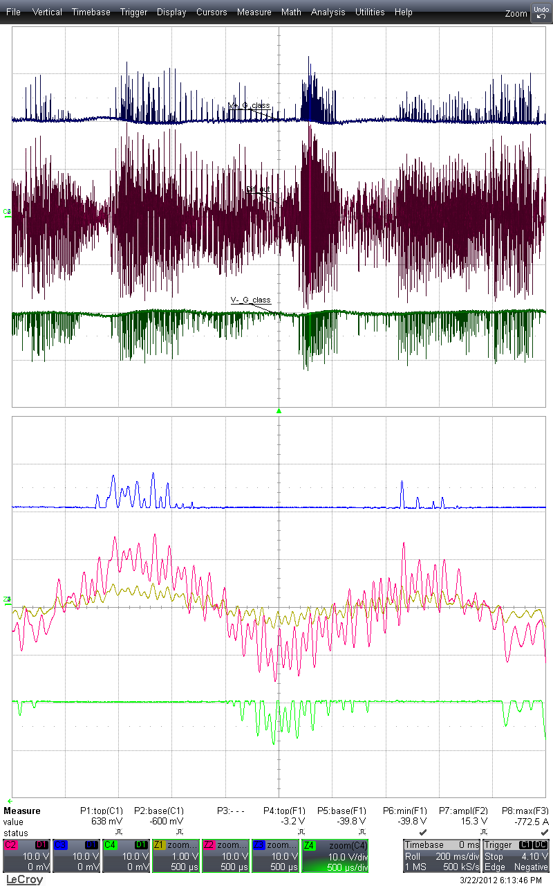

Class G on music
Some oscilloplots of class G with music on inputs.
The source was a out of onboard sound using high quality audio CD on cd-rom.
In some pictures the output power (on 8Ω resistiv) are ploted, both Pk-Pk and RMS power.
The high ration between RMS and PK-Pk can be seen for music
