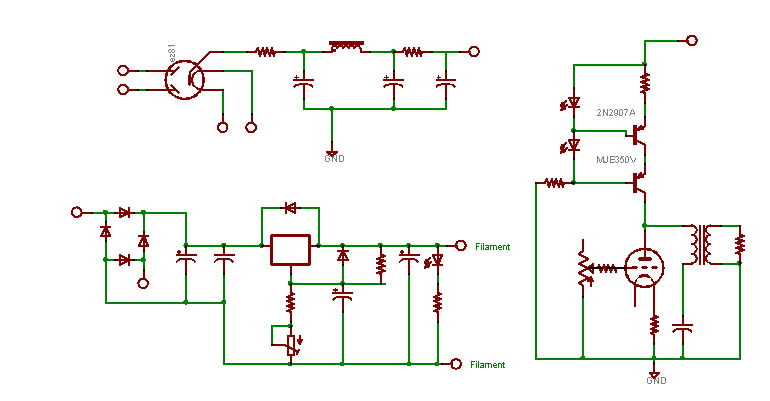

Some experimentation has commenced. I picked up a pair of 01-a's and some magnequest B7 parafeed transformers. On a breadboard I loaded the plates of the tubes with a ccs at about 3.5mA, used a lm317 circuit on the filaments, and the noise and microphonics are really bad. A truck drove by on the street and the tubes picked up the vibration + the amount of background hum and noise is really high. The PS is in a separate chassis and is about 2 feet from the circuit, so I guess the place to start is with the filament supply and making the wiring neater -- it is just a bunch of clip leads right now. I also tried w/o grid stoppers, so maybe I'll add those to see if they help. I am not sure I have good feelings about this pair of tubes though.

Do you have a cathode bypass cap? That's one place to start - my SE stage sounded horrendous without it.

Eusebius said:Do you have a cathode bypass cap? That's one place to start - my SE stage sounded horrendous without it.
I've attached the basic schematic I am using.
There are a bunch of things that clearly can be improved -- the 6.3V winding feeds both the ez81 and the lm317 based vreg which should be changed, I probably need some work on the cathodes of the tubes, the filament PS could be better, etc. Also, this is on breadboard and is connected with lots of clip leads. But, the question is whether these things will fix things, or whether I just have a noisy pair of tubes. I built the same circuit with 6n6p's where it worked great. Obviously there is an extra layer of work with the DHTs, but I am a little weary of plunging in too deeply. Anyone have a good way to determine if a particular tube is just inherantly noisy?
Eusebius said:If you're having a lot of trouble I really do recommend differential pairs of DHTs as a way of dealing with microphonics - it's not something you'd normally consider unless you have a balanced system (like me) but it works.
The addition of grid stoppers did seem to help with microphonics a bit. One weird thing is that while there is a constant noise (60Hz, 120Hz?) there is an extra noise at about 1 second intervals that sort of sounds like a space age pinging with delay and reverb. It is very odd.
Anyhow, suggestions greatly appreciated.

A few updates.
I swapped out the 5V linear filament supply for a switcher i had around (the one that came with my Squeezebox.) I have no idea the qualty of this PS, though I assume it is low. However, I assumed that since it is a switcher that all the noise would be HF noise and would at least be different and would show where the problems were coming from. Counter intuitively (to me anyway) the noise went way up with the switcher. I would guess that it is 120Hz noise, though I have no easy way to measure that.
The other thing that was surprising is that turning off the PS but leaving the filament supply on -- essentially letting it run from the cap bank until they discharged, all noise went away and it played pretty clear music. However, as it was about to run out of power, the noise crept back in.
I don't know what these two things mean, but I am hoping that someone else does and that they offer a clue of where to start.

Sounds like your plate supply is noisy (lots of ripple?) or the power transformer is close enough to the tubes to cause problems. 01A are very sensitive to both magnetic and electrostatic pickup.
You should definitely add a cap to bypass the cathode bias resistor. Note that the nominal plate resistance of 8 - 9K may be triple this amount if the cathode resistor is unbypassed depending on the value of that resistor.
I usually use a pair of small resistors (22 ohms typically) in series across the filaments and connect the bias resistor and cap to the center node. I have found that this can help a lot with noise on the filament supply - it may or may not help here. (It's just about mandatory if ac is used for heating, using ac is obviously not something you should do in a dht pre-amp.)
I actually prefer fixed bias via batteries applied to the grid, I use something like a 220K grid resistor and a 9V battery - works really well.
I have also tried nicads in the cathode circuit, they are ok, note that nimhs seem to sound really lousy. (Interestingly higher internal impedance than good nicads) Normal operation will keep them charged but they do need to be replaced every few years.

kevinkr said:Sounds like your plate supply is noisy (lots of ripple?) or the power transformer is close enough to the tubes to cause problems. 01A are very sensitive to both magnetic and electrostatic pickup.
This is what is weird. the PS is about 2 feet away in a separate chassis, and the supply is reasonably clean, and the CCS should clean it further.

kevinkr said:You should definitely add a cap to bypass the cathode bias resistor. Note that the nominal plate resistance of 8 - 9K may be triple this amount if the cathode resistor is unbypassed depending on the value of that resistor.
I'll try that tonight. I was really hoping to keep the electrolytics out of this thing, but I'll see. I'll also try adding a pair of 20R resistors on the cathodes. Would the higher plate resistance lead to more noise here?

I was really hoping to keep the electrolytics out of this thing>>
Sure - I use 47uF polypropylenes for cathode bypass.
